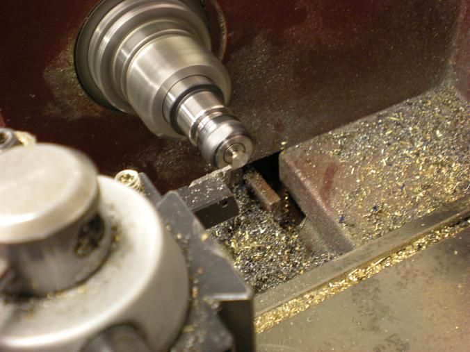

« Reply #113 on: November 01, 2010, 06:51:36 PM »
Hello all!
All 40 of the valve blanks are completed. They take forever but it will someday be worth it.
To cut the slots I used my ER11 collets. I was able to put the valves in backward and slot the stem for the E-clips. I have an insert holder and a .020 slotting tool. Makes it easy to have a nice sharp tool because I stink at grinding tool bits.
Then I made a few test pieces. I chose not to reduce the size of the stem at the head so I could hold the valve real close for rigidity. I took a light cut accross the face. I want the valves flush in the head and the hole for the valve cage is .250 so I reduced the OD of the valve down to .245.
Then I cut the valve angle into the back surface.
So now you all know what I'll be doing tomorrow!!
