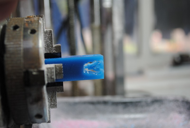

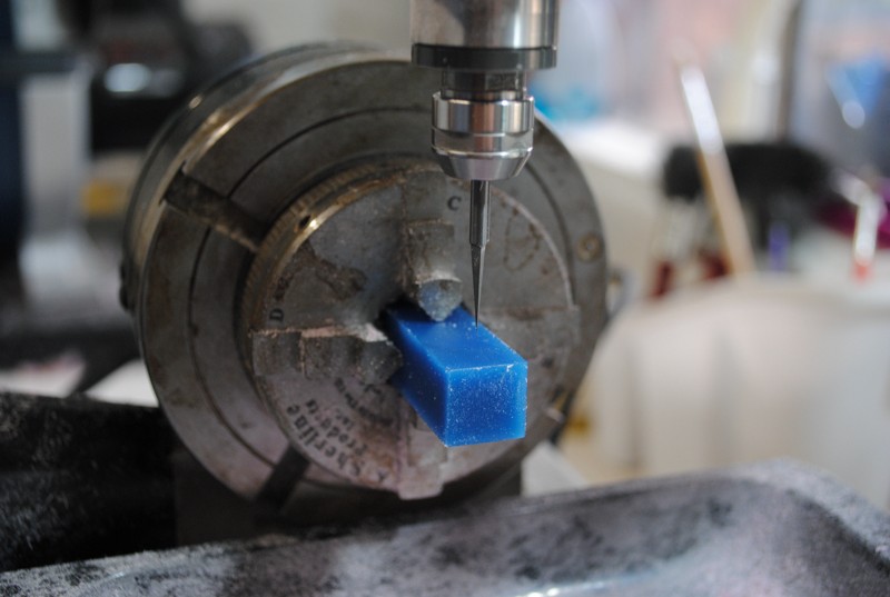

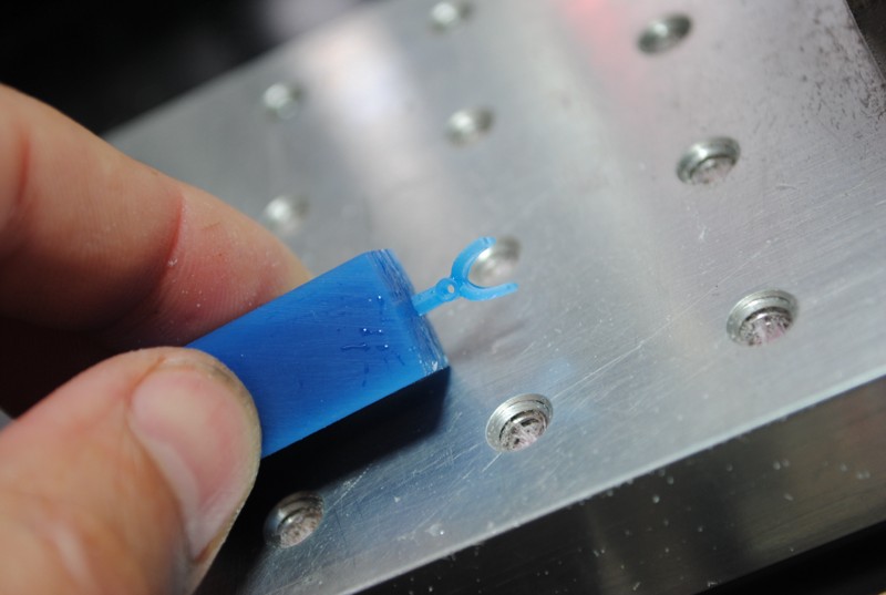

« Reply #254 on: May 02, 2010, 09:19:54 PM »
here are some pics from the next rhinocam video im on, simple flip works and 4 sided multi index.
« Reply #255 on: May 11, 2010, 02:45:02 AM »
a few more, :)
