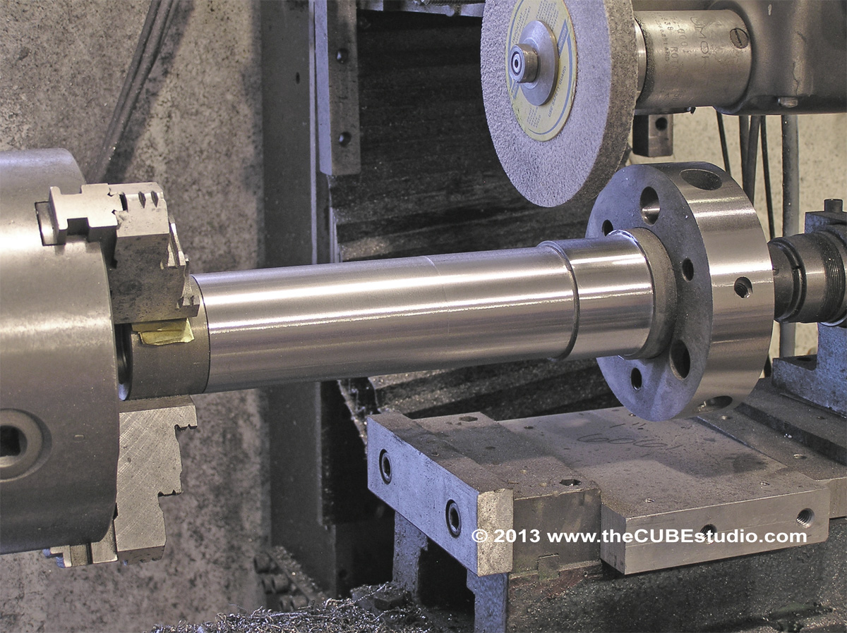

I have a precision option for the InTurn™ 4th axis now and my next mill spindle will have precision bearigns as well, so I have been spent a lot of time studying spindle designs, perusing white papers on vibration analysis and reading the precision bearing specs and handling proceedures as published by SKF, NTN, TIMKEN, and so on. Typically they say 'In the event you have to remove a bearing, it is best to replace it'.  ???  $300 - $400 bearing . . . times 2 . . .   JUST replace it?   Yikes!  :o
Oh yes . .  and . . . the replacement bearings are slightly smaller than the OEM, so the spindle will need to be 'reground to achieve the correct fit.'  Gee, suddenly the bearing cost seems almost trivial. . . :'(
How's this for a tollerance (EOM bearing supplier for Excello) Quote:  '  .0001" tight to .0001" loose '      . . . .  bizzarre.  Staying within two tenths is doable for me . . barely . .  but it takes a lot of time because I have to 'sneak up on it' as my machinist buddies used to say. Here is my special one-off hardened A series tool steel spindle. It is currently cut for a standard press fit to a ABEC3 deep grove ball, so there is meat on there to re-cut it for precision bearings. I just need to grab a couple while I'm out getting bread and milk . . . . .
