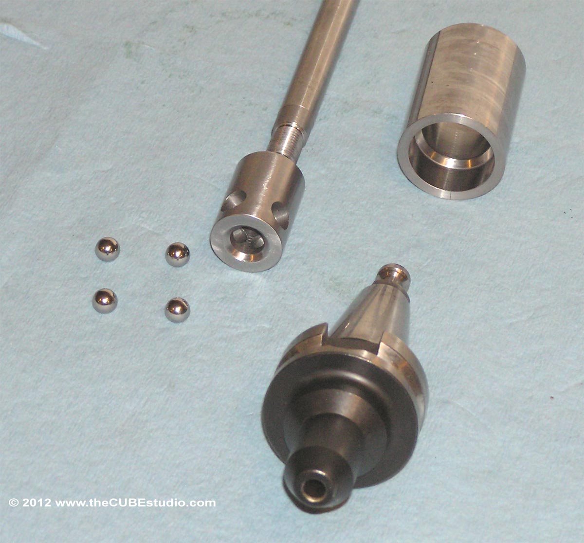

I have had the pneumatic cylinder and some other stuff for quite a while from when I was contemplating doing an R8 power draw bar. I abandoned that idea after a lot of research. I recently found a source for the 'fingers' that go on an ATC and hold the BT30 adapters.

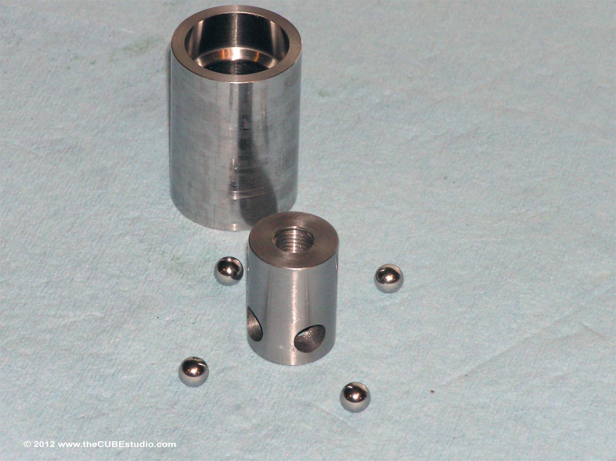

A stumbling block was the $500 stud gripper for the BT30. There are two types of gripper that I know of; finger type and ball type. Either needs to be hardened and properly tempered to perform safely. I know how to do that, but I no longer had a furnace (sold with the prototyping shop many moons ago). So I have aquirde a furnace. I still have to install the new automated controls, but the 50A 220V wiring is completed.

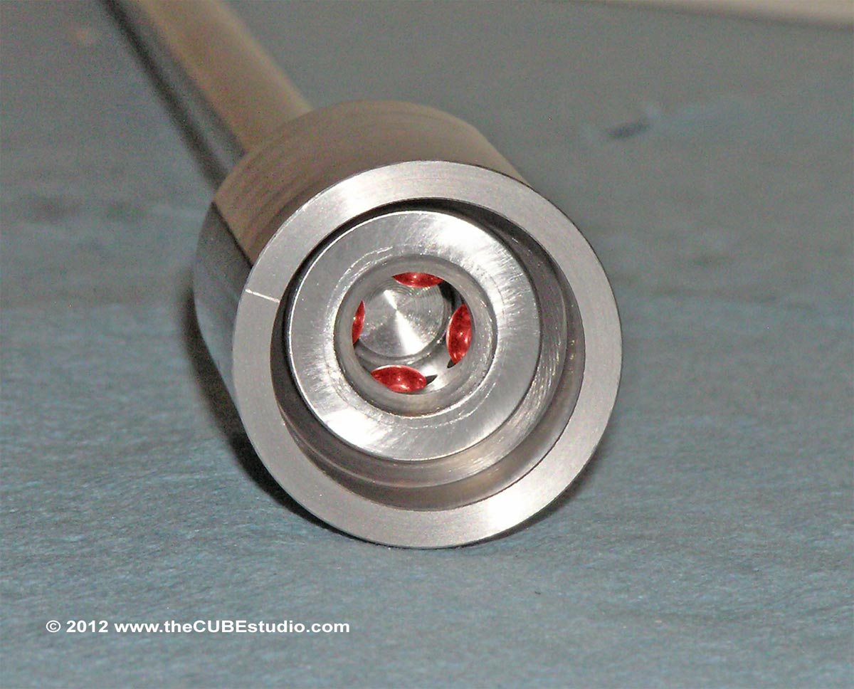

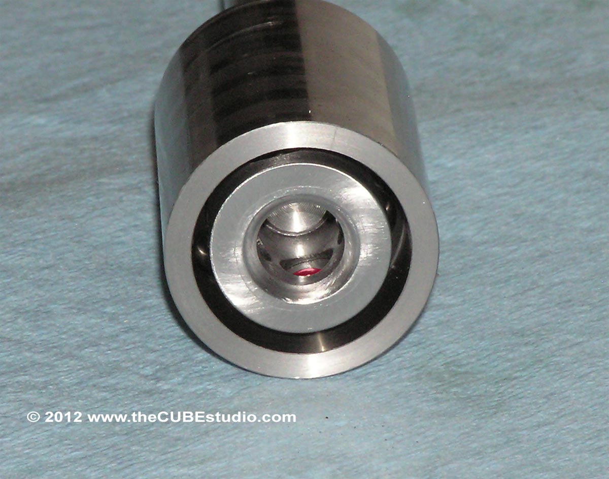

Meanwhile, I havecompleted the first amd most essential component, the above mentioned stud gripper. I went with the ball type. It works perfectly so all I need to do is turn doen the sleeve and harden the components. I have successfully completed my first scratch built spindle for my 4th axis, so I will use the same techniwues and new tools to make the mill spindle. Compared to making the stud gripper, everything alse should be fairly simple.
The center piece (hold the balls) is S7 tool steel while the 'sleeve' is A2. The sleeve OD is 'mill finish' as it has not been machined yet.
THe next two photos show the gripped in open and closed positions. I have colored the bals red becuase otherwise it was very difficult to see what was actually happening. This was the first round prototype and it works perfectly  8)  so these actual parts will be hardened and used in the spindle.

This will probably be the last post for a while on the BT30 spindle because I have other work to complete before I can re-focus on this project. The gripper is a central character in this play so really making and testing the gripper mechanism could be considered part of the feasibility study. Put in simple terms; no gripper - no spindle.  So I wanted to accomplish a working gripper before I dedicate the time and resources to a spindle/drawbar project.
Below are photos of the completed gripper parts. After heat treating the sleeve was tempered only slightly for max hardness. The ball holder was tempered to a typical 'cold work' spec for S7 After heat treat, the parts were pickled and blasted to remove scale.  Small S7 parts and A2 parts are air quenched and typically there is only minor distortion. The ball holder was fine and the threads still worked perfectly, so it just got a black oxide treatment and was completed
The sleeve, as expected, had minor distortion. The ID does not have to be perfectly concentric and the ball holder still slid nicely in the sleeve, so the ID was simply re polished for smooth action and low wear on the balls. However, again as expected, the OD had to be ground to bring it to size and concentricity for pressing into the spindle nose.
My research turned up a figure of around 600lbs drawbar tension for BT30, so I will design the mechanism for 600 lb pull and 1000lb release on 100psi shop air. The cylinder is rated to 200psi, so there will be plenty of headroom. I will test the gripper at 2,500lb pull so that in case I have to go up to 1,000 pull on the holding force, I will still have a 2.5x test.
