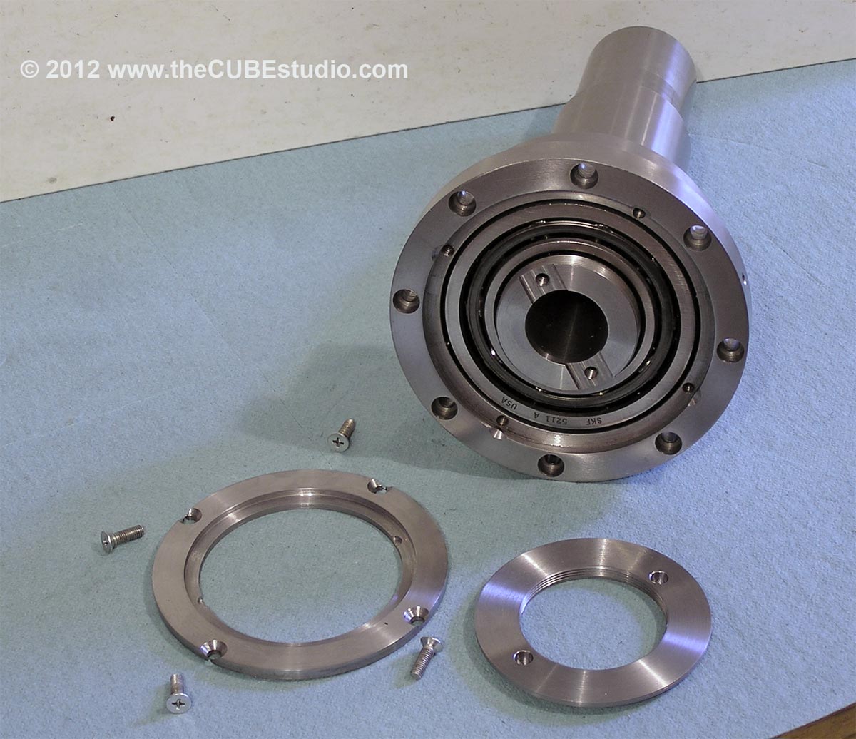

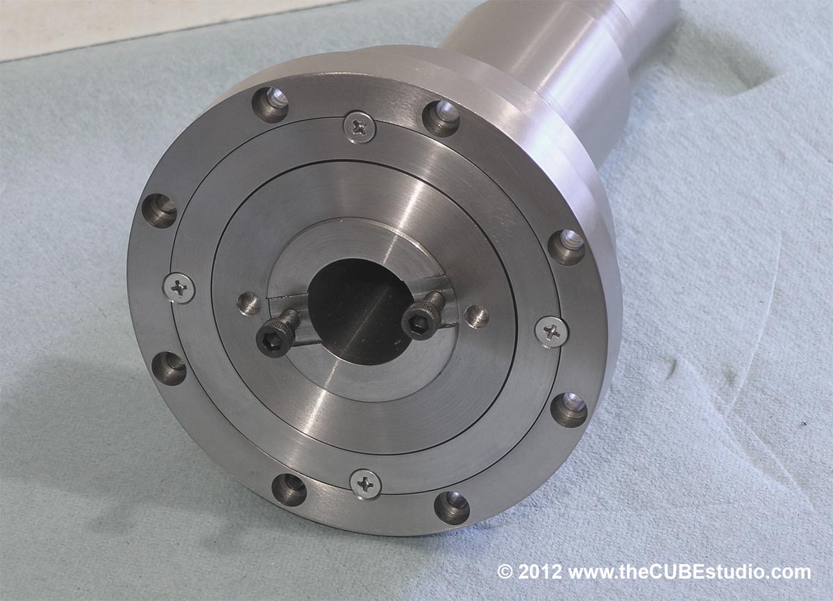

OK, two more pics and we're done. Here are the bearing retainer parts and the assembled spindle nose. All that is left are a couple of drive dogs. Anybody know if the dogs are hardened on a typical BT30 spindle?
I will need drive pulleys and a disc brake rotor for the top of the spindle, but I am note sure what arrangement I want  for those yet, so I suppose the power draw bar is up next.

It's a thing of beauty!  A few things I'm not clear on:
Are the 4 Philips screws what retains the lower bearing?
What are the two "dimples" on the inner perimeter of the (assumed) bearing retainer?

Yes, the screws, in part, retain the bearing. The screws shown are temporary until I grab some socket flat heads in that size. You know how it goes, I have ever size above and below . . .
I say 'in part' because there is also a press fit as well as being 'glued' in with Loctite bearing retainer.
Edit: oh yes, I almost forgot: mechanically there were also already pins thru the housing below the bearing.
However, taken alone, and using only rough numbers because we are not even close to the wall, the bearing is rated around 10k and 4 of the proper fasteners will resist about 9.5k, so even without the press fit, glue, or preload on the top bearing, the lower bearing would be toast by the time the screws popped.
What hump?
kidding . . . those are just the remnants of the spanner pin holes. What is now the 'retainer' used to be the full plate with the labyrinth seal at the edge, so it had spanner pin holes for 'wrenching'. A new smaller plate takes its place, this time with the seal between the outer and inner disks.
