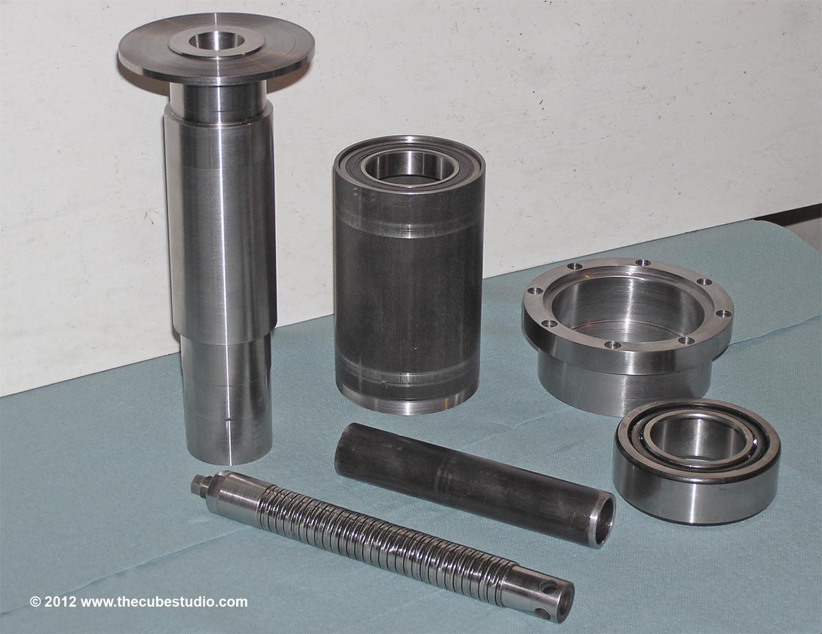

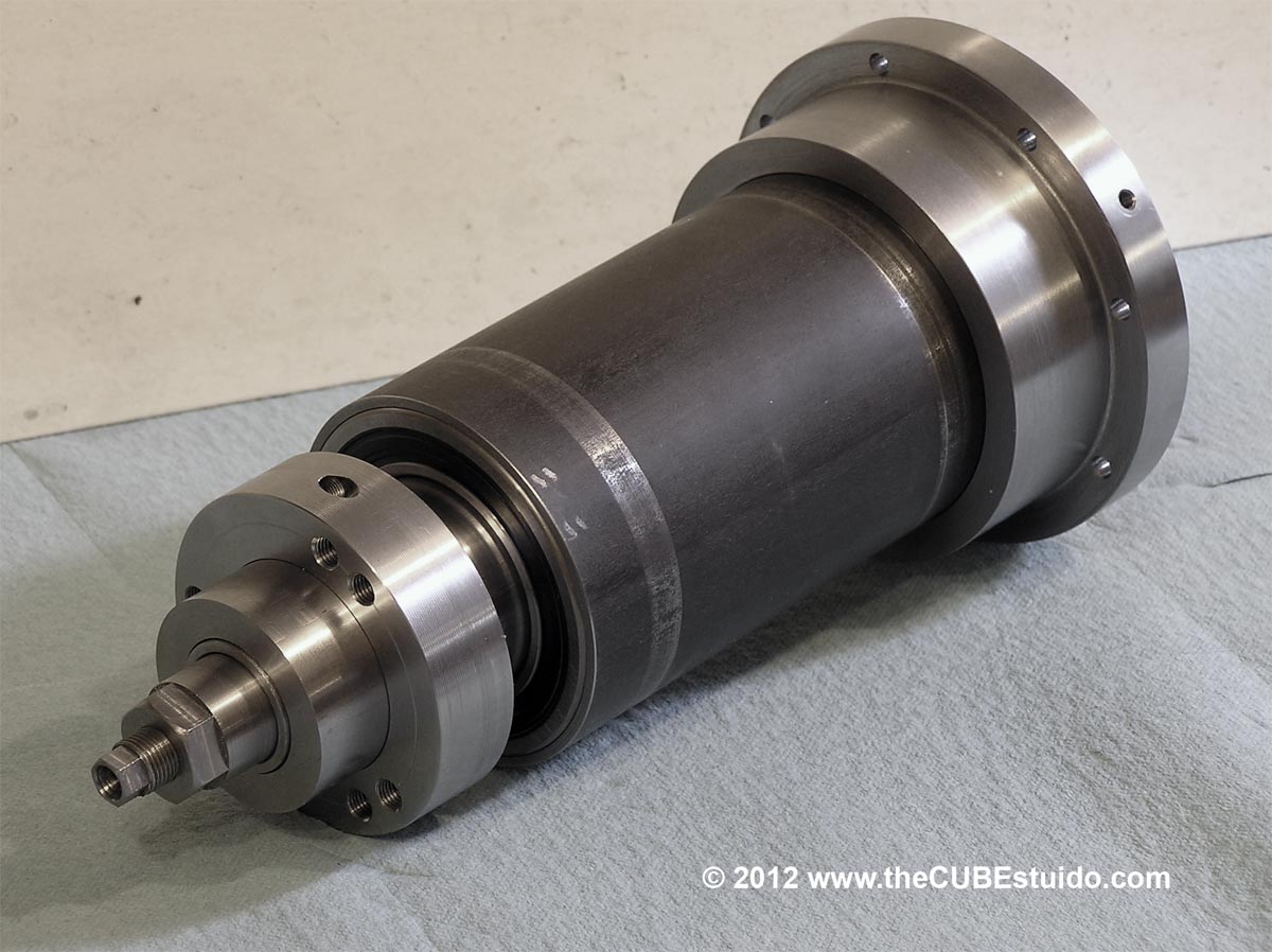

Quick update on the spindle. Spindle proper is completed except for grinding the bearing pads and drill/tap for the drive dogs.
Progress photo here:

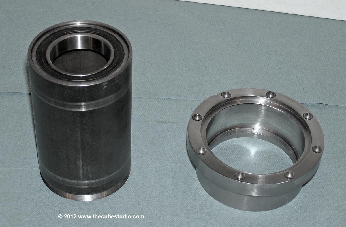

Couple more progress photos:

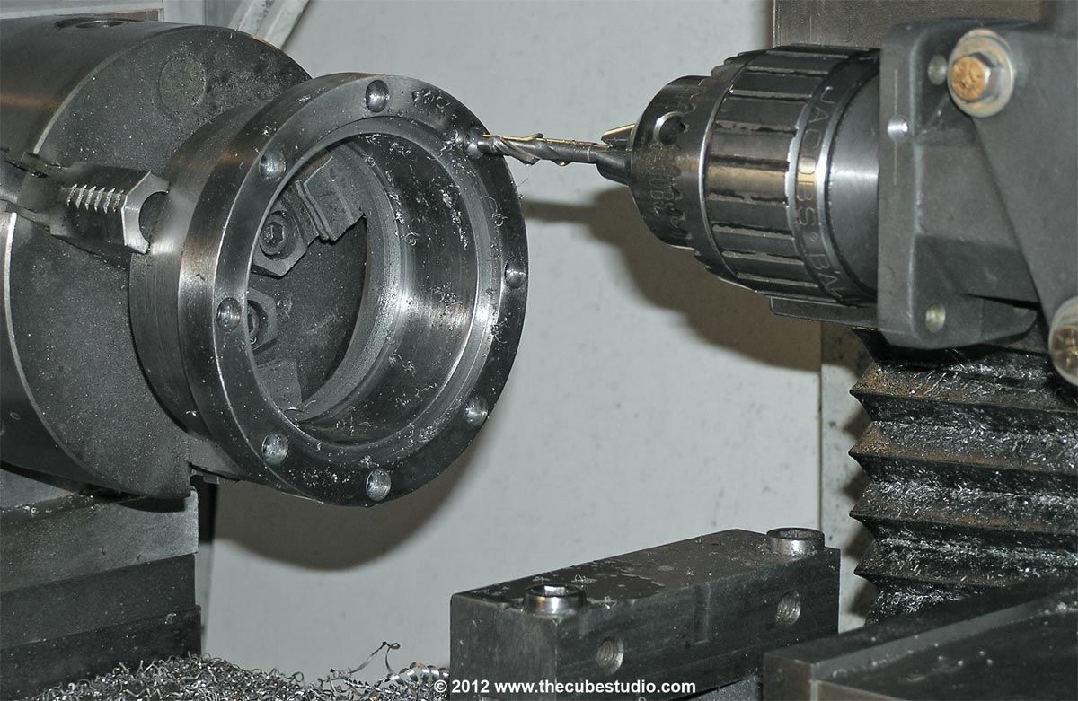

The latest addition to my 'mini machinign center' is the horizontal spindle. Here making quick work of the bolt patterns and countersinking.

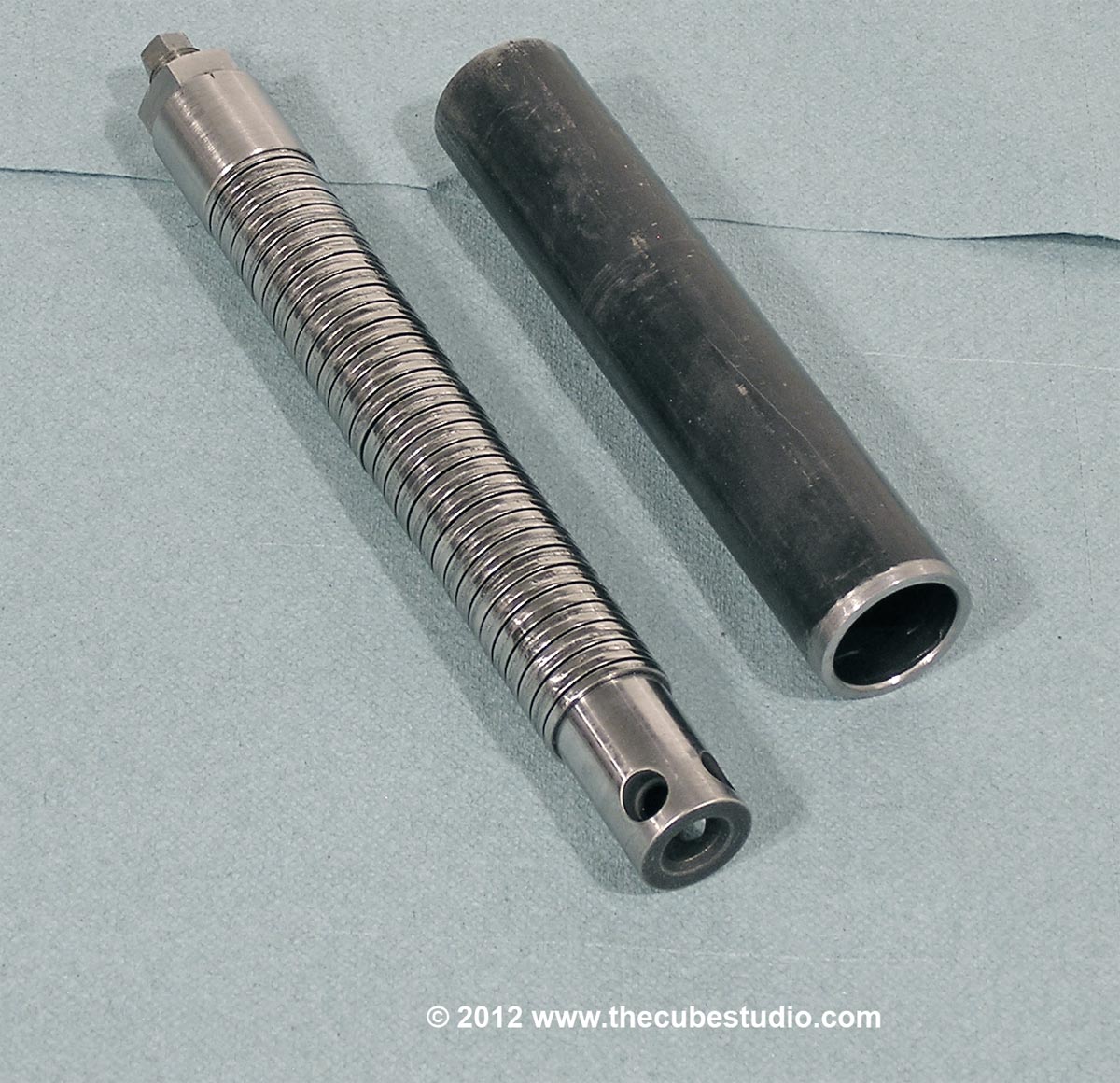

Final fix on the friggin' spring stack. I despise these things.

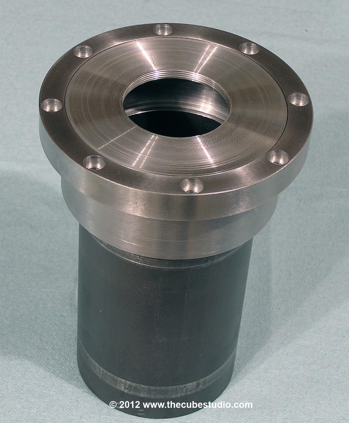

Housing parts:
And finally the whole gang in a 'family' photo:
Some detail items and final assembly and the spindle is complete.

HIYA Steve,  looking good. A couple of questions.
Do you plan to preload the bearings? or let them float?
Is your spring pack release mechanism going to put full load on the bearings?
« Reply #86 on: September 04, 2012, 10:48:30 AM »
The lower bearing is dual row angular contact and is preloaded. It is ABEC3. The spindle nose has a threaded retainer, so if I chose to use separate ABEC7 angular contact set, the retainer would clamp them together (preload is already set on these bearing sets). In either case, the upper bearing is pressed in (lightly) to the case and floats on the spindle (snug). The housing is steel, to the expansion difference will be only the delta in temp from the spindle to the case, which will be minimal.
A C3 top bearing would probably have enough clearance to not need to float, but I did not do the calculations on it because I elected to float the top bearing anyway.
The lower bearing will take the full force of the release, but it is well within the static load spec on the bearing. Again, I have not done calculations to quantify, but I would not be surprised if the force required to fault the Z axis is greater than the release pressure. 400 watt motor thru belt reduction to a relatively fine thread ball screw. The new mill will have a 750 watt Z axis motor because the head will be much heavier.
Edit: incidentally, I am of the opinion that the big CNC manuf spec a certain finish on the Belleville springs. If I could do so, I *might* be inclined to use them again . .  unless the cost was prohibitive. I will never use off-the-shelf commercially available Bellevilles again for this application. In fact, I am considering selling this prototype BT30 and making a larger spindle  . . . for which I would be able to use the coil spring.

« Reply #87 on: September 04, 2012, 11:33:40 AM »

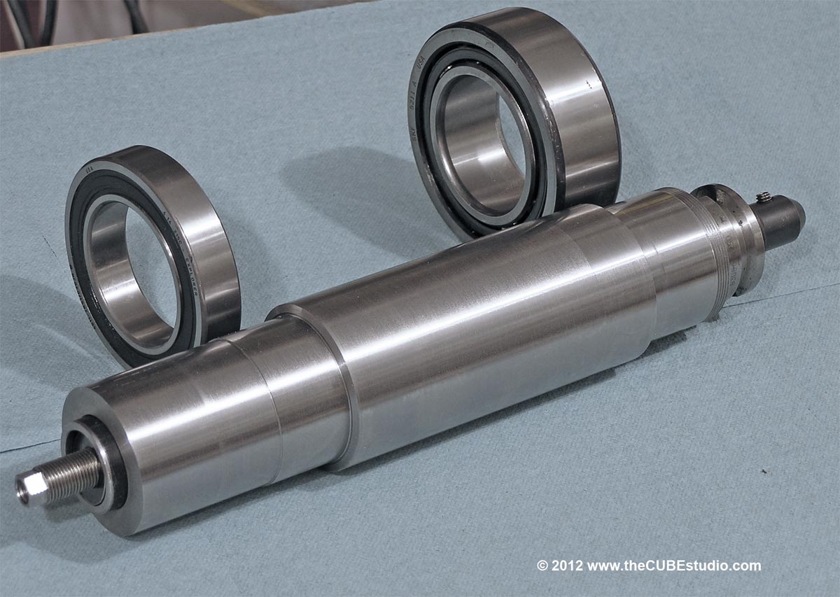

Steve what holds the lower  bearing bearing set snug in the spindle housing?
In the old days we coated the bevells with high zinc grease and never saw a problem with years of service between change outs. Sometimes that rougher looking surface is better at holding the lube than a super slick finish.
Lookin Good,  (;-) TP
« Reply #88 on: September 04, 2012, 07:21:28 PM »
The lower bearing is pressfit on the spindle and in the housing. I use Loctite 609 bearing set as well if it is a steel bearing in an aluminum housing. I will use that here as a precaution. Mechanicallty there are pins that prevent the bearing from moving and lastly, I have decided to preload the upper bearing in order to take the release stress off the main bearing. So altogether I think that is 4 methods of retaining the bearing.
This wraps up the spindle project. If anyone is interested in purchasing this prototype then I will build a larger one, otherwise I will use it in the new mill as-is. PM me if interested.

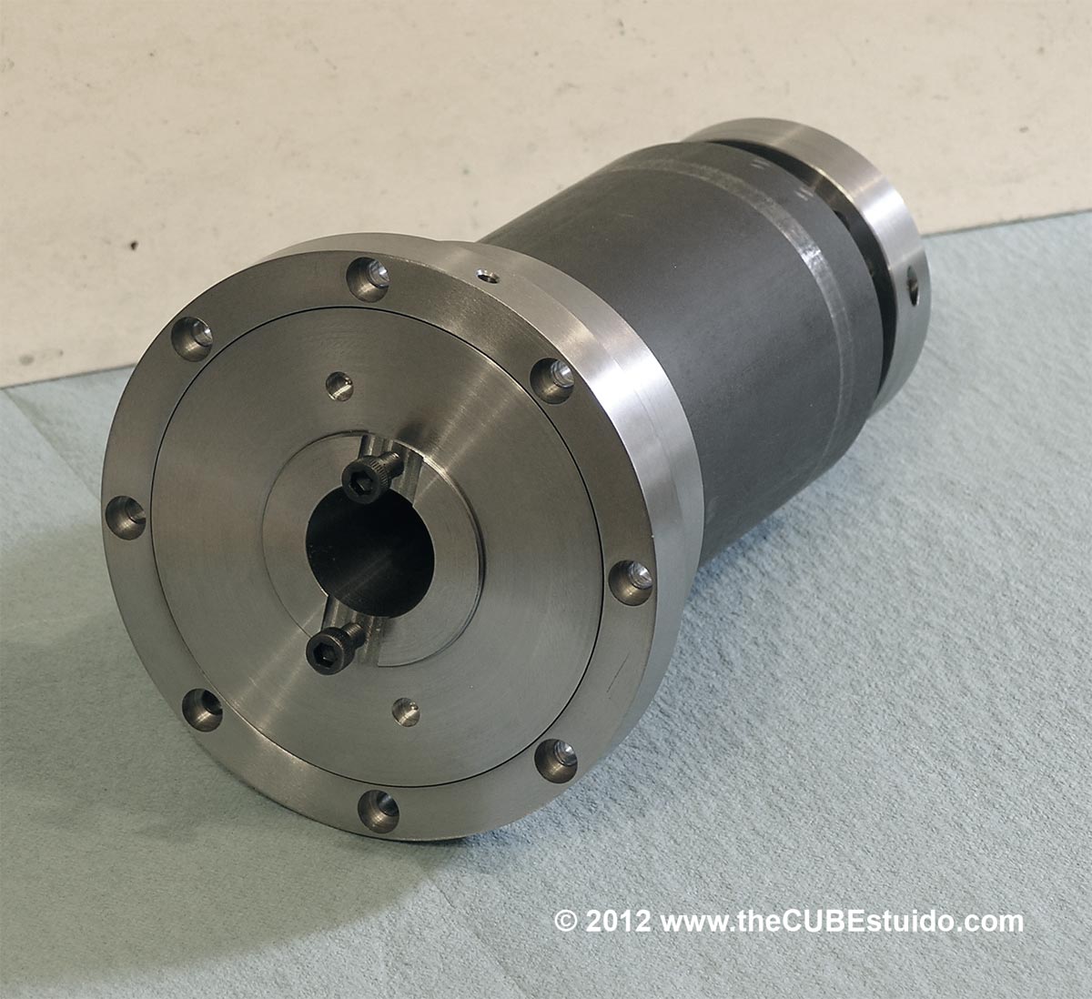

Here are progress shots of the completed spindle. All that remains is the drive pulleys, which attach to the steel clamp collar shown.
Two sets of holes in the clamp collar are to mount items above and below the collar.
From the front, you can see the Labarenth seal and the mounts for the drive dogs.

You were talking about the finish on the disc springs, have you had them plated or is that the way you got them? The only ones I have ever seen have no plating at all and are black (maybe some sort of  passivation?)
The way the cylinder and springs are designed on the Beaver mill is quite nice I think, spindle, drawbar and cylinder are all in one unit thus no pressure on bearings at all as far as I can see.
