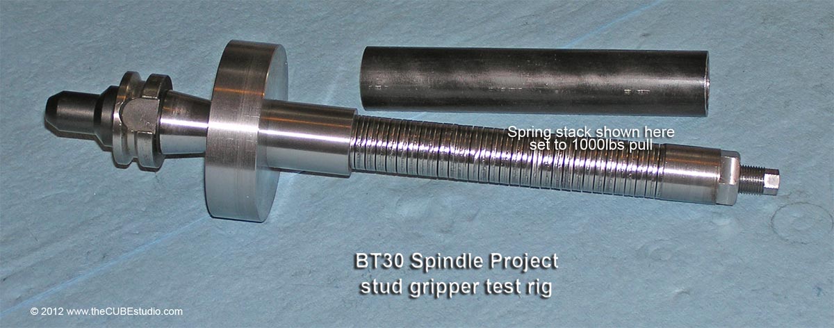

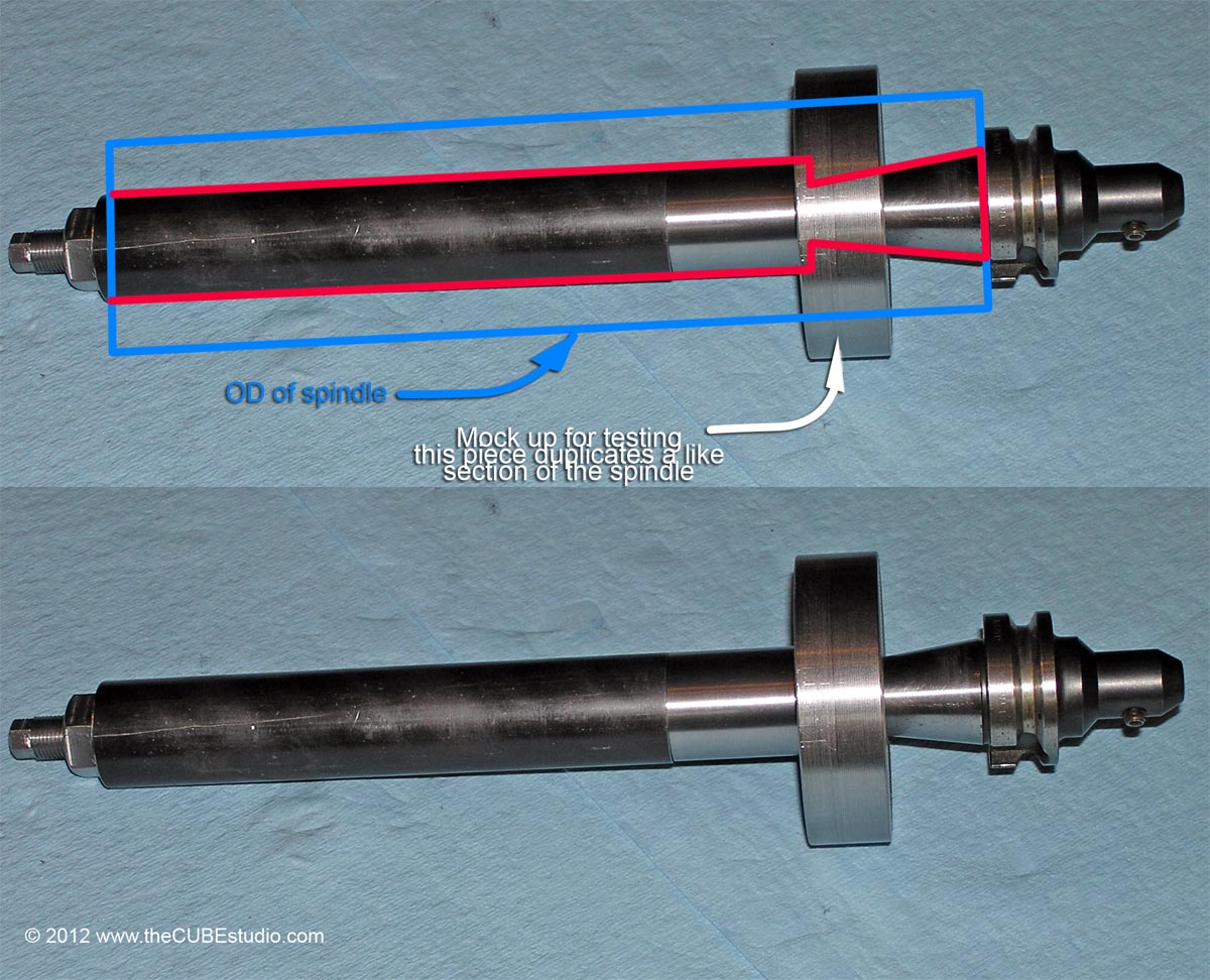

The entire Gripper assembly is now completed and tested. Here are some photos of the complete assembly and the test rig.  I will be doing a full YouTube video on this project, and I have a small fragment showing the testing of this completed gripper. I'll post a link when I have it on my site.

It seems you were able to fit a goodly amount of Bellevilles in there so your ejection force won't have to be as large as mine.

The Bellevilles are working and there are ways around the spring-to-spring friction issue, but I still do not like the whole concept. The BT30 is so small that the gripper sleeve has to be installed from the opposite end of the spindle, which leaves a much larger hole in the spindle leaving the need for a 'platform' to be created for the base of a coil spring. Plus I would have to reanalyse the stresses for a thinner spindle wall (larger hole). There was a spring washer available which met all of the requirements and has a path to a heavier 'sister' as an upgrade path, so that was the easy way out for this first iteration. As you can see from the video fragment, the assembly releases at .20" with the stack set to 1,000lbs and there is an additional; .135" of travel after that. The spring pack binds at about 1,940lbs. It should take about 1,400lbs to release. I have not calculated the max available pull, but I know it is way above what is needed, so the heavier sister will not be needed and I will design the pneumatics for  a 1,800lb release @ 90psi.
The gripper will normally run at about 600lbs. I have tested the gripper mechanism to 3,000lbs and there was zero dimensional change, so I'm calling it a done-deal. I will be making a much larger spindle immediately following this one and I will use the coil spring in that design. Interest seems to be waning in this project, so I may not post beyond this, but I will be making a video of the entire development process. After I have presented it to the folks who are behind this whole effort, I will post it up on YouTube.
