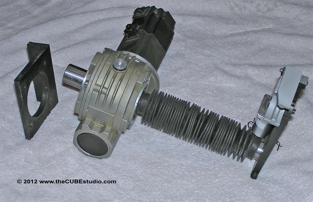

OK sports fans, I am almost to the point of working on this ATC again.

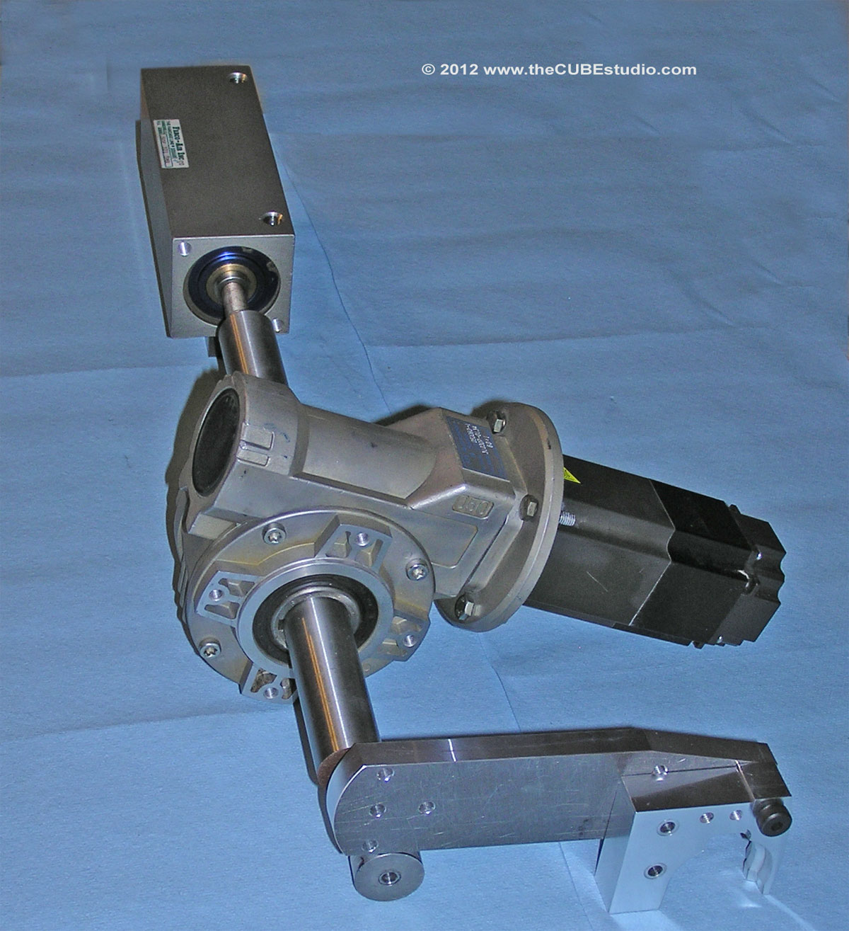

Here is the feeble sum total of my progress over the last 70 days or so . . a couple of mounts. I included an older shot (second photo) of the arm actuator to show the air cylinder that will drop the arm vertically.

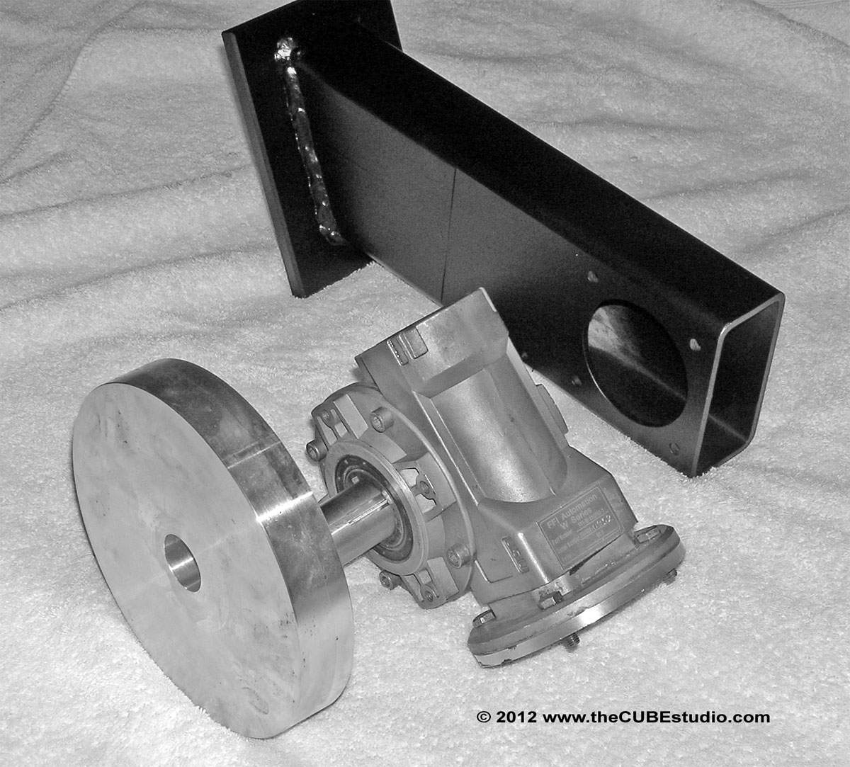

I had some other weling to do to make a new ficxture, so I made up the carousel mounting arm while I had everything dragged out for welding. Then I was doing some surfacing, so I grabbed the arm off the shelf and cut the mounting pad. I was doing some boring, so I grabbed the swing arm transmission mount . .  etc etc. Little bit here little bit there.
However, sometime towards the end of next week, I will be spending about half of my time finishing this thing up. I have some material coming to partially build the new mill head so that I can mock up the final assembly and and start testing.
Oh and incidentally, I have a big fat die spring for the next drawbar and I'll be showing that coming up pretty soon. Bye Bye belleville
