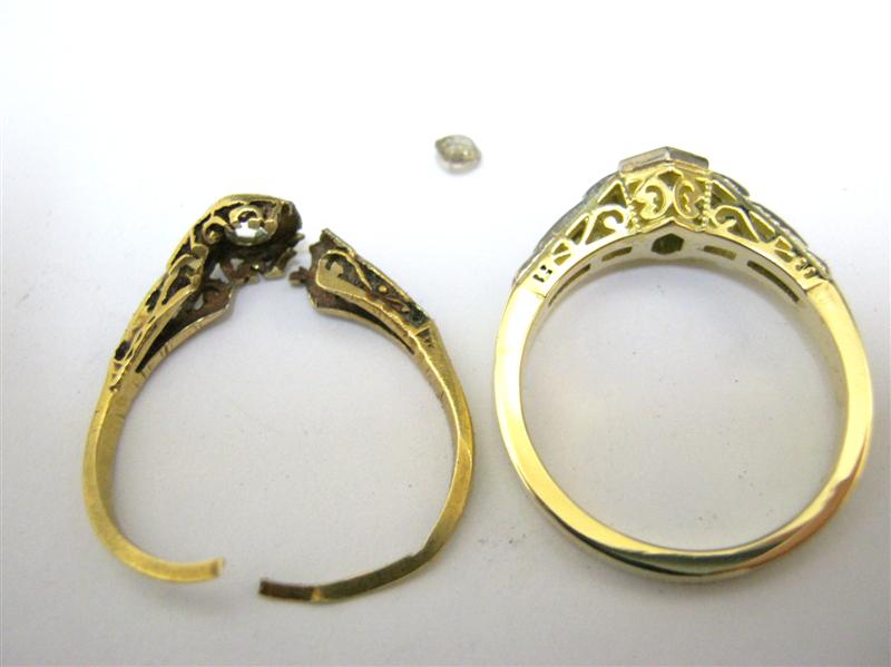

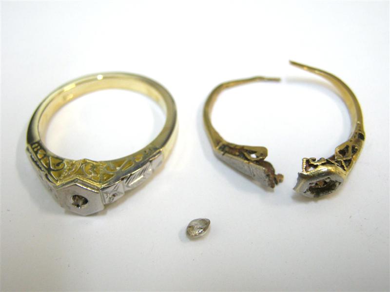

been a bit since i posted guy, sorry. been busy'ish.
I had a nice project to work on here.. saving grannies ring.. this mount is super old. the stone is unrecognizeable cut too. im guessing some windowed rough.
Doing a job which has this much sentiment and very littel actual design characteristics left is always shaky business.. Granny will remember it like the day she first got it, and you need to try live up to that...
wisps of original ring supplied
grab decent picture if possible
bring into Rhino and orient it as best as possible.
adlib the design around what little we do have.
layout for milling.
milled wax.
Cast model.
Some assembly required
and model assembled.
a few before and after shots..
« Reply #324 on: December 08, 2010, 09:58:33 PM »
Wow. Great work Chris. Being an older ring, was the amount of original detail considered to be high for the period?
  •  9,366 9,366
« Reply #325 on: December 09, 2010, 01:18:24 AM »
That is just excellent Chris.
I really look forward to seeing your postings, don't leave it so long next time  ;)
« Reply #326 on: December 09, 2010, 04:05:26 AM »
hey guys, thanks :)
those pieces typically were stamped and assembled. its possible it was hand pierced but unlikely. the level of detail in jewellery has actually gone backwards over the last 20 years. simpler stuff, with cleaner lines seems to be more the order nowdays. But, i service top end lines so in my workspace typically 99.99% of the ring is all about the stone and only marginally about the ring itself. back in the days when diamonds were scarce this was the reverse.
