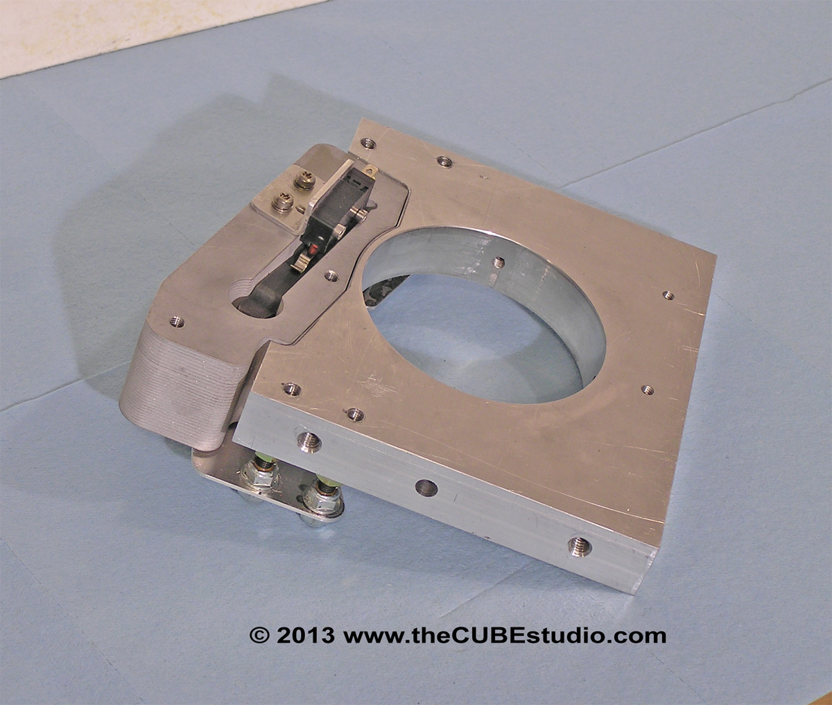

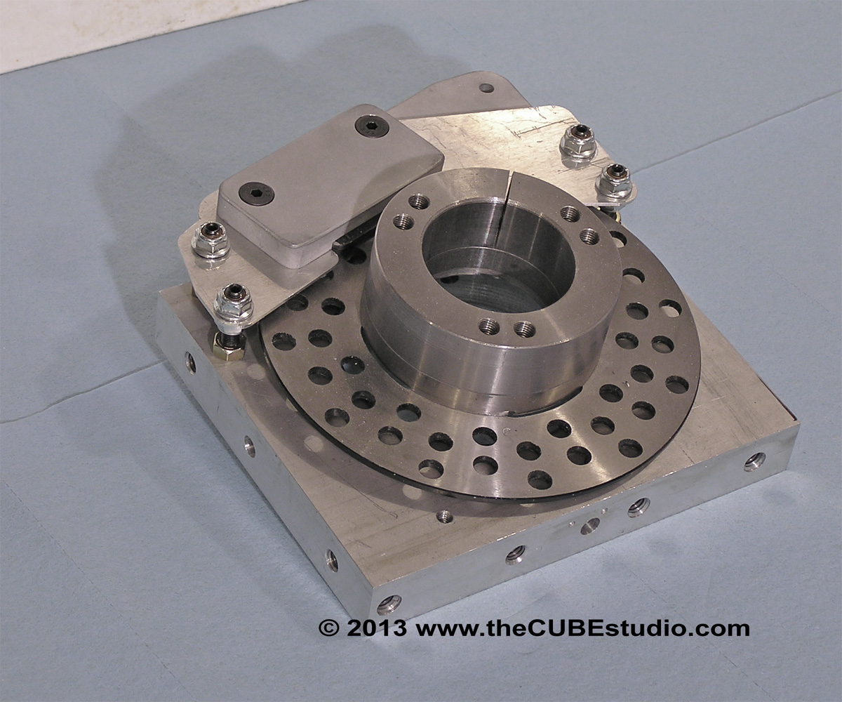

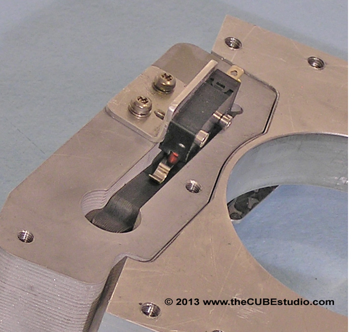

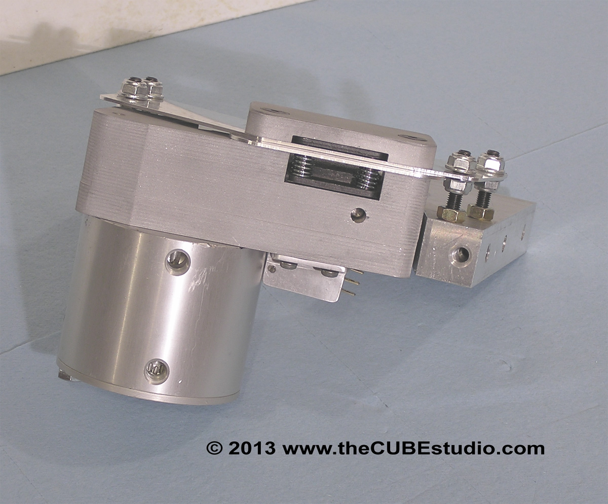

Saving the best for last, here is the spindle lock for the BT30. For my current 'Franken mill', I just grabbed one of the calipers for my 4th axis and stuck it on the mill head. It works great even though it is a bit ghetto.
I had planned to use one for this project also, but alas there was no way to get it to coexist with the large diameter spindle cartridge. So back to the drawgin board for a one-off custom caliper for the BT30 project. Basically it is just a modification to the InTurn™ articulated pneumatic caliper with a longer arm to move the cylinder out away from the cartridge tube . .  which required a longer stroke cylinder, a thicker body . .  and so on down the line. It is a very cool part, I think, but I just stole if from the InTurn™, so it's not really 'new' new.
What is new if the sensor in the form of yet another little sealed limit switch that bears on the caliper arm. This will report that the caliper is either active or that is is open. The cylinder is removed in the last two photos.
