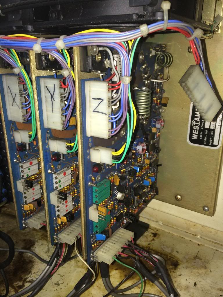

Next, I did a half-a$$ control where I wired the encoders and the servo control wires to the galil I/O, then turned on the dynapath to supply all other voltages needed for running the mill. I can control all three axis with mach3 (woohoo) but I'm getting no encoder information. The ports and pins are all checked to unable and the all of the ports and pins have a "0" for an address. Basically same as the servos. But nothing, the encoders are getting power and ground, they are also configured right for the "counts". Any ideas???

What drives are they?  Model # and make.  There has to be a way around that!  Hard to tell not being able to look at it and all...
Make sure that the motors are "enable" on the ports and pins screen.  No need to set step and dir pins.  Just enable them.

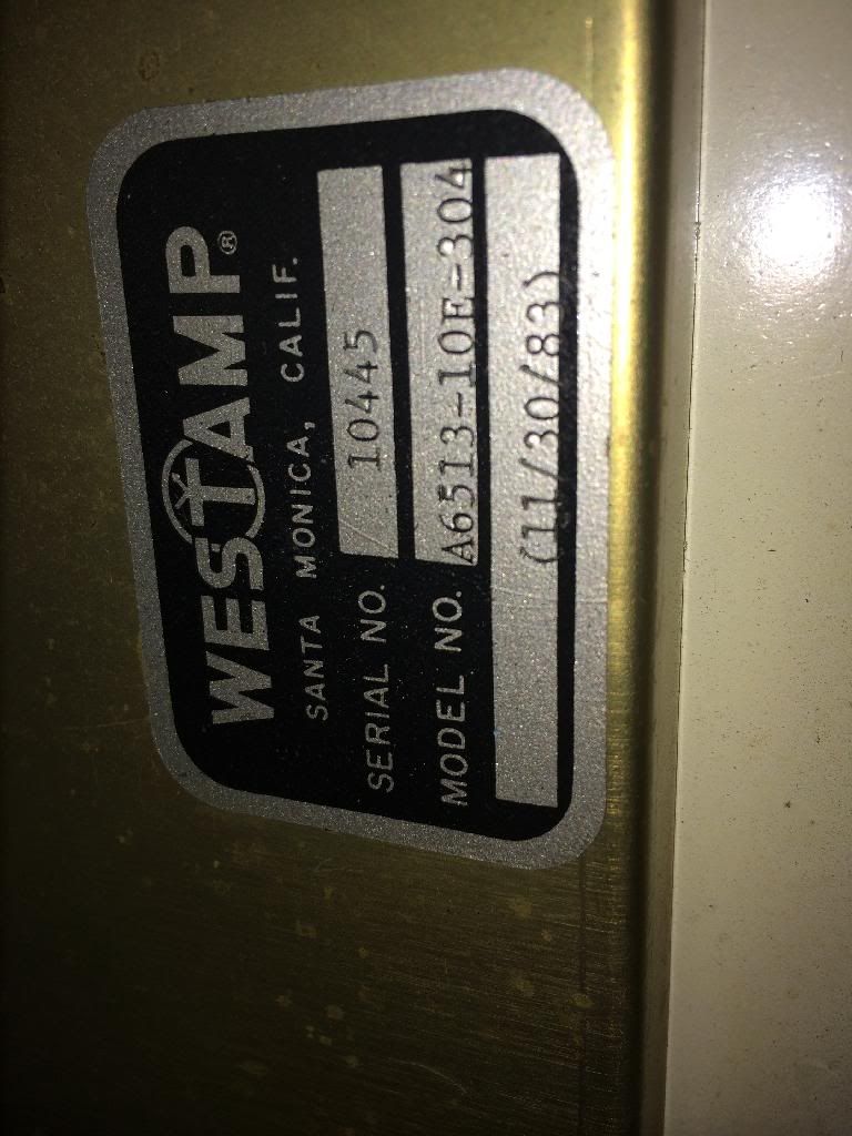

I'll get the amps info now. The ports and pins are enabled for the servos and encoders. But the encoders are not responding in mach3
Please excuse the rats nest. I cut all the zip ties to verify wiring..

http://www.ormec.com/LinkClick.aspx?fileticket=upw7DE2FD8A%3D&tabid=168&mid=757
That is the manual for your drives.  It looks like you may need to wire the limits in parallel with the Galil.  :(
