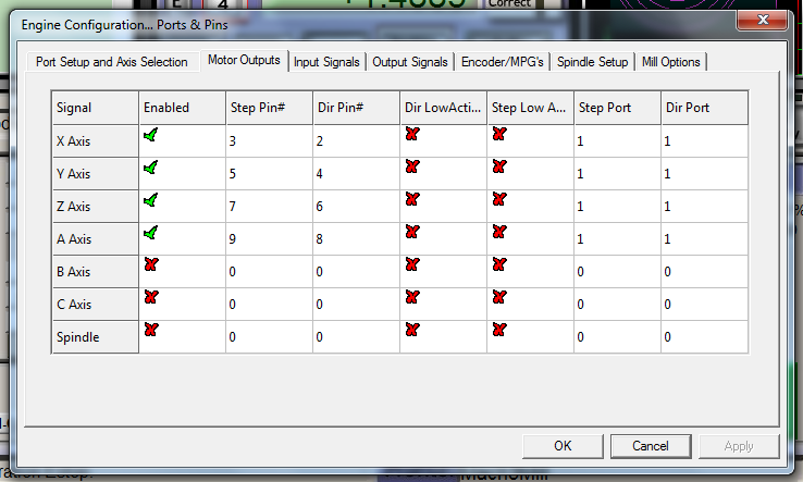

My motor outputs are
X - 3/2
Y - 5/3
Z - 7/6
A - 9/8
I have tried switching to 2/3, 4/5, etc and it won't work, even the X axis won't work at that point.

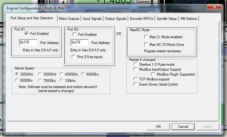

This is what I have for Printer port settings
Mach screen for parallel port
Pinouts

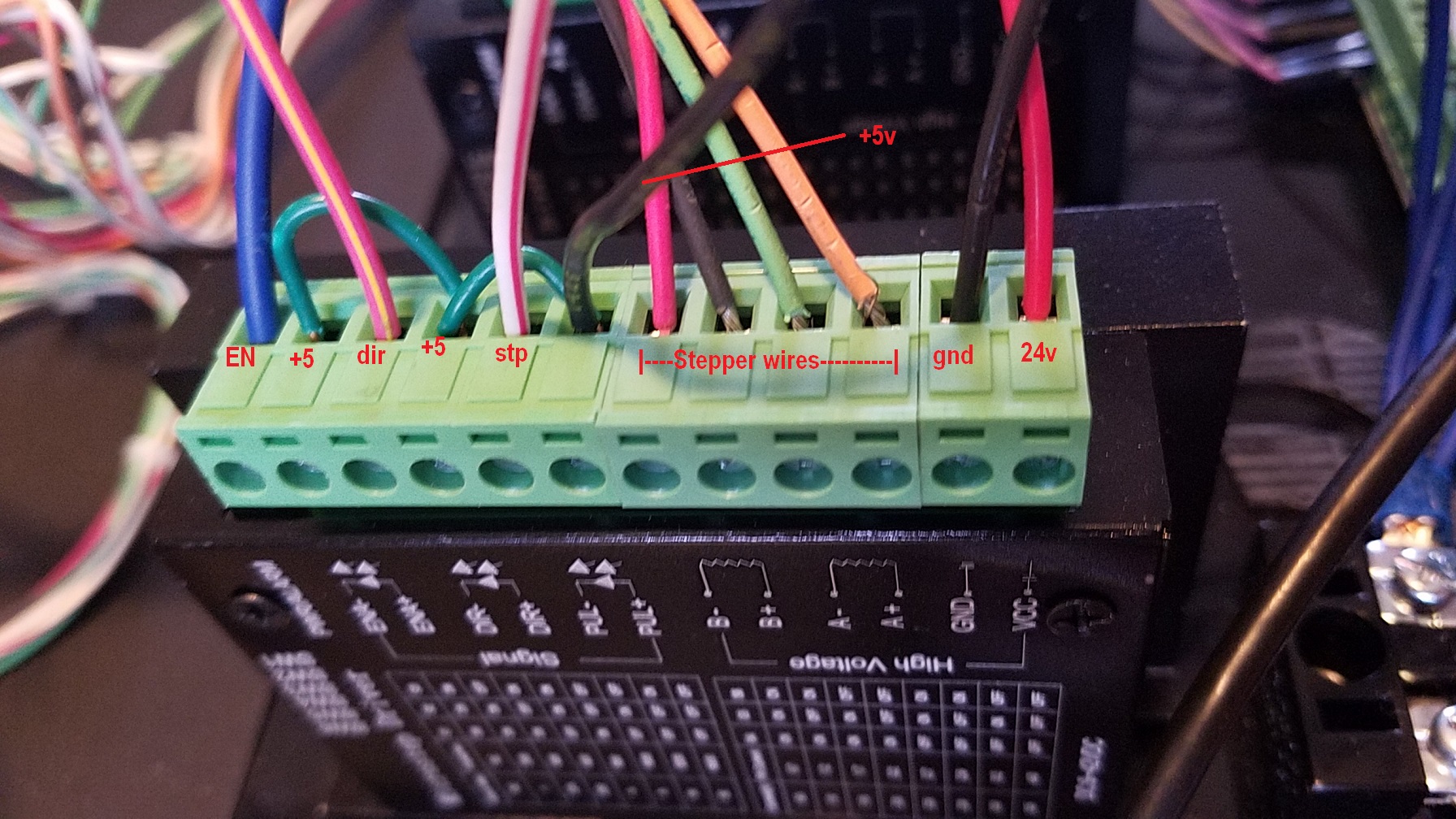

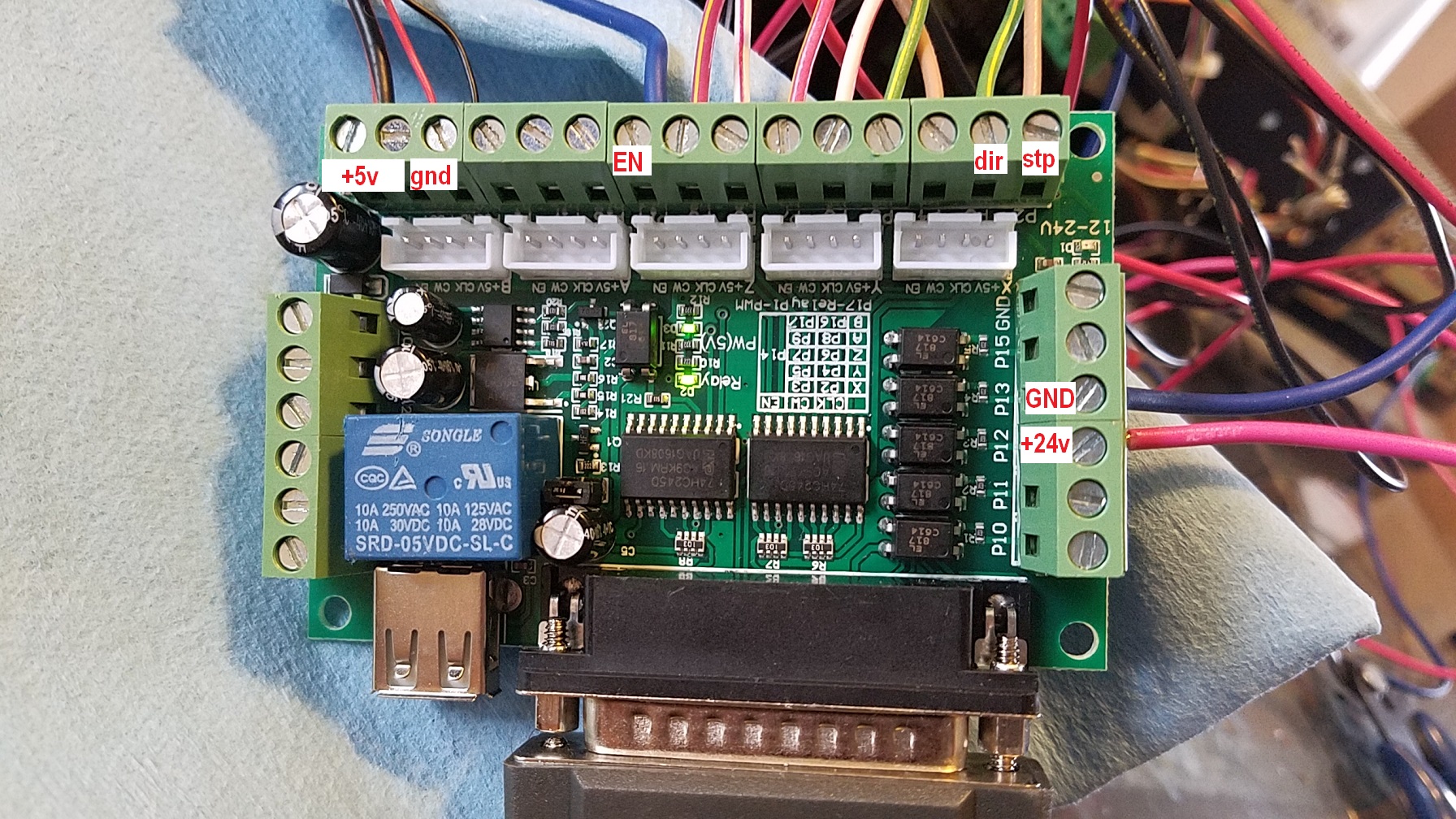

« Reply #4 on: March 18, 2018, 07:46:32 PM »
Here are actual pictures of what I currently have set up.
This picture is of the A axis driver setup. The other three are set up the same.
The wires are kind of a rats nest as I tried to narrow down anything I had hooked up wrong and the breakout board is set there temporarily

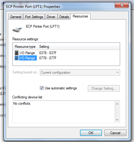

« Reply #5 on: March 18, 2018, 08:15:56 PM »
Could the problem be that the computer uses a ECP Parallel port driver?
If so, how do I fix that?

« Reply #6 on: March 18, 2018, 09:29:33 PM »
 I think it possible that you require two power supplies, one you've already hooked up but try hooking up the
other one, that is the USB cable back to the PC, it provides power also.
Craig
'I enjoy sex at 73.....I live at 71 so its not too far to walk.'

The +5 and gnd in the upper left of the above photo is a 5v power from the USB on the puter. I still need to check to make sure it's outputting 5v.
The other USB on the board, from what I've read, is optional. You can either provide +5 from the computer where I have OR you can plug in a USB cable or both (but I read that on the internet so it HAS to be true, right ;)
I did it that way because, despite the fact that I know I have FIVE usb flat to usb flat, I can't find them.
I can pick up another USB cable tomorrow and give it a try, however.

« Reply #8 on: March 18, 2018, 10:10:35 PM »
Hi I think that 5V supply you have provided if for the output side of the opto isolators. The USB I would expect
to be on the input side.  I would be tempted to try the USB cable trick.
Craig

« Reply #9 on: March 18, 2018, 10:40:57 PM »
Thanks. Will give it a shot.
One of the tutorials I watched on youtube showed that there needed to be both because of a bad bridge on the board. He was showing where to run a jumper.
I will pick up a USB cable and give it a shot.
