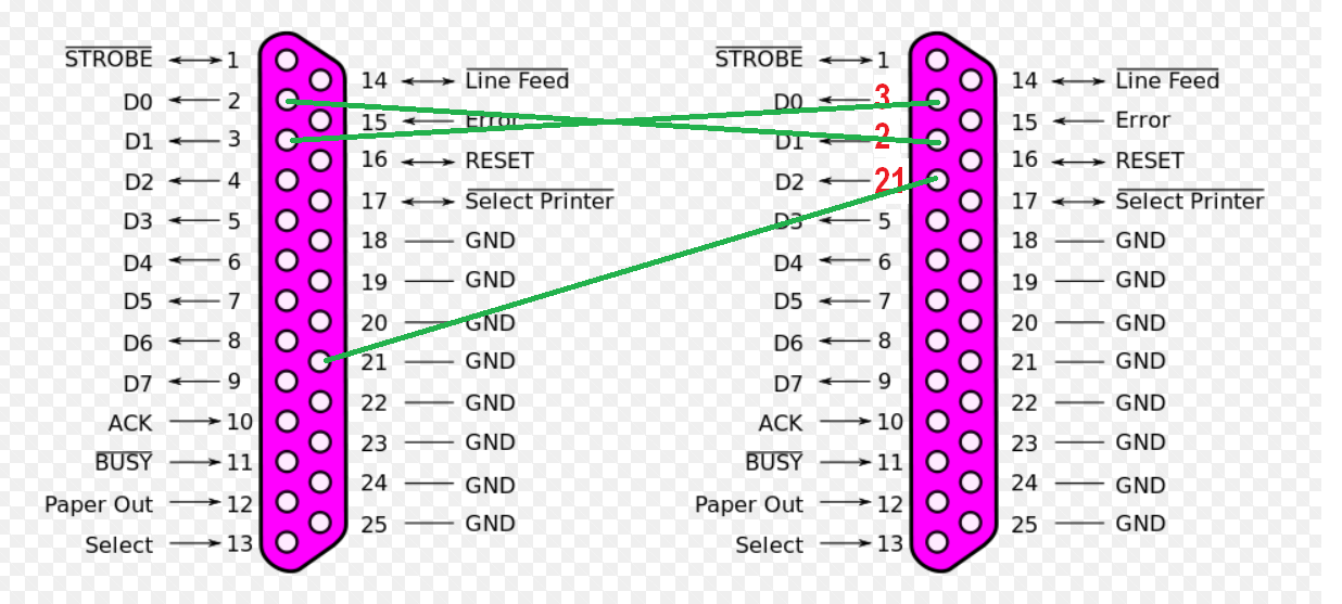

So, here's where I am.
I took a look at this video
https://youtu.be/uglCm_qsojk
Then I did what the video said.
I hooked the ground to pin 25 and then the positive on the multimeter to pin 2. It was reading 3.3V
I checked pin3 and it read zero. Then I pushed the up and down arrow and the output changed to 3.3V
I checked pin 4 and it was zero. I used the page up and page down and the pin read 3.3v.
The interesting part was that, once the pin went high (3.3v) it wouldn't go low again.
Still trying to figure out why X will work, though.
I only tested pins 2,3,4 this way. If they don't go low then there appears to be a problem in the computer.

Here is one absolute that I got from my diagnostics.
Pin 2 on the parallel port emits on pin 3 on the cable.
It's a brand new cable and it's bad.
I suppose I could use a multimeter and map out the cable to find out if all the pins are off one or if they are all connected or whatever and then remap the program based on the outputs.
Or I could buy a new cable.

Re: Only X-axis motor is working
« Reply #76 on: March 27, 2018, 10:12:38 PM »
HANG ON!
Where are you getting your pin numbers from?
The pin numbers seen on a ribbon cable connector are NOT the same as the numbers we use for I/O pins on the PP. In particular, pin 2 in CNC numbering scheme is pin 3 on a ribbon cable.

It was a simple continuity test.
Here's where I stopped
Offline rcaffin
  •  1,073 1,073
« Reply #78 on: March 27, 2018, 10:40:16 PM »
Ahhhh ...
I am not entirely sure I understand your diagram. If it really means that you got continuity between p21 at the left side and pin4 at the right side, then I am boggled. That is NOT a DB25 extender cable!!!!!!! I dunno what it is!
That is exactly what it means. I got continuity between pin 4 and 21.
I can't reassign that.
If I couldn't get another cable tomorrow, I'd split the cable and manually rewire it all for a test. For now I'll wait.
