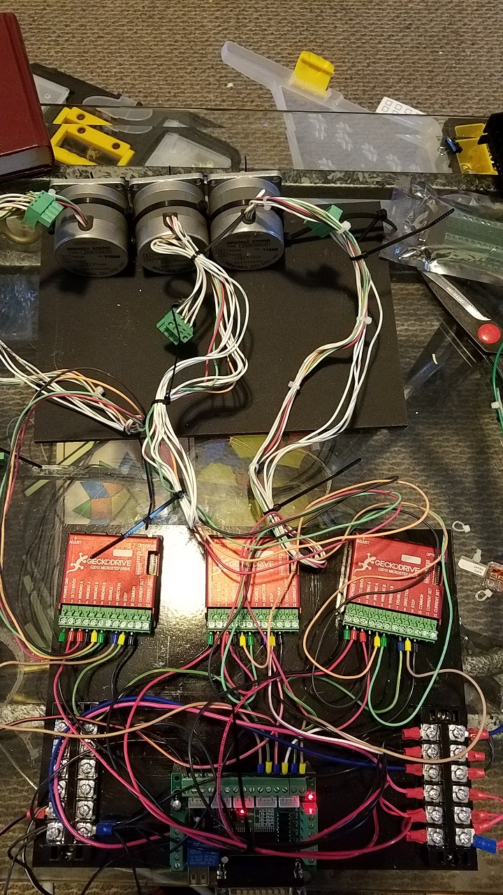

THe Gecko lives!!
I hooked up a different stepper with the output amp set to 1AMP.
Everything else was set exactly the same as it was when I was getting the pulsing, after verifying that's what the manual said to do.
I did a quick spin with Mach 3 and the keyboard and it seemed to work fine.
I ran a test G-code and it performed flawlessly. There was no resonance.
At the end of the G-code I sent the motor back to zero and it went there. No lost steps.
I still need to run it through some tuning exercises but I'm confident that it will work fine now.
Next big purchase will be either the motion controls for the table or a set of NEMA 34 or 42 motors.
Thanks for all the input.

« Reply #224 on: June 10, 2018, 08:49:48 PM »
This is my setup with three active, accurate, stepper motors running.
I've run a test G-code a few times now and it always returns to zero when I prompt it to.
