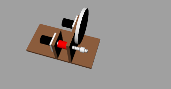

There is some talk in another forum about making a coil winding machine, for winding transformers, guitar pickups etc.
I was wondering if the was any wizards in Mach that does this?
How hard would it be to make a wizard that takes ito account.....
Wire thickness
Spool width
Spool thickness
Adjustments for each layer of wire ( as the spool gets thicker)
Etc
Has any one done this?
I think this could be a really handy feature in addition to Mill, Turn, you could also have Wind.
Dumb Idea?
Please forgive me if this has already been discussed.
Regards Benny

Benny that pic looks great.
I was thinking about winding coils also, I need to wind some solenoids. It seems to me that a wizzard for lathe would make more sence. If you think about it laying down coils is a lot like cutting threads.
If you added a spool diameter and had a lookup table you could also calculate coil resistance based on the wire diameter and calculate how many feet were going to be used. You would also need to know the bare copper wire OD and the wire with the insulator OD.  for example I looked up a 24 gauge wire..

« Reply #3 on: January 15, 2006, 08:46:44 PM »
howdy all just found this site   but also on the zone     one thought on this because i wind pickups also   is on the movement   if it works to where it starts at 0 then just steps the size of the wire to the end of the bobbin then back  to bobbin   theres a prob you will get more capacitance   and thats where the probs come in    for a pick up you need more of a variable movement  i guess what i'm trying to get at is a  random time for movement and random amount of movement on the winder i built it origanally had a cam for the movement and it gave about the same sound each time    to get different sounding pups i had to start guiding the wire by hand which did give me different sound  i guess if there was a  way for the cnc to let you teach the movement would be nice too  as you could  lay different pup styles and save the gcode for it

« Reply #4 on: January 16, 2006, 08:46:39 AM »
i don't have a cnc winder setup at this time but i do have the things {motors ,drivers )   that i could build another one with  if your game on the code i would be more then happy for testing  and setting up a cnc winder   i guess the big things (for me ) would be bobbin size or fill area  # of turns   and the ability to "learn" the movement  or the option of random movement
another thing that would be nice is if i could enter the wire varibles  ohms per foot  wire size  and enter the amount of resistance i would like to wind and have it calculate the  # of turns  theres a guy on another site i hang on that wrote a calc/counter program but to be able to do it in cnc would be really really nice

Re: Coil winding machine ( Wizard needed)
« Reply #5 on: January 16, 2006, 07:52:23 PM »
well heres the basic idea i will use for the machine will be gone for the next few days i have family going in for surgery but once thru the worst of it and back home i will get this built     the only other thing i need to add is a tensioner for the wire  so once back i will update     one thing that willl be real nice is controlling the speed of the wind with the puter : )   thanks much guys
