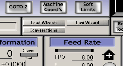

There should be a button like this one on your page:
The "Load Wizard" Button should take you take you to a place where you can chselect and run any wizard on the system.
The "Last Wizard"  Buton will load the last wizard that you ran
The "Conversational" Buttonwill open the Newfangled Solutions addon for mill wizard (This is the only one you have to buy a license for"

« Reply #7 on: December 21, 2005, 03:47:55 PM »
Oh yes I have that buttom, but in that picture you show a button for machine co-ord's, well I don't have that one. I'm sure that there are a few more that I don't have also. How should I design and build my own screen?

This is the screen that comes with the downloaded version of Mach3 :)
If you look in the Mach3 Dir you should see a 1024.set file that is the screen set.
Hope that helps
