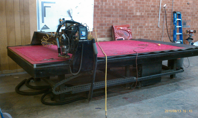

Hey Rich,
I am new to this. So I'll do my best to give you any info. And thanks you for any help you may have.
The hardware is AXYZ automation. I am not sure what brand of table it is. I have not found any manufacturer data on it or serial tag or plate. I will post a pic of the table below if that helps.
The controller board says AMC0001A. I believe the machine is late 90's. The pendant control works. And I can run the last like 10 files stored in it.
The motors are step motors. But I am unsure if any one of them in particular would help you in determining any info on what to do or where to go.
It uses a porter cable router. of which it came with three.
I paid $250 for this thing, so if I have to put a little money into it, I can do that. It was in production use a few days prior to the shop closing down.

« Reply #6 on: August 30, 2010, 04:09:55 PM »
Sniper,
Suggest you contact the vendor and get some info on the controller. I looked at their site and didn't get a hit for the model you posted.
If you can't get any info then you will need to open up the controller and take some pictures of the internals.
Unless someone is familar with it, you need to do some leg work to find out what you have and post it here so folks can take a look and give you
some guidance.
Till then I can't be of much help without guessing,

« Reply #7 on: September 01, 2010, 08:52:57 AM »
 Just a little follow up.
AXYZ in atlanta helped me out with some info on my machine.
Here is what she gave me so far.
it's a model 6010 form 1995.
it has a persky 5.5 hp spindle
an invertor
runs toolpath software
Question is that a generic or brand specific software?
She is going to help me out what the cable diagram if she can get the info. If not there is a cable available to purchase.
I suppose once I get it up and running, I suppopse I will have to use the toolpath software to operate the controller. I don't know if it would be worth upgrading to other software, controls, and what ever else is involoved in upgrading the whole system.
