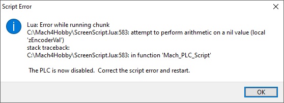

This appears to be in regards to my PLC script used to display a DRO from PMDX424 Encoder input:
Code: [Select]
local inst = mc.mcGetInstance()
local hreg = mc.mcRegGetHandle(inst, "SmartBOBUSB/EncoderDRO")
local zEncoderVal = mc.mcRegGetValueString(hreg)
local zEncoderVal = tonumber(zEncoderVal)
local zEncoderValInches = (zEncoderVal * 0.0004)
WriteRegister("Z_DRO_INCH", tostring(zEncoderValInches))

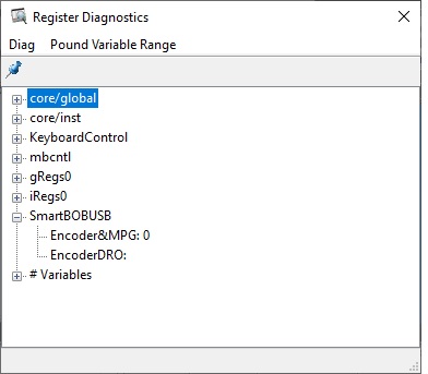

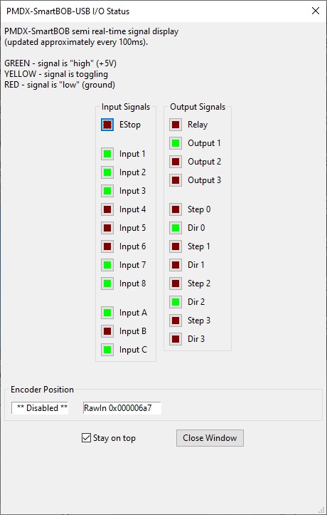

The SmartBOBUSB/EncoderDRO register value is now null.  If I look at the real time diagnostics for the PMDX424, it shows the encoder input as "Disabled":
If I look at the Register diagnostics, the value for SmartBOBUSB/EncoderDRO is blank and it will not accept a manually entered value:
I can tell it's reading the encoder because the log shows signal 11 and 12 alternating to Hi/Low as it should for channel A/B of the encoder.

Are you using an old screen set?
« Last Edit: February 08, 2020, 07:12:13 PM by Graham Waterworth »

I would try one that was installed with that version of Mach4, a lot has changed in the Lua versions in the last 2 years.

The problem is that some plugin code in the back of the screens was updated to reflect the new Lua version which can in some cases break custom screen sets.
It all depends how custom your screen set is.
You can replace your old screen set Lua code with the new Lua code from the latest std screen set and hope for the best.
If that fails its time to redo your screen set using the latest std screen set as a template.

Well I loaded the stock wx4.set screen and the lua error went away.  Can you tell me in more detail the best way to replace my old screen set Lua code with the new Lua code from the latest std screen?  I would really like to avoid rebuilding my custom screen if possible.

I am still getting the "PMDX: Encoder mode has index, cannot set Encoder Position" error whenever I move the Z axis.  I have the encoder set to just read A&B channels with no index. When I first start Mach 4, If I look at the real time IO for the PMDX424, It always says "Disabled" for the encoder position register.  If I change encoder settings, then change them back, the real time IO register view shows a count as it should.  If I exit the configuration settings and go to Mach4's Diagnostic dropdown and then select the real time IO view, it appears to count the encoder as though it's reading RPM instead of just counting?  If I go to the register diagnostics for SmartBOBUSB/EncoderDRO the value is always blank and I can never manually enter a value here.  The encoder mode error when Z is moved is persistent throughout all of this also.
Also,  I think my custom screen Lua error message is due to a null value at the SmartBOBUSB/EncoderDRO register.
