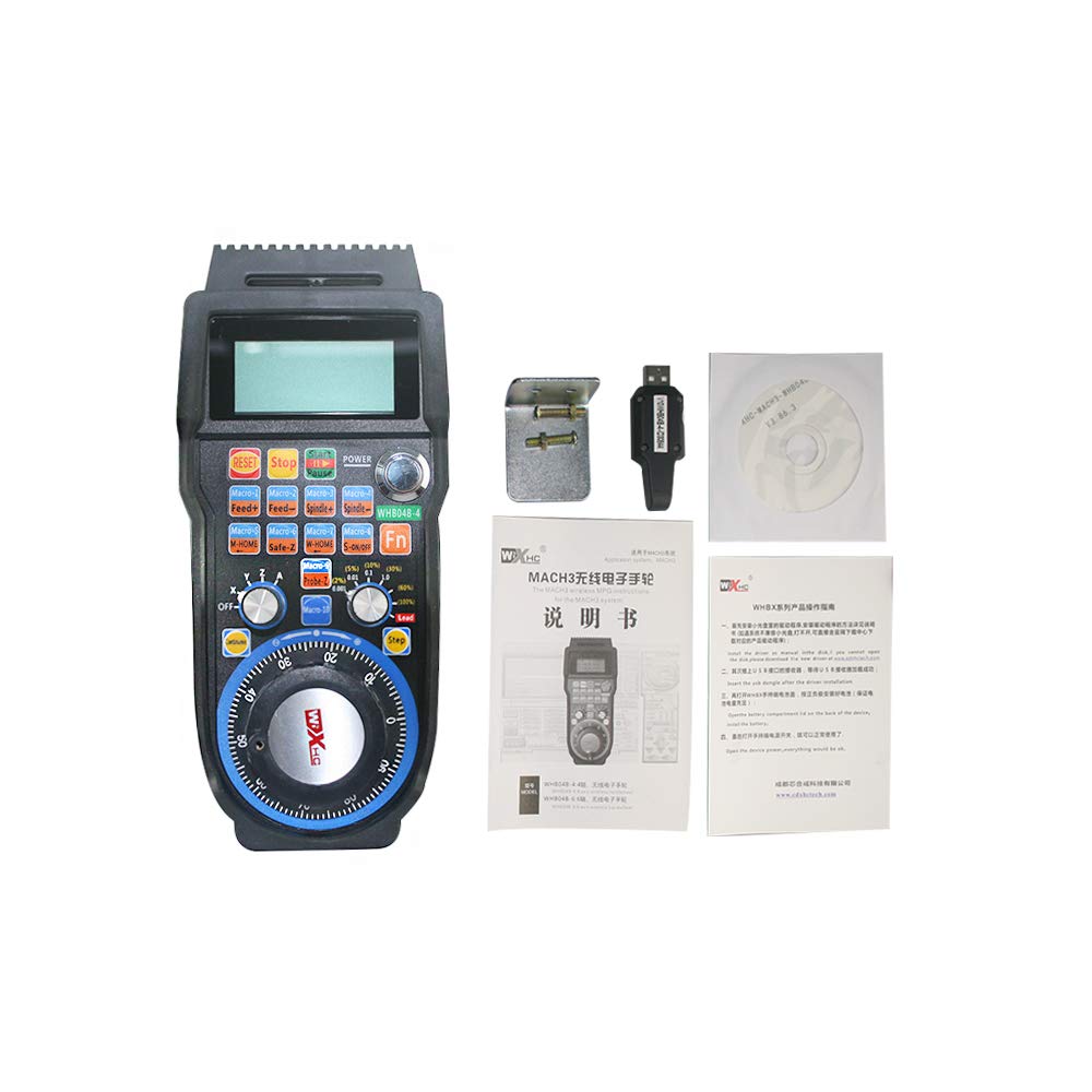

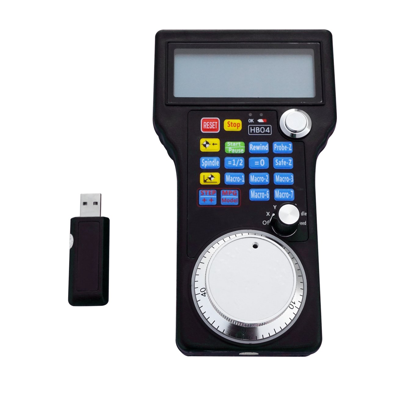

 I have one of the too, the one with the blue/orange buttons (4 axis version).
Good news is in you diagnostic screen I can see it is actually receiving data/pulses from the device just fine ... I just assume it is getting different codes than those expected. Perhaps it would be possible to make those individual codes user configurable. Or even better have some configuration screen that allows you click a function known/supported by the plugin and then it records the code sent when the user presses the matching button on the remote.
This would ensure at least some flexibility moving forward. I ordered the HB04 myself from amazon, and got the whb04b-4 instead. Not complaining mind you (as that one costs way more :) it seems) but it adds a level of tricky to this whole silly mess.
Ordered this:
but got this:
