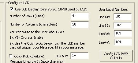

Hello everybody,
I bought a Pokeys55 for building up a pendant.
The LCD works very well with the Pokeys-Software, but now I was searching how to get the LCD running with Mach3 but I didn't find anything helpful for Newbies like me.
It is a 4x20 LCD and I want to display the DRO-Values for X,Y,Z and A (Maybe later I can display Spindle Speed and Feedrate as well?).
Can somebody give me a hint, how to do this with a VB macro? I read something about Userlabels.
How do I get the DRO-Values in these Userlabels so I can display them?
I've never written VB macros before.
Thank you so much in advance and sorry for my English :)

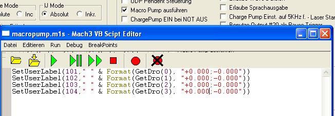

the current pokeys 7.4 that is on boris/s site, is LCD capable, please see the HELP button on the plugin dialog.
also, you will need to choose what labels to use for your DRO display, then send your DRO code to them via VB, see Wiki on how to use VB.
scott

In the 7.5 version from poscope.com the label in the config dialog says: "Use LCD Display (Pins 23-26, 28-30 used by LCD)"
What I made so far in the Pokeys Plugin config dialog:
And then I activated Macropump and made a file called macropump.m1s where I put this in:
So, the DRO values should be permanentally formatted and written into the userlabels, right?
But my LCD2 (pins 28-30, 31-34) displays nothing.
Shall I wait for the bugfix?
Thank you.
