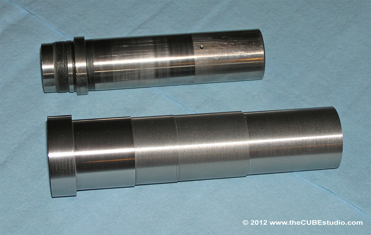

The 4th axis is getting a new custom designed and built spindle. The motivation for launching into this prokect was three fold;
1) need for strong, safe, standard chuck mounting for large chucks.
2) larger size to allow the frame to be lengthened and eliminate the cantilevered main drive pulley mount.
3) consistency and precision.
When I have more time, I will try to do a blog on the build but for now here are just a few photos of the finished spindle. I am currently building a new prototype 4th axis to house this new spindle. The spindle nose is 'universal in that it can mount standard D1-4 and also A or B style chucks.
Photo 1 compares the new spindle to the previous. The nose and front bearing surfaces are ground, hoever, both the Chuck mount and 5C tapers as well as the face of the flange will all be ground in-place after the machine is assembled and under its own power. This will provide for the runout that equale the bearing spec. The new spindle also can accomodate ABEC7 angular contact pairs for a high precision option.

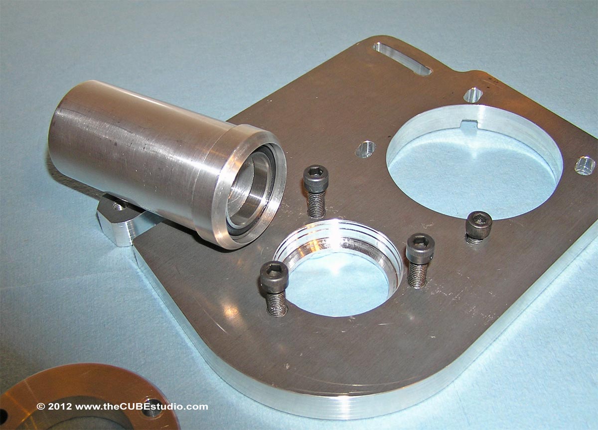

Photo 2 shows the 'universal' mount. Note the cam loc parts and also the threaded inserts. More on this later.

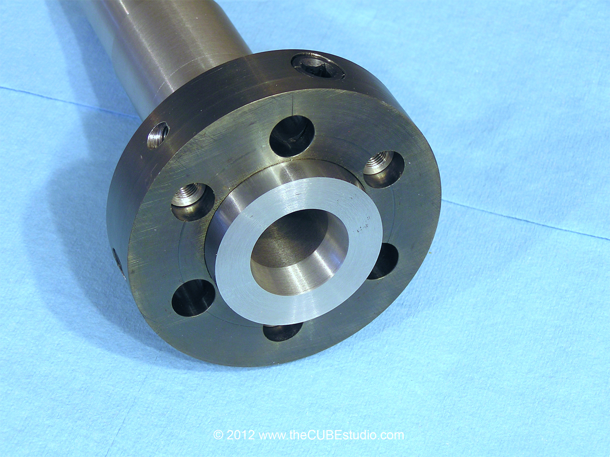

Photo 3 shows the new spindle on the balancer . .  which needed some modifications to hold the new spindle.

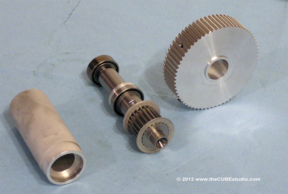

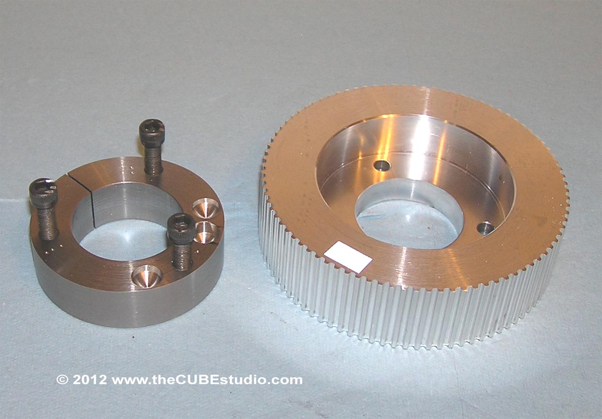

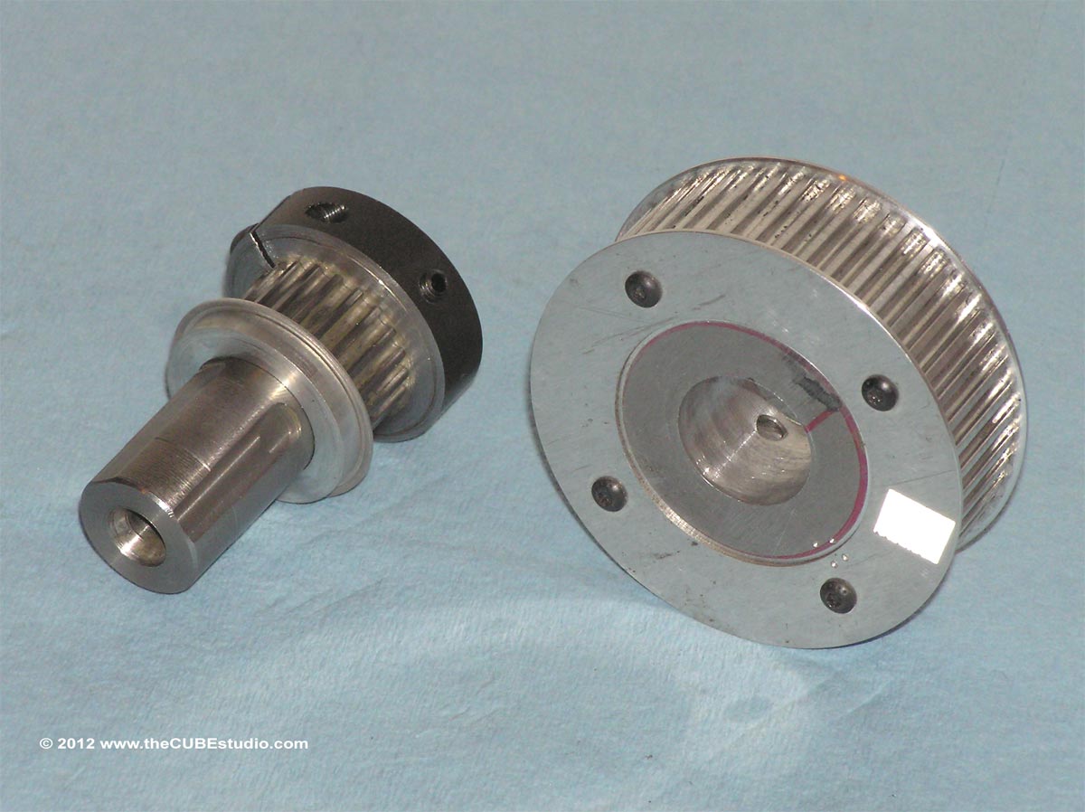

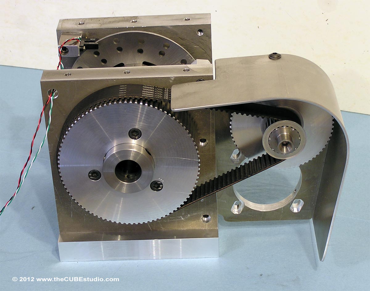

Drive parts are completed. Some more pics:
First photo shows the monster main drive pulley. Big pile of aluminum after making this guy.
Motor extension is needed to hold dual pulleys. In this case, the small pulley and the shaft are made from a single piece of steel. I am using a clamp collar in this design and there are still set screws just for redundancy. While very robust, I think it will be difficult to balance this arrangement, so it may not make it past prototype. The ratty looking larger aluminum pulley is carried over from the current prototype.
The new counter shaft is heavier and is also made from a single pice of steel for the shaft and small pulley. The bearing case is a stock item from the previous design, just put in here to show the components. A new casing with built in belt tracking adjustment will be used on the new 4th axis.

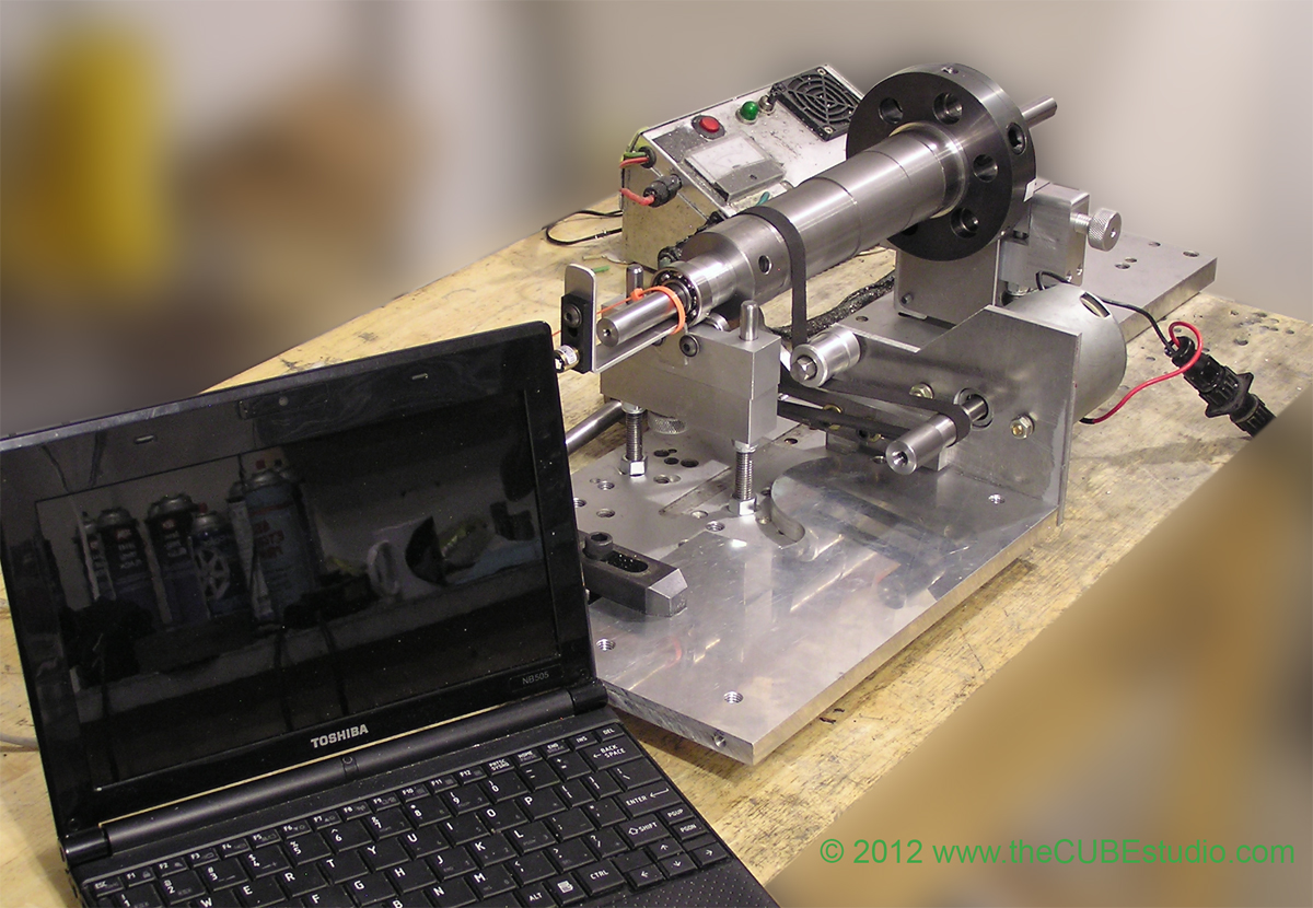

Thank you very much for taking the time to share.  You have built quite a 4th axis!  How does your balancer work?  I will have a few projects coming up soon that I will need to balance electric motor shafts.
« Reply #237 on: July 24, 2012, 12:57:31 AM »
The balancer duplicates the functions of a commercial balancer. The end support are free to swing on ball bearing fulcrums and an accelerometer measures the movements imparted by imbalance. On one end is an absolute encoder which provides azimuth data so that the exact position of the imbalance is known.
A little PLC collects the data in real time and then sends the data to the computer via USB where it is analyzed by a separate Windows program.  The data is checked for validity and then reduced to a specific relative imbalance 'severity' number and the azimuth of the imabalance. Dynamic balancers are potentially dangerous machines and you may notice the nylon wire ties which are just for safety in case the part being balanced decides to try to become 'free to move about the cabin'. For liability reasons, I do not sell balancers nor share any technical information about them. I was quoted between US$150 and 200 per spindle to do the balance, and the cheapest used (and working) industrial balancer I could find was about US$35,000 so it was worth my while to build one for my own use.
« Reply #238 on: July 24, 2012, 01:30:28 AM »

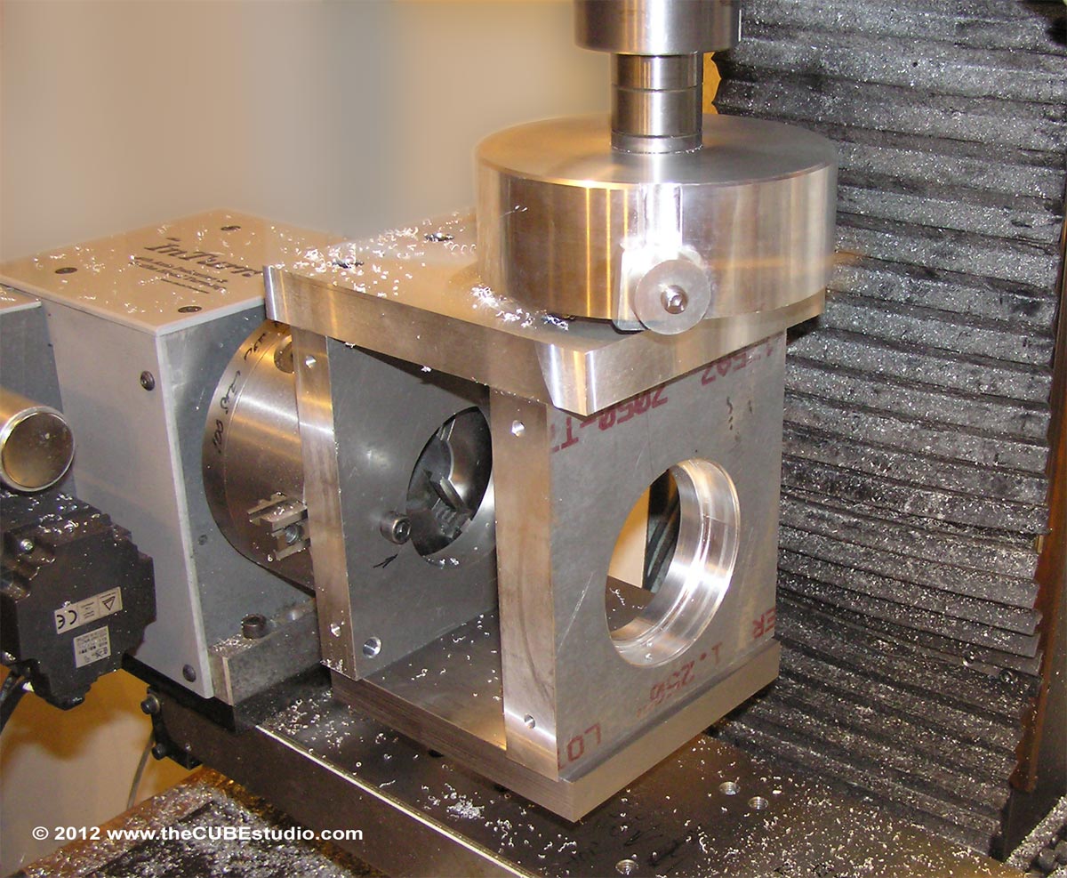

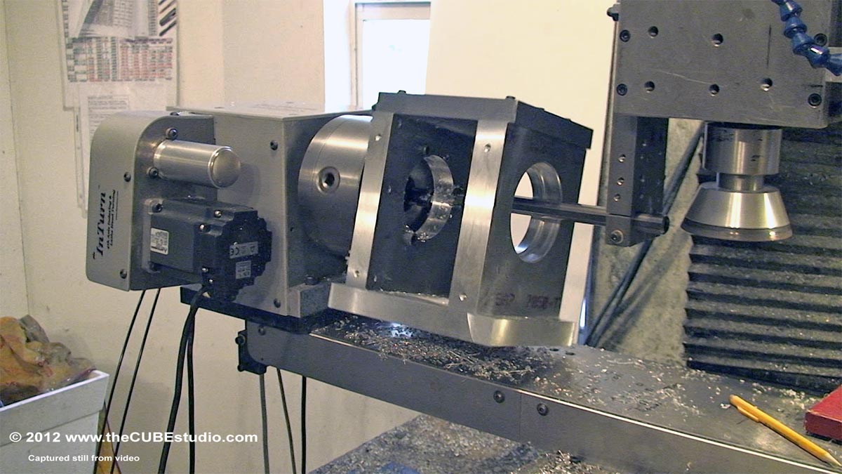

Couple more photos:

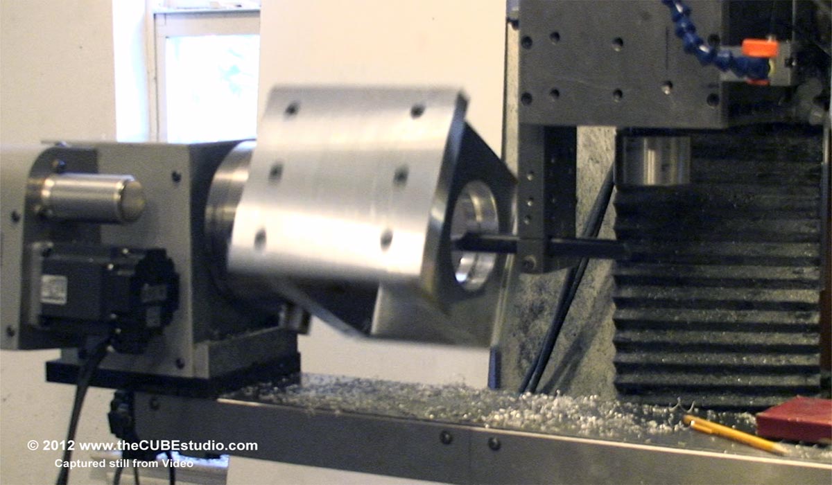

The meet spec for precision bearings, a new method for machining the 4th axis frames is shown here.
The frame uprights are bolted to the fixture (here a 6" chuck and later will be a 12" face plate), indicated and the top and bottom faces trimmed parallel to the centerline. The frame is then assembled and torqued in-place on the fixture. A heavy steel (.875" thick) top plate is installed to stabilize the frame uprights and provide a good balance for the spinning frame. The top plate is later removed and replaced with the permanent .160" 7075 aluminum top cover.
With the assembled frame in the fixture, the base is faced to be perfectly parallel to the centerline.
The pre-roughed bearing pockets are then line bored first the rear bearing:
And lastly the front bearing pocket is brought to size. The image is captured from a video so the quality is not great. When I have time, I will do a blog and/or video on the entire new machine including the new spindle and the new frame.

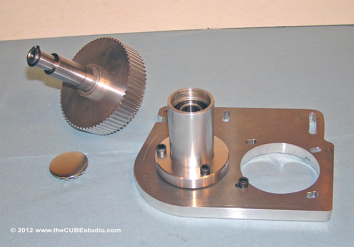

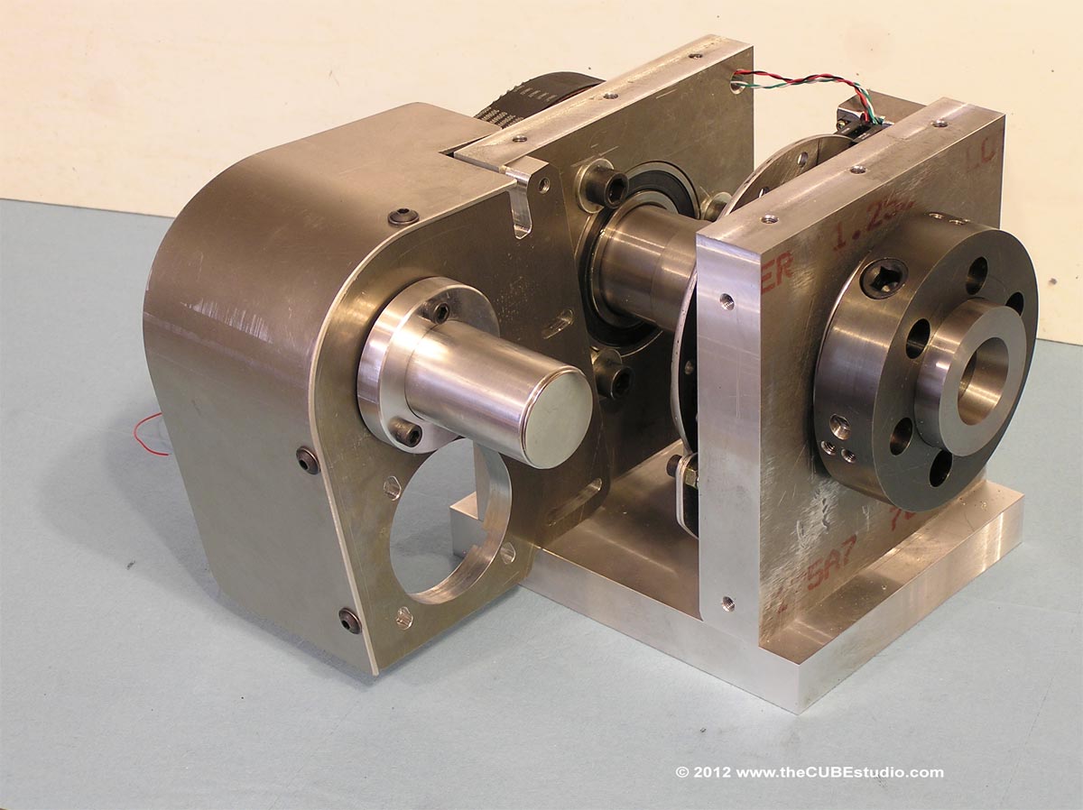

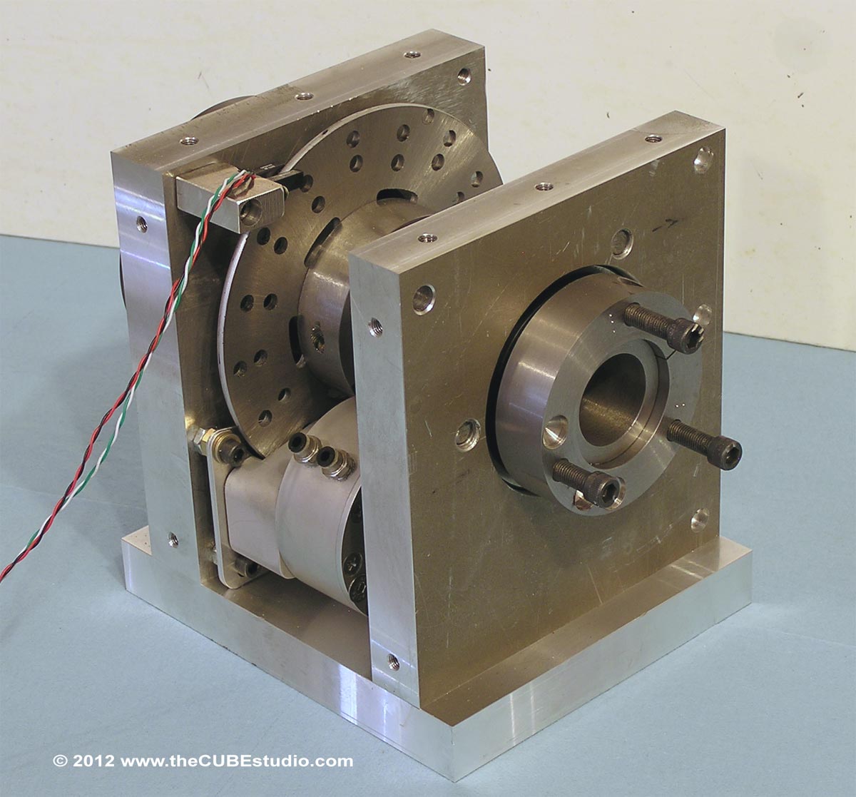

Project is just about completed. This new machine will be operational in a day or two and the current 4th axis prototype is now for sale if anyone is interested. It is the machine making the parts for this new prototype and in the latest videos. PM me for details.
A couple of interesting componenets are the belt tracking adjuster built into the counter shaft housing. The housing is mounted via a ball socket and can be angled a couple of degrees by alternate tightening of the flange bolts to effect belt tracking.
Looks like this assembled:
Balanced main drive pulley and hub. Note the drilled holes in the hub for balancing. In this close up, you can see the super straight teeth afforded by the spindle lock.
Some 'undressed' shots of the finished new 4th axis are next. The new 'Mega' 4th axis has pretty covers with the name imprinted on them, but I do not have photos of that yet.
