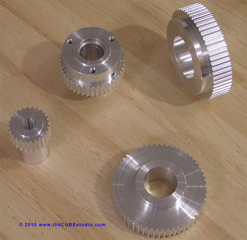

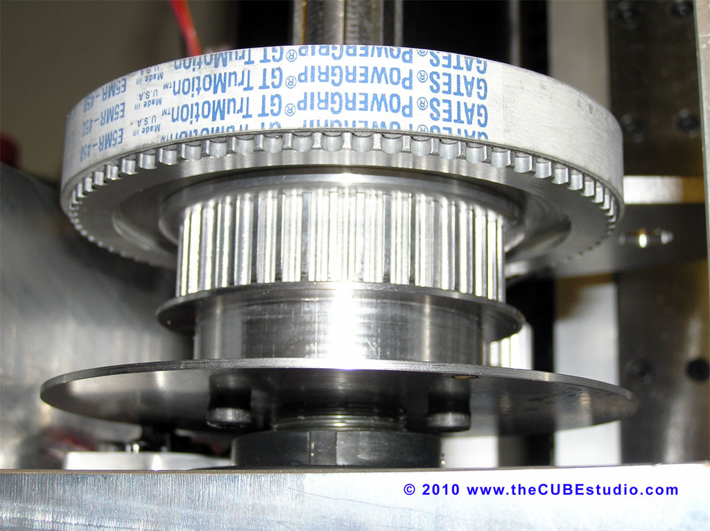

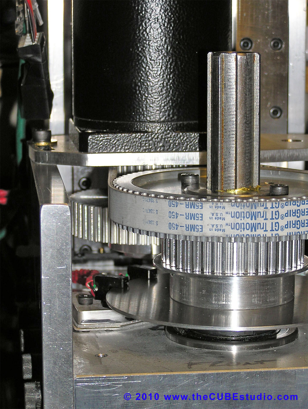

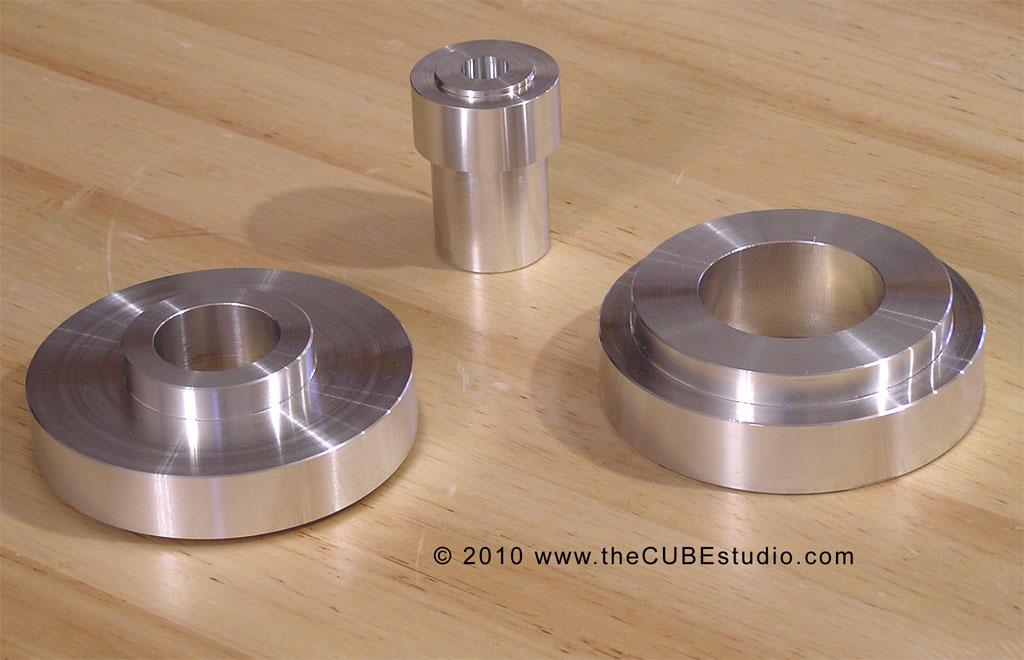

The mill is not completed yet in the photo. I later added way covers and finished the drive belts, added the spidle brake, etc. The spindle has two ranges 0 - 3,600 and 0 - 8,500
The bearings are not fully broken in yet, but I have had the spndle a bit over 7,000 RPM so far running the motor from a 10A 120V variable speed controller. The spindle is smooth enough at most speeds, but there are some 'illegal' speeds where harmonics come in. I am building a dynamc balancer now that hopefully will allow me to smooth it out more.
When I was running the motor with a servo drive, I tapped 3/8 - 16 in aluminum. I don't know the limit yet.
Here are some pics of the drive development:
« Last Edit: May 25, 2010, 03:01:12 AM by simpson36 »
