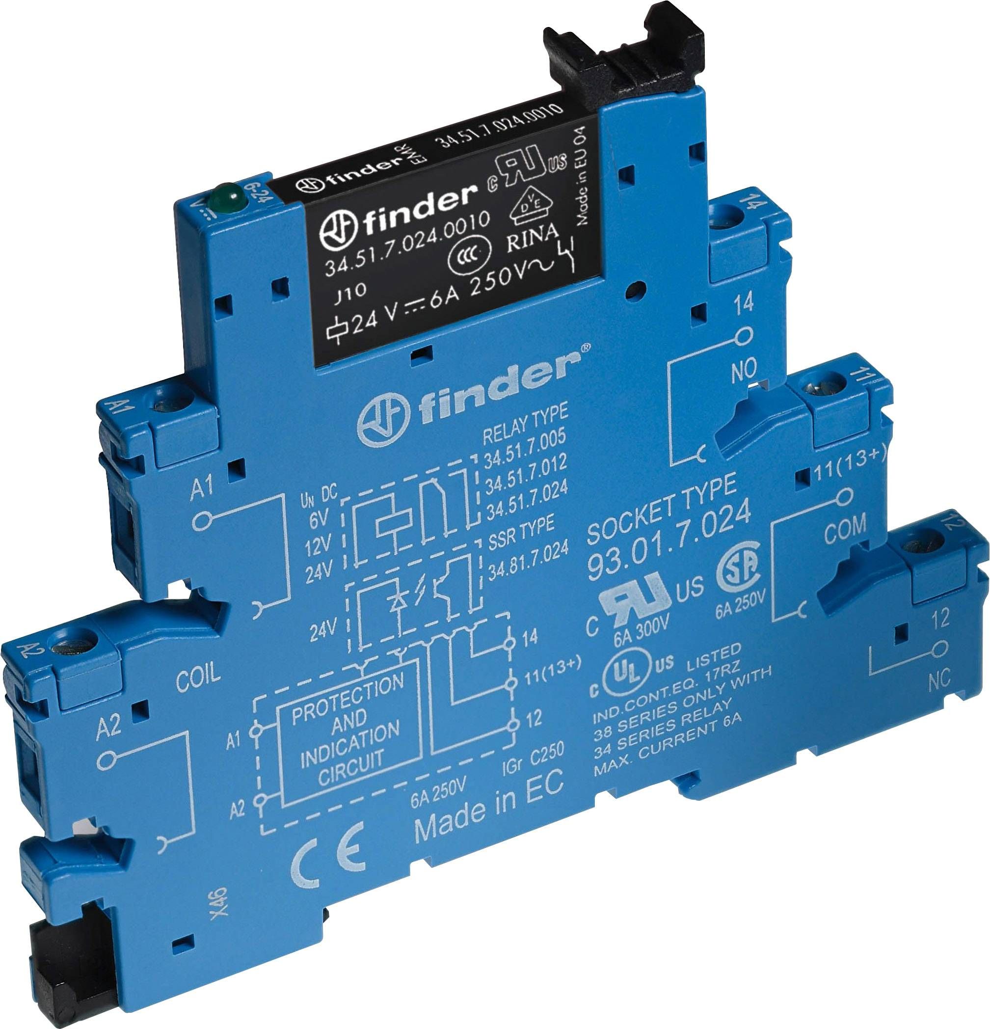

1. if you want to use more than the ENABLE Input (Reset Alm) you have to put 24VDC Relays to the outputs
from the IP-S an use the contacts like you have shown in yor second drawing.

Any hints on suitable relays ?
Once I have one working, sourcing similar ones will be easier.

for the relays i normaly take standard 24VDC industrial relays like this:
http://www.voelkner.de/products/36865/100-xl.jpg
easy to connect, easy to fit and working in thousands applications.
