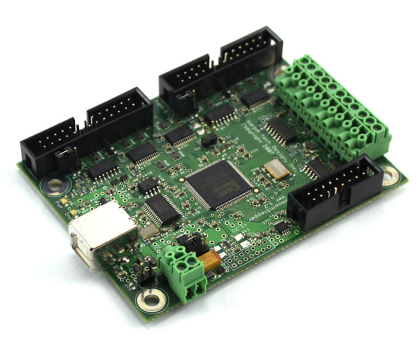

want to buy an A3 - 3040 ebay mill
whats best?
primarily want to simply cut out 3/4'' - 19mm a3 sized foamex letters
for the 6 to 7 hundred pounds, I gather .......
1. I will not get a mach3 license?
2. won't be usb?
3. will not be sliding block, but round stock linear?
4. will the controller have a sperate break out board and drivers?
5. Is it worth it as a beginner, rather than sourcing all the components and fudging?
6. coming from a sign background - does the mach3 sit in corel/illustrator on their toolbars - launching from there as a plug in, or does it require exporting as .dxf - rather than hp-gl.
thank - you.
what I 'want' is usb, servo motors and a quiet spindle, as want to use it indoors on a desk-top, can I simply swap out the parrallel to usb bob, then use better drivers so I can run it from my 64 bit machine?

Be careful............ lots have gotten bit by sellers sending out pirated software with their machines and most I think have had to completely rework their controls from what I have seen.
I'll let some of the others that have been down that road comment if they will.  I think most get burnt so bad they consider the whole experience a nightmare and generally have to do a lot more work and learn a lot more and spend a lot more than they had originally planned.

I will have to agree with Brett 110%. I have never had one of those machines (thank goodness) but most of us around here have heard the horror stories. You get what you pay for....and sometimes not even. Best of luck with whatever your decision.

Hi Nobby, welcome to the forum.
Just my opinion…
These machines are only really suitable for light duty, short duration, work.
If it works as intended, straight out of the box, then fine.
If there is a problem (any problem) the seller is unlikely to respond to your e-mails.
The maker’s warranty usually requires the faulty part to be returned ‘Air Mail’ to China and the replacement part (if it arrives) may be subject to import tax (or similar).
That said, we all have to start somewhere but I suspect you would be disappointed with the performance of this particular machine.

I know I'm late to the party, but the 3040 that I bought has been a nightmare.  To date this is what I've had to do to get it running:
The copy of Mach3 was bootlegged. purchased license
The table was not square to the spindle
Replaced all of the cables to each motor and spindle with shielded cables because of interference, one of the cables had a short in it.
Break out board fried.  New shipped from china
One of the driver boards fried New shipped from china
The water pump emits so much interference that it hangs the computer every time.
Now the spindle is getting so hot (200F) after 10 minutes that I have to turn it off.  I suspect something inside the vfd is bad
Don't get me wrong, I purchased the unit with a computer loaded with cnc router software and a couple dozen end mills for $800.  I have dropped another $200+ into it, the frustration level is high and I cant put a price on that.  Good luck
