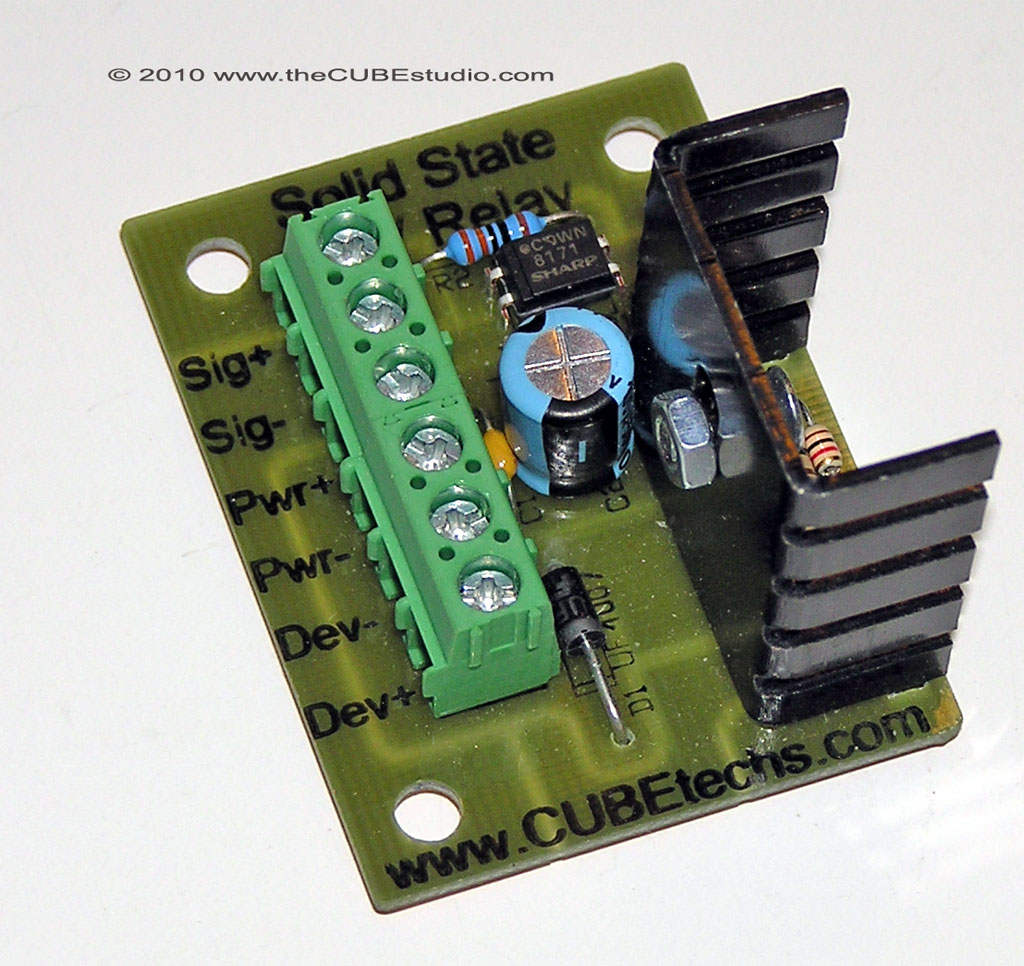

I made my own Solid state relay for high current devices (a big solenoid coincidentally);
but for run-of-the-mill stuff I have several of these little guys:
http://www.cnc4pc.com/Store/osc/product_info.php?cPath=24&products_id=133
Solid state. Fast, silent, work great with MACH. For 8 bucks, it's not worth getting out the soldering iron . .
Just watch your current draw and make sure you use something that can handle it.
They have a nice selection of BOBs as well. I use their C1G . . .  love the status LEDs on each pin!

Im planning to move a 24DC motor in a new CNC Project.
I have a Hobby CNC pro controller and a C9 DC Solid State Relay from CNC4PC capable to drive from 6-60dcvolts motor and 10 A.
My plan is connect Relay to Pin 1 in CNC Controller, and activate in this way,
My question is.
Is necessary to connect some device between  Pin 1 and  5VDC  Relay connector?
Thanks in advance.
