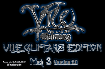

Re: OEM Mach 3
« Reply #4 on: September 12, 2006, 08:05:21 PM »
I made my own Mach screen and just like Benny said droped three of them in the bitmap file, "Splash.bmp","Splash1.bmp" and "Splash2.bmp".p
BUt I would never hide the icon and make people think it was any other program but Mach.

Re: OEM Mach 3
« Reply #8 on: September 12, 2006, 09:56:52 PM »
I used Firework to create the splash screen, it took about a minute to do. If you want one with your logo(or I could just use text with some steel effects) email it to me. If you have an idea of what you want it to look like send a description. I'll have sometime tomorrow to do it.
I've work with creating Icon's, so you could turn your splash screen or logo into an icon.
For the splash screen you just over write Mach 3 bitmap pictures with your own.
