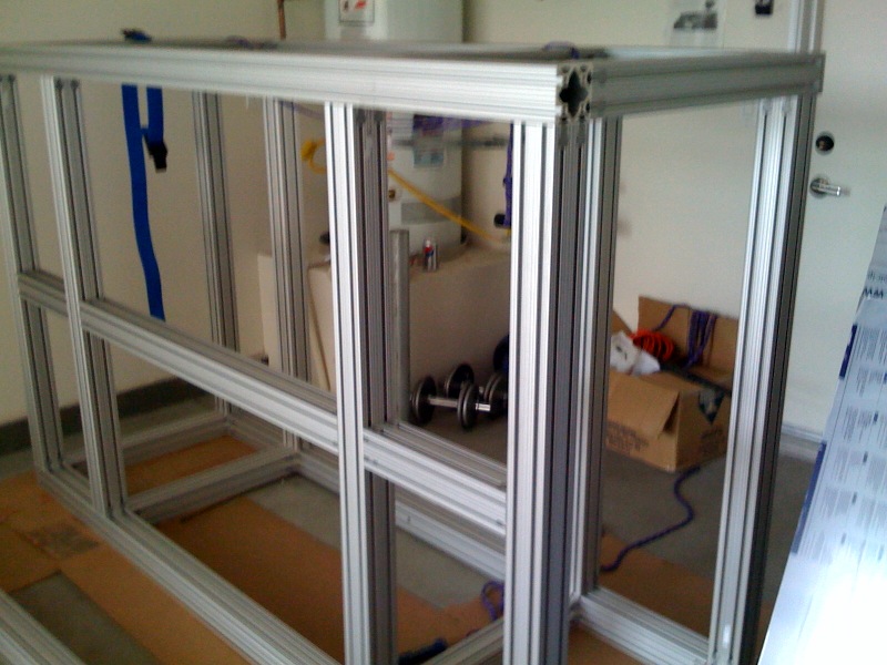

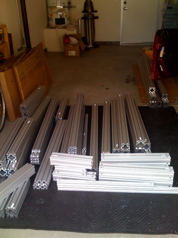

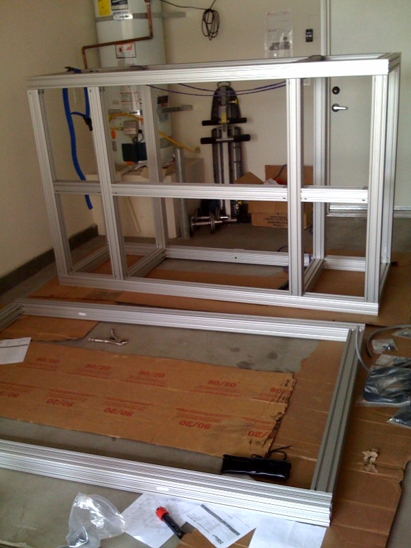

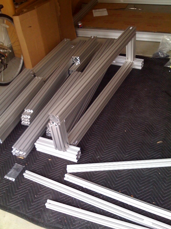

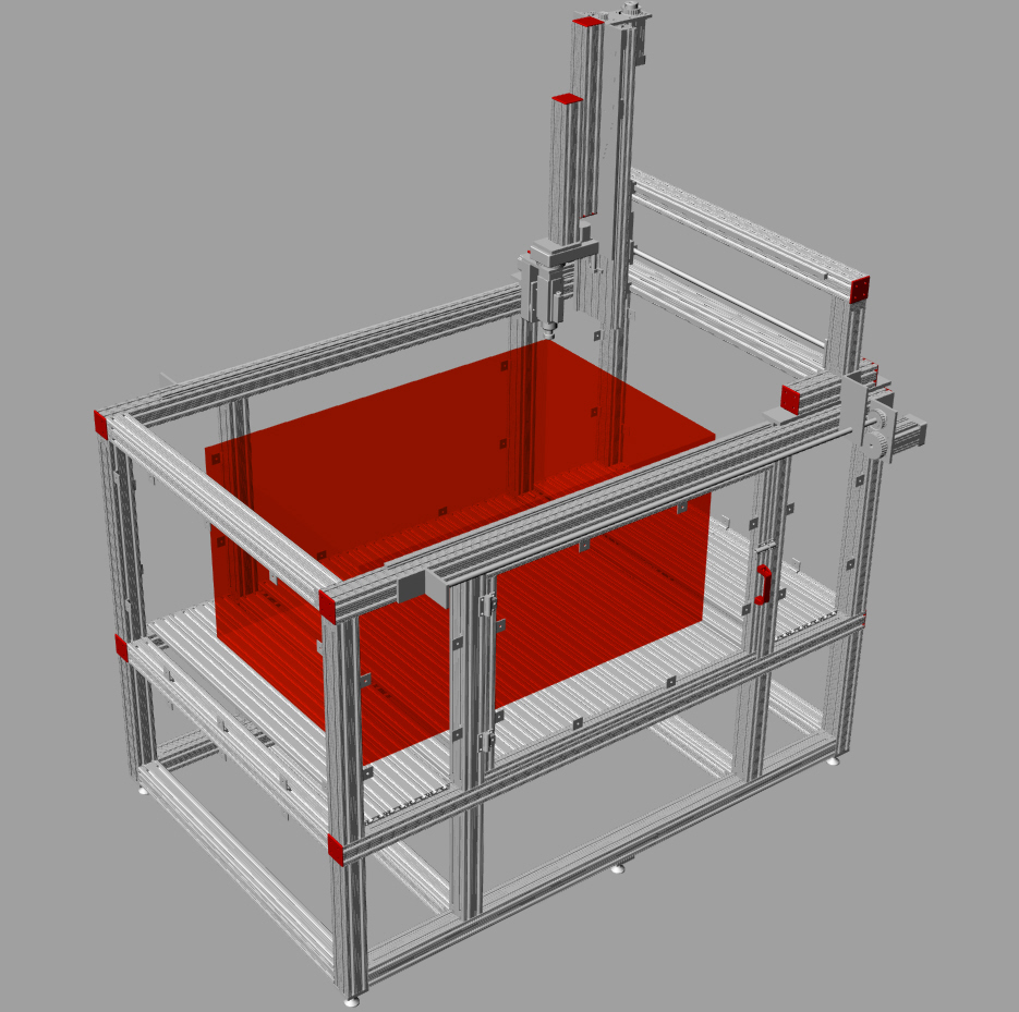

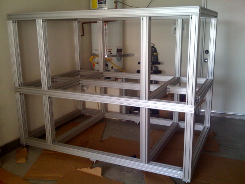

Hey folks, thought I'd show some progress with my design.  I've got the frame getting set up which is pretty cool.  The electronics are all done, just getting the frame and mechanics set up.  The rails are ordered (hiwin) and should be in, in about a week.  I'll be ordering ballscrews this weekend.  Next, I'll be machining some custom plates to hold it all together.
Anyway, first image is the my CAD design, then comes the frame in it's somewhat coming glory.
Barry

I've got the t-slot table on now, as well as the door built.  The spindle and rails have come in, but I haven't ordered the ballscrews, and end caps yet.  I'll do that this weekend.  The shipping dept at my work didn't like handling the rails when they came in.  They are really heavy and awkward.
The rails are from automation4less.com.  The spindle and VFD is direct from HSD USA.  If you plan on ordering from HSD, plan on hand holding it all the way through.  I can't tell you how many times I had to call back, and they lost my order more than once.  I don't think they are used to dealing with small shops.
I'll post a pict this weekend with the door and t-slot table done.  Btw, my machine should be 6 axis eventually, as I'll mount a sixth axis on the table, but for my initial build it's 5.  That should be enough for now;)
The build is going slow as I do have OT for my day job.  Soon I'll be able to devote more time though.
Barry

Where is your 4th and 5th axis,  I see the two motors for your X, and the two motors for your Z, and the one for your Y,  but where is your A rotory, and B rotary?  are you slaving your X motors?, you have a double Z, will they operate independantly or slaved?
Do you mean five axis cause you have 5 motors?  Usually the 4th and 5th will be a rotational axis each around one of the other 3 linear axis....
You said you are using Metal sheeting to bolt to your Extruded AL, how do you like working with the AL, is it high priced, how stiff is it?
I like your double Z, will your CAM write to a Z and a W for the compound Z axis?
You really did a super nice job on that AL frame.......  Man that looks great!!! Are you for hire?..............heheheheh
