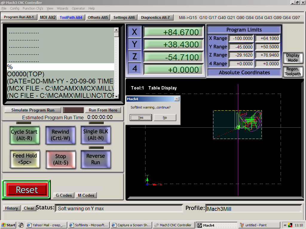

Yeah I've tried version 2.0.005 and I'm still having trouble with the tool offsets and now X and Y, have a look at the screen shot below, it shows how far away I am from the soft limits but I'm still get a warning. :o
Hood if you put a tool offset in, large enough too send the machine on to it's limits do you get a warning?

Chris
 not sure what you are meaning, radius comp or length offset? Also version 2.0.005 was changed without a version update, have you tried downloading it again?
DrStein
 Limits are there to stop the machine if they are triggered. If yours dont stop your machine they are not set up right. If you press them manually does your Reset button start flashing? do you get the LEDs for that axis lighting on the diagnostics page?

I meant the tool Length offset, I'm not sure what you have got your softlimits set to but I guess they will be about the same as mine with it been the same machine, anyway try this if you would please.
Set G54 Z offset to -200 & T3 to +200, this is presuming your soft limits in Z are roughly from 0.0mm to -127.0mm, then run this.
G21
G0G17G40G49G80G90
T3M6
G0G54G90X0.Y0.
G43H3Z-1.
G1Z-10.F1000.
M30
When I run it I get a Soft warning on Z min. Just want to make sure it not just me.
