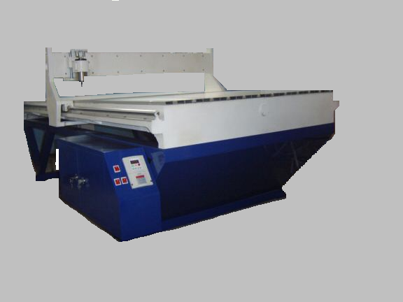

Hi, Enytned1
If You put all 6 Limit switches in series you can use 1 Pin for all including Home when Mach is setup rite.
I have a Dayton Router 4 X 8 gantry, all switche's on one pin.
Thank's Chip
