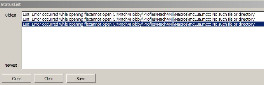

Just another parrot.................. found this in my notes. Hopefully its useful to you.
> Lua: Error occurred while opening file cannot open
> C:\Mach4Hobby\Profiles\Mach4Mill\Macros\mcLua.mcc: No such file or
> directory
> I looked for this file in the install directory, and sub directories
> and could not find it.
This means that a script in your macro directory has an error.  The mcLus.mcc file is built from all of the *.mcs files.  It is like building a EXE.  .cpp files make .obj file.  Then all .obj files get linked in to make the .exe. So in the world of LUA, it takes all of the *.mcs files and compiles them into *.mcc files.  If all of that works without an error in one of the *.msc files, it links all of the *.mcc files into the one big chunk file that we call mcLua.mcc.

Posting here because I think it is related to this thread.
Getting this error. fresh install of 2214. How is this possible? Shouldn't MACH4 just recompile and make a new master?

 I had that once different version I just remove all .mcc file from the macro folder and it came right

I did a fresh install of 2214 to a new folder (C:/Mach4/) and it is now running G-code.
The other install (C:/Mach4Hobby/) had been written over with new revs a couple of times and had a smoothstepper ESS installed at one point and also TCP Modbus. I removed the smoothstepper plug ins and disabled TCP Modbus, but nothing worked, so I did not know what the problem was.
It appears now that MachMAD is the culprit. The install created an other profile and McLua.mcc is no longer present in the original profile, but does exist in the new machMAD profile. Apparently there are some steps that I missed in the MAD install.
