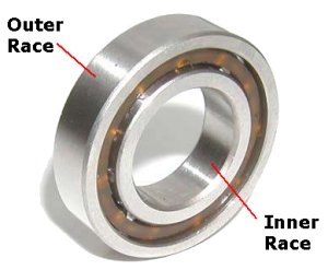

You only need to shim between the bearings (outer race) if tightening the nut will not take out all the slack between the bearings.
Just in case I need to shim down the line:
When you say to shim between the bearings I will assume you mean the two bearings inside the pillow block
But what do you mean by (outer race)?
Nicolas
Re: Antibacklash Nut
« Reply #16 on: September 18, 2012, 11:24:15 PM »
http://www.motorera.com/dictionary/pics/r/race.jpg
Placing a shim between the outer races increases the distance between the inner races, and allows more slack to be taken up from tightening the nut.
