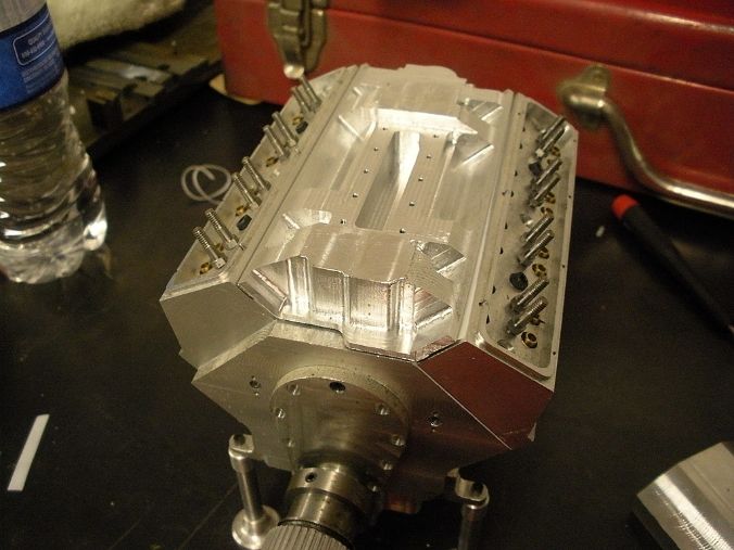

I got rained out at work today so I took a few hours in the garage. I guess this would be the official kickoff of the Version 2, Small V8. It is the same engine with a roots blower. I would guess this one will go a bit faster than the first but the way work is I don't know if I'll get back in the garage this month, or next month.

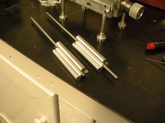

My friend Ron wants to bend the tubing in his new bender for the zoomies so i made the flanges today. The last time I made them I drilled and reamed the holes for the pipes. That didn't work well in .063 thick plate so this time I milled the holes .010 smaller and then reamed them to 5/16. Still not perfect bit I am alot happier doing them this way.
Re: 1/5th Scale V8 Blown
« Reply #16 on: December 15, 2011, 05:20:05 PM »
I finally have something to report. My friend Ron fired up the tubing bender and I made the flanges and then he came over to silver solder the pipes together. Unfortunately this will be about all for a while. Still working too much but I hear it might end after the holidays.

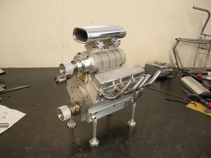

« Reply #17 on: July 13, 2013, 09:38:15 AM »
« Reply #18 on: July 13, 2013, 10:27:01 AM »

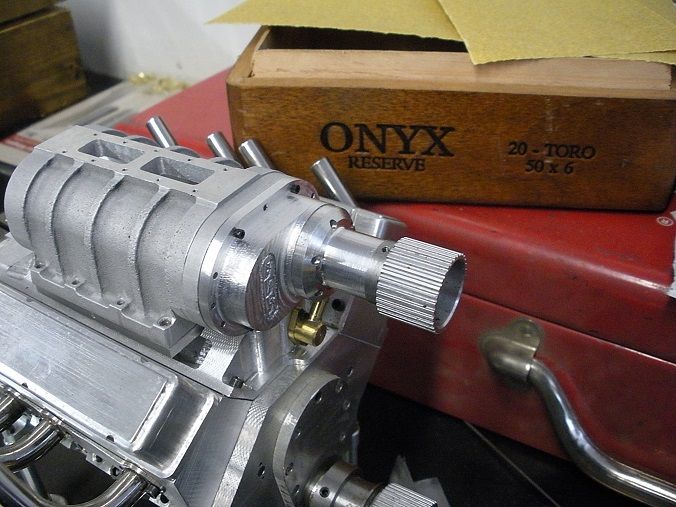

Is that a cast housing?
What are you using for timing gears
How much boost do you think this will produce?
Nice job, looking forward to hearing it ROAR.
« Reply #19 on: July 17, 2013, 09:54:00 PM »
Yes
Timing gears
5Lbs
Thank you
