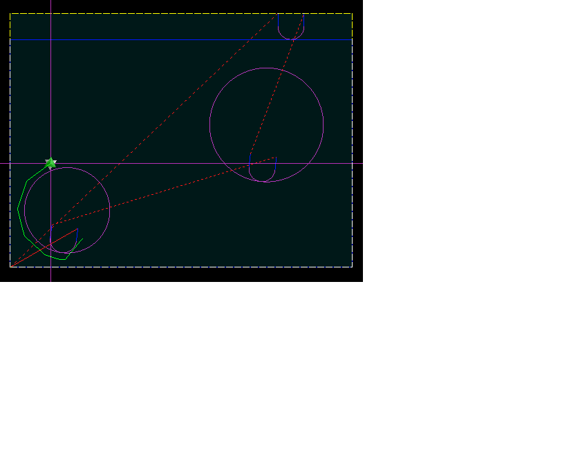

Hi, Brian
While working with another user on Current ver of LazyCam.
It appears that the G41 and G42 are reversed when being generated with the G(Mode) command..
This is in Default Mode, There dosent appear to be a way in User.pst to change this.
The two .tap files i've changed the G41,G42 around and Rem the Post ones out.
Mabey it's somthing else wrong as i havent used cutter offsets much.
Thank's, Chip

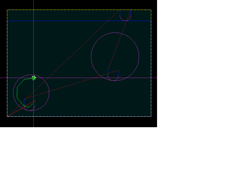

Re: LazyCam ver 2.64 and G(Mode) generation of G41, G42
« Reply #2 on: September 04, 2006, 02:08:51 PM »
Thank's Brian
Hear are 2 views from Mach3.081, I no there are allot of people using offsets with it.
In the View 1 below, climb is off, corrected G42 instead of (G41 as LC posted) the cut is now inside and is to the right side of line cutting in non climb as it should be.
If you leave the LC posted G41 the view shows (inside cut) but the offset is applied to the outside as seen in view 2 the cut is still non climb but doesn't agree with the leadin.
Thank's Chip
