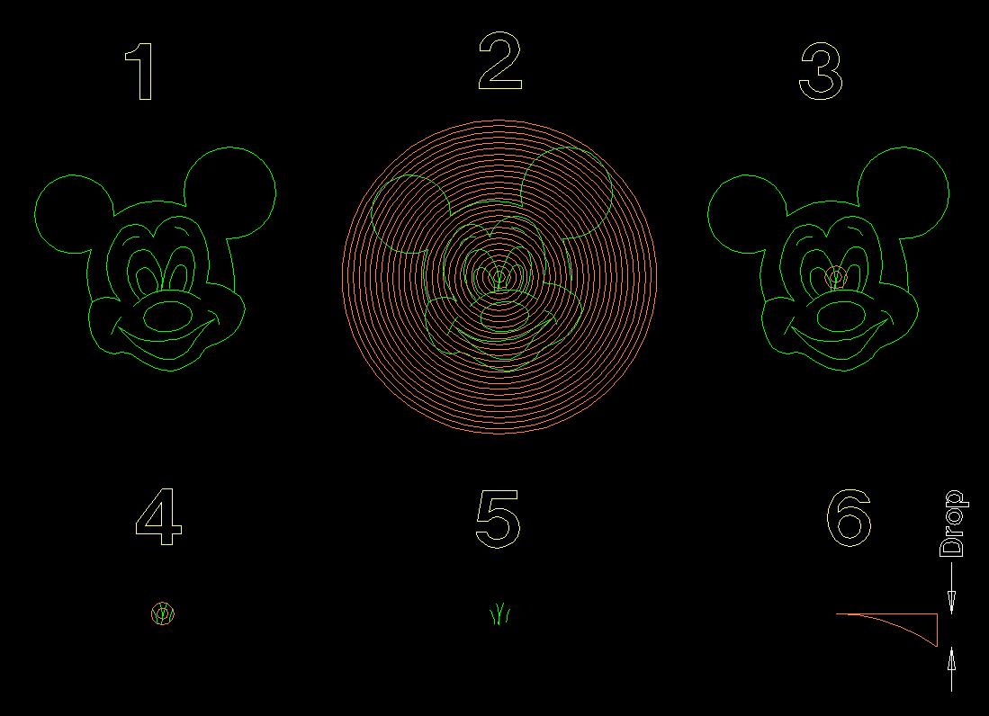

Now that makes sense.I guess then the trick is how to index the information contained in each circle of interest.Maybe one circle per layer?

This is an example of the old way we used to do things.
See picture attached.
1.  Original image centered about X and Y zero.
2.  Circles drawn at a known pitch.
3.  Pick 2 circles to work between.
4.  Remove all the bits inside inner circle and remove all outside outer circle.
5.  The bit we machine and generate Gcode for.
6.  work out the drop using trig and add this to the Z created in the Gcode.
This is not the perfect way to do it but it works well enough for most jobs.
Regards
Graham

I gottcha ,Graham.I like this way and since what I want is high contrast ,any discontinuity will just be part of the randomness.What I think I would do is  outline the high contrasted image in Rhino.Draw the circles and then 'trim' the first area of interest and save it as a layer and then continue to isolate each circle and save as another layer this way,generate the gcode from importing it as a DXF and then do the trig to insert into each layer's z-cut.Thanks a million.-Keith
