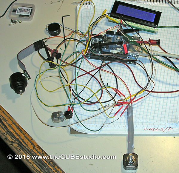

You guys have passion and are excited about creating products for MACH4. New blood and new ideas being posted is exactly what this forum needs. I do not have time to do development threads at this time, but here I will post a bit about my projects in hopes that it will inspire and encourage any of the new members to strike out either on their own or in collaboration.
Any of you can send me a PM with info on a new thread and I will participate as my schedule allows . .  which is not very much. Please do not send me questions via e-mail. Post here and I will answer if I can.
Here is some info on my current projects. I will provide more information on the Arduino question and Modbus question in a separate follow-on post.
I have two projects that involve the Arduino; Porting my 4th axis motor controller to MACH4 is completed. This is the controller: www.theInTurn.com The ported version looks the same . . just TCP instead of USB . .  and there are several added features.
Edit: Oops! I forgot to mention a new processor. Moving from the Arduino Mega to the Arduino DUE

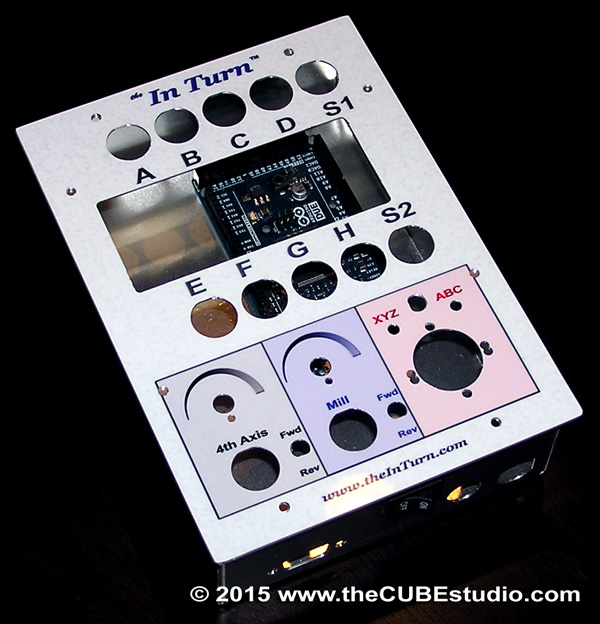

The second project is adding 'super pendant' capabilities to the controller. That project is nearly complete. I am currently assembling the first prototype by neatly ( as much as is possible) combining this rat's nest:
and the rest of the components into this new panel [1st proto . . will probably change], which fits the existing controller box (for upgradability):
So there you go. Now get your own threads going with your projects!
