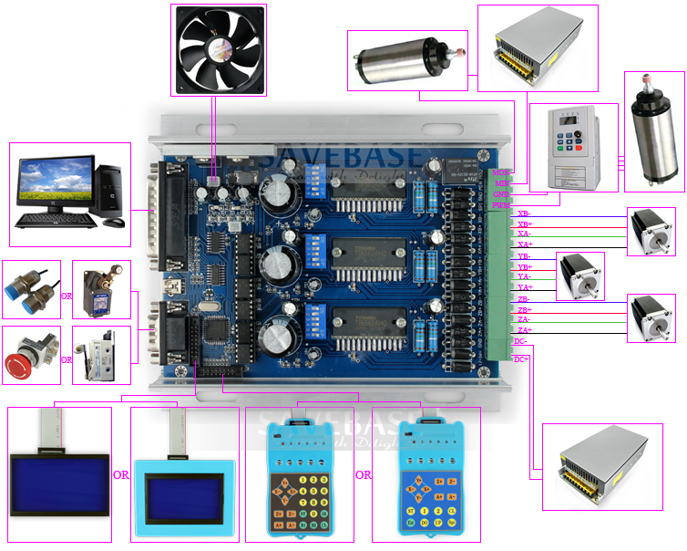

could someone help me with where and how to hook up the home switches on my controller. this is the one I have now, I just need to know where to get some switches and where they go..thanks.

They attach to the connector on the left side at the bottom of your pic. Looks like either a 9 pin or 15 pin connector.
The manual for your board should have the pins labeled.

OK, It's a DB9. so do I just get an old DB9 cable and cut it, find the wire for the pins I want to use? And as far as the switches go, can they be one of those little micro switches I can get a Radio Shack?
I might check out ebay for the switches too, That way they'll have some type of holder with them. Sorry to ask so much about this, but I'm in hopes that this will keep my zero position saved for me.

Also, can you hook up the switches in series or does each one need a separate feed from the connector?
