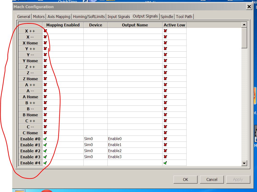

MACH Config - Input signals tab - first column is not resizable - text truncated
Don't see it here...
The issue is also present on Axis Mapping, Homing, Input, Output and Spindle tabs.
By 'first column, I refer to the gray colored column that has, for lack of a better term, the 'titles' for each line. This column cannot be resized on my system. Some of the 'titles' exceed the available space and are therefor truncated. In most cases, this is not much of a problem, but some of the titles need to be guessed at, which is not a good thing.
They ALL drag and display properly here, top row as well as columns.
Dell laptop
XP SP3
Russ
I do not understand what I could be doing wrong, then. No matter ho slowly or carefully I float
 the cursor over the vertical line between COLUMN 1 and 2, I do not get the expand cursor as I get with every other vertical line between COLUMNS.
To make sure we are on the same page, I am attaching a screen capture with the first column circled. How do I make this column wider?
