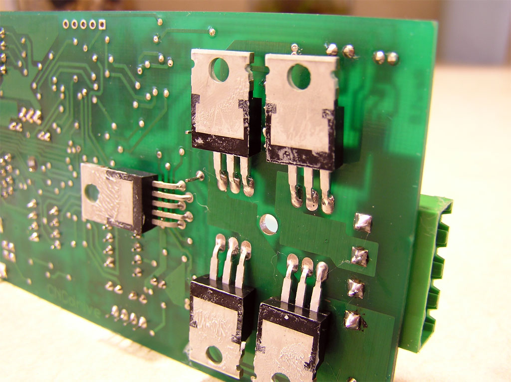

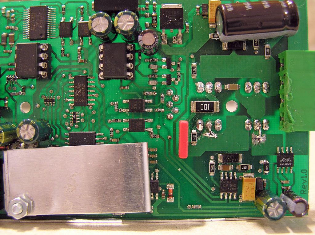

Just as an interesting note: because of my own mistake, I killed the Whale3. But with detailed  instruction from the vendor, I was able to repair the drive!  ;D  This is what happened:
I was testing all of the servo drives with a variety of motors and one was a 35V NEMA23 which I ran with 72V thru a 1ohm wound power resistor in series with the motor. At first power up I had the leads reversed and when I changed the wiring in a relatively inaccessible area, I ended up with the motors leads connected to each other and the Whale3 outputs connected to either side of the resistor. Not good.  The drive tolerated this abuse for (as a guess) about 20 seconds before vaporising two traces on the board. I corrected the wiring and fixed the traces, but on power up, the fuse on the main PS popped indicating a dead short in the Whale. I have a little bit (enough to be dangerous) of prior experience with MOSFETS and knew that they fail shorted, SO that was my "electronics for Dummies' level diagnosis. I removed the MOSFETS and sure enough three of the four were shorted.  :'(
So informed CNCdrives what I had done and told them I did not expect a warranty repair, but would appreciate any advice they might be willing to share. To my surprise, I got a very detailed instruction on how to trouble shoot the problem, track it thur the drive, and what parts to replace (including part numbers) and in what order!  I'm no electron whiz, but I CAN follow instructions so I bought  the parts ($6 total). I've done plenty of desolder/solder stuff, but never any SMD, so I watched some instructional vids, bought a temp controlled iron and some other SMD tools and practiced on an old VGA card and some memory sticks. Parts came, fixed the drive and its running fine!

Hi Simp'36,
Yup, nice job on the repair, hope those tiny wenie little critters with 471 marking don't need changing, just look at the size of them compared to the 8 pin DIL package... we'll need a soldering iron the size of a pin !
I have done some SMT work myself and hand soldering that stuff is almost as hard as the strain on your eyes.
Yep, them there were the SMDs that needed to be replaced. I got away without changing the 'legged' SMD IC chips nearby as they were OK. I got instruction on how to check them out with a scope, but I only have a software scope and I have used it, but don't really know what I'm doing with it. So the SMD ICs 'check out' came with power on and see if the motors move . .  :-X
