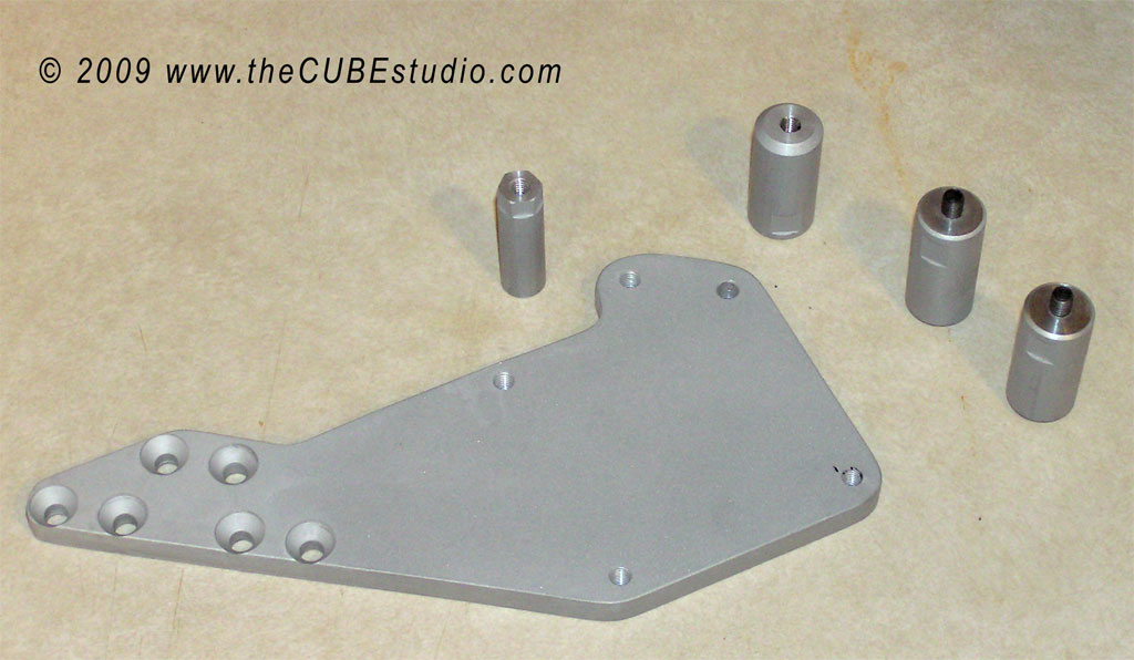

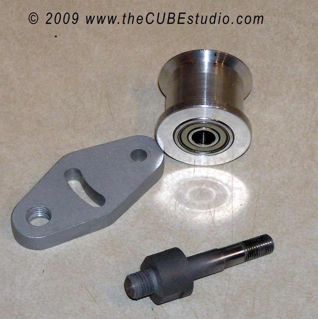

Viper servo drive is on order. Should allow me to use the full power and speed of the servo motor with the 1,800 line encoder.
Design is finalized after about 3 iterations. Here are the first final parts: the motor mount and the belt tensioner.
With the Viper and permanent motor mounting and belt drive, I'll stop and do some more testing and post another video.
Then it will be on to making the permanent spindle head.

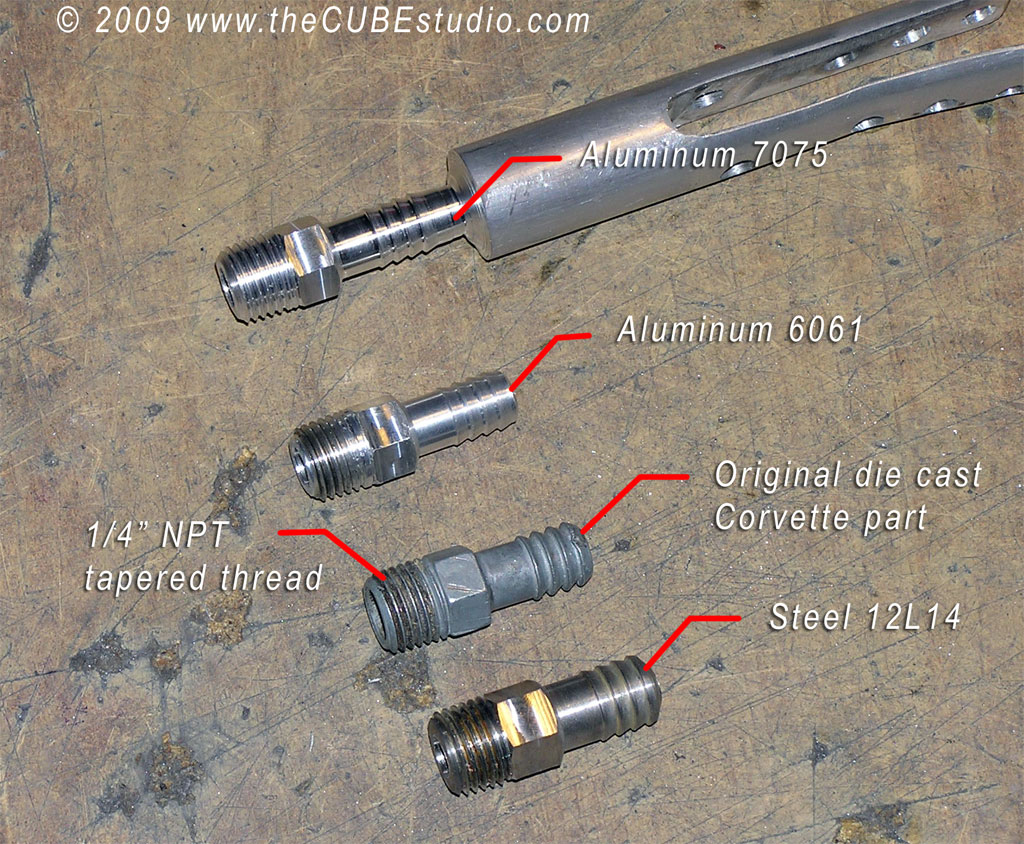

That is very cool!  And just think how much money you can save by making all your own bolts from now on!  :-)
This is one of the parts I had in mind to make when I was messig with code to make the 'bolt' . The latest iteration of the 4th axis made these with a single program and one setup, including tapered NPT threads, hex flats, the thru hole and cutoff. It's coming along . . . .

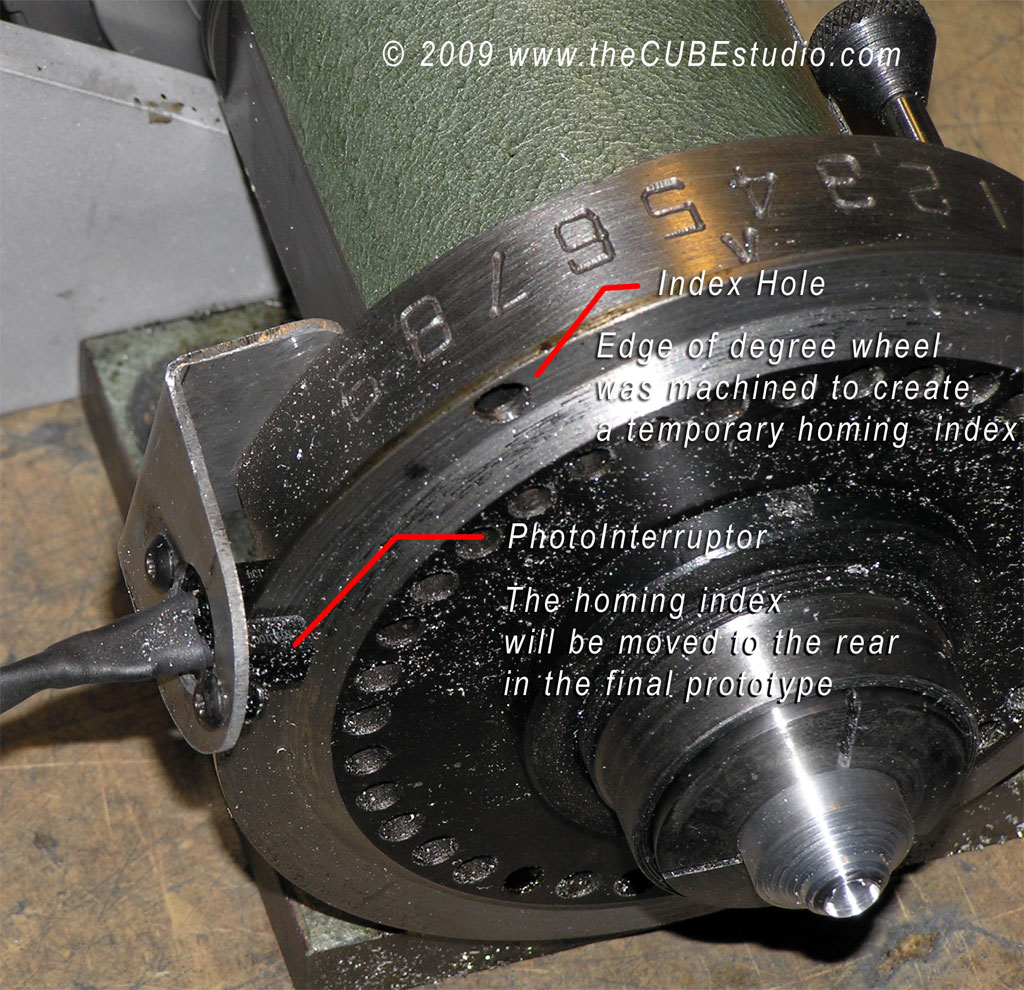

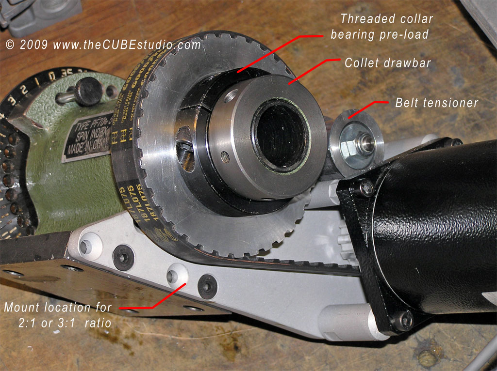

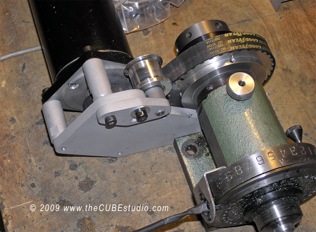

OK, I'll be making another video soon. Very cool as you can clearly see the swap-axis and re-homing functions as it makes the part in the previous post. For now, here is the final drive mechanism. This will be moved over to the new head once I have that built:
Poor thing after many hours of abuse:
This is still one of the last temporary 'get-er-done' quickie that needs a final design:

Special thanks to Hood for the re-homing info.  Also Vmax, RayL, Machinemaster, and others . . .

One last note. THere is room in the housing to install oil seals. Then you fill the shaft area with 90 weight gear lube through the port on top (lockdown screw) It will run a very long time without wearing out. I use a simalar setup on  special grinder application where the indexer has to rotate at 60 rpm continuously while grinding.
Just a thought, (;-) TP

Vmax, I recall you mentioning that before. I have installed needle roller thrust bearings on each end, those are neccessary for operating as a spindle and they actually peeked out past the surface in one spot . You can see the oil leaking out at that spot in one of the photos. If not for cutting the ends for the thrust washers, I could do as you suggest.
A new servo drive (Viper) and a little more voltage should get the 4th axis to a max of 2,500 RPM with a 2:1 ratio. Sustaining that speed for hours on end would cause trouble with the setup you are suggesting. At a minimum, it would consume a lot of power and I don't have so much I can give it away to a plain bearing or to a non bearing thrust. Used as an indexer or at low speeds, I agree with your assessment.
A full ball bearing head with sealed bearings is the way to go for a reliable zero play spindle on a budget, methinks. I'm going to 'ghetto' it a little with just some quality SKF 'Precision Plus' bearings and not angular thrust or high precision. No point with the current machine that flexes all over the place anyway . . .  :-\
