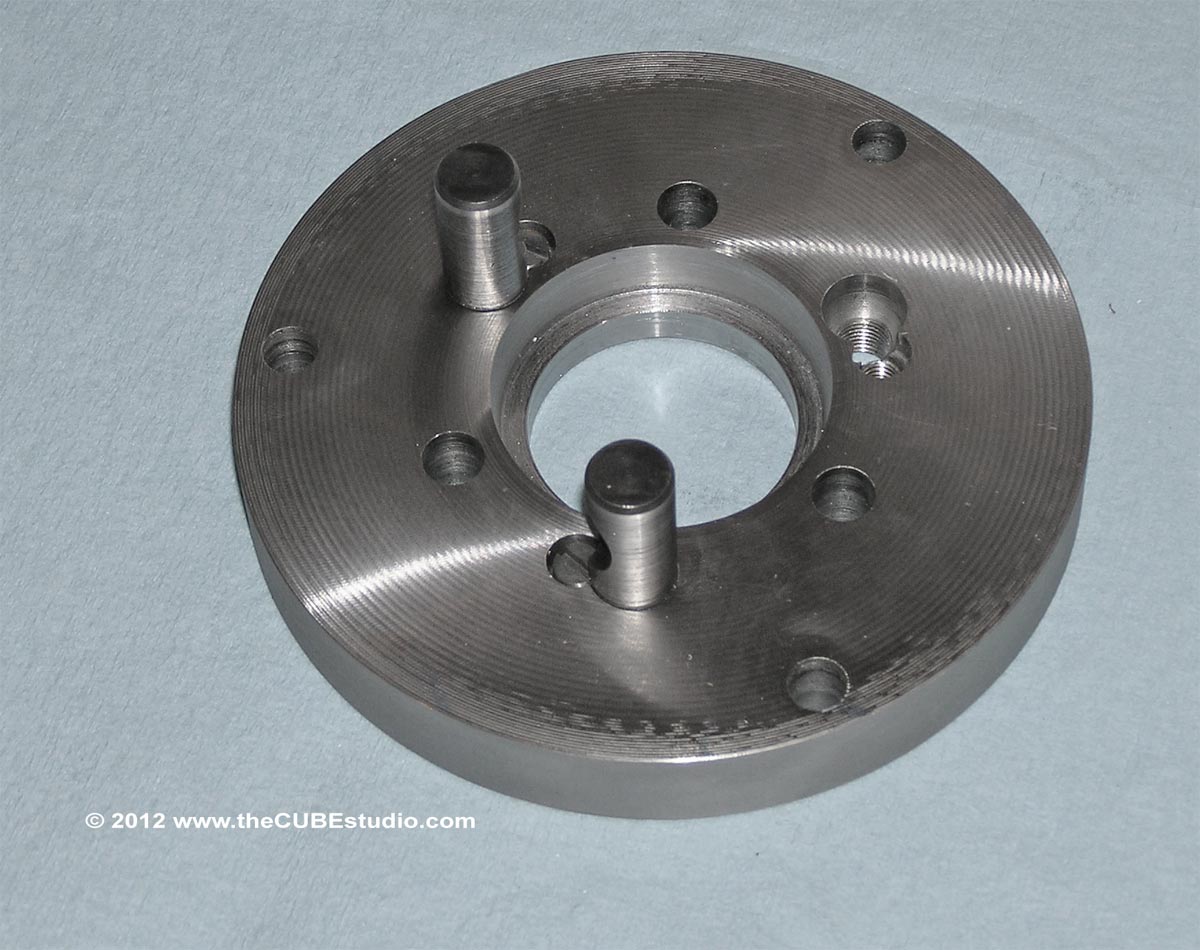

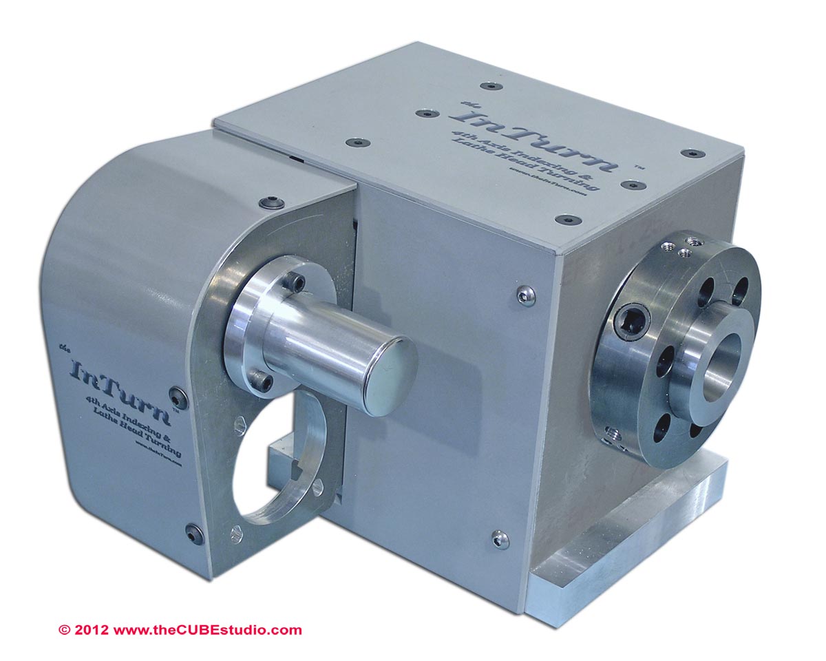

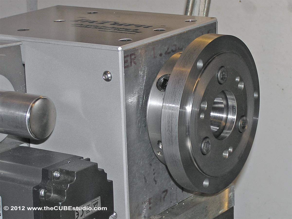

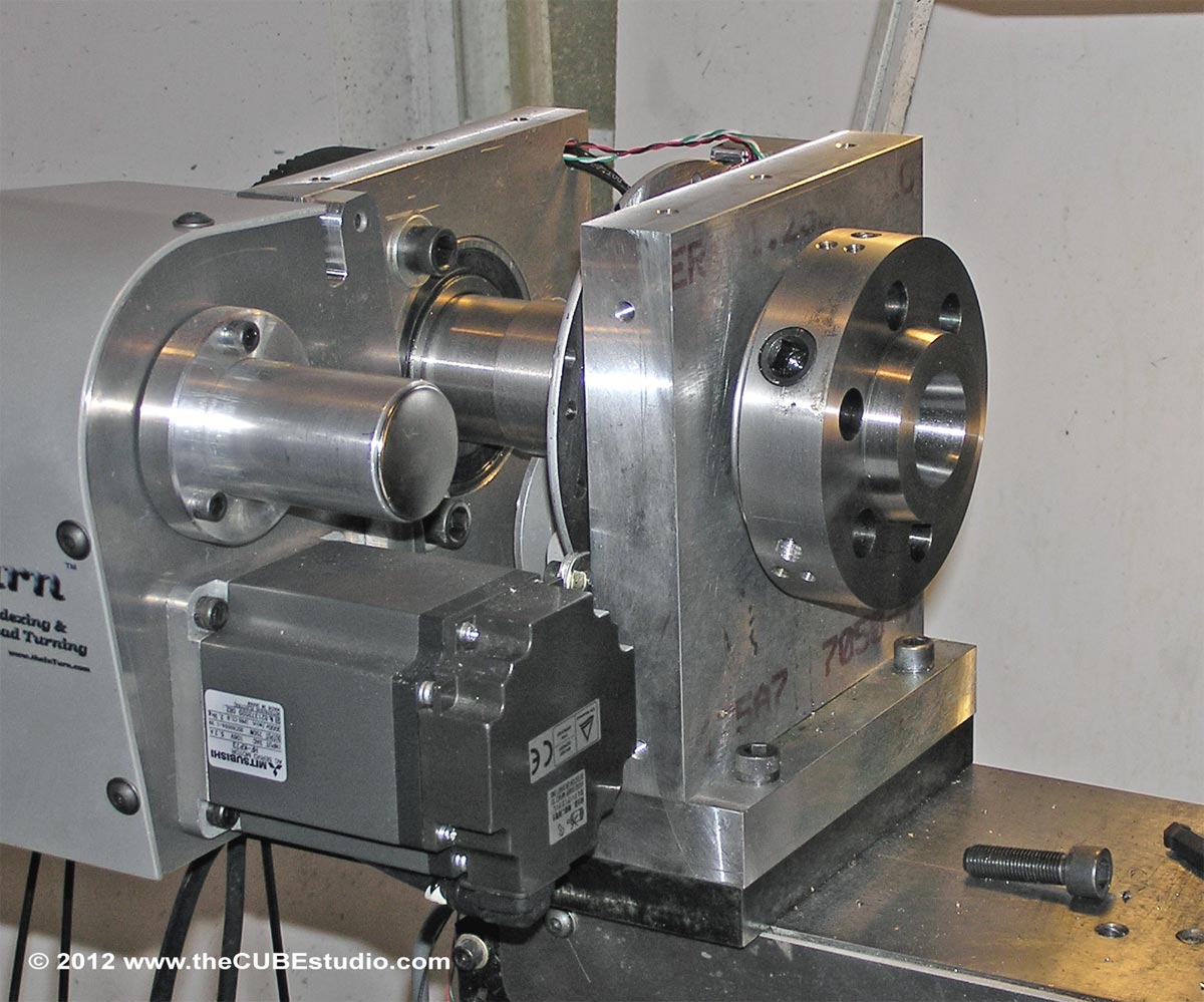

Yes, the new 'Mega 4th Axis' has the Servo motor from the previous prototype. It is now installed and has begun its working life.  The last steps were to to drill the base, drill a couple of additional holes in the outrigger plate (the 'Mega' is longer), align the machine, do the final cuts on the tapers with the machine installed and under its own power, mount the D1-4 Chuck adapter and then cut and final grind to mount the 6" Bison chuck. I also now have a balanced 12" cast iron D1-4 mount face plate.  You can see that piece and also build details and install details in an upcoming video.
Here are a couple of selected final shots to finish the update to the thread. First is the in-place cut of the tapers:
Next is a shot of the ground cam-loc face of the completed D1-4 chuck adapter:
THe completed adapter is then installed on the re-cut spindle and then rough cut and ground to receive the chuck:
