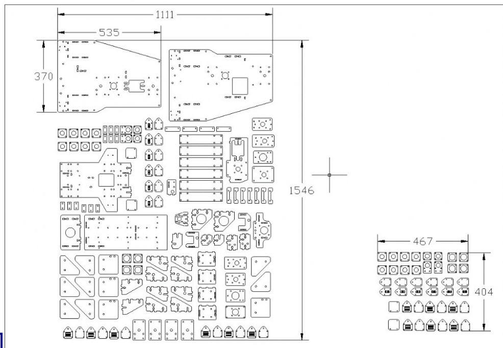

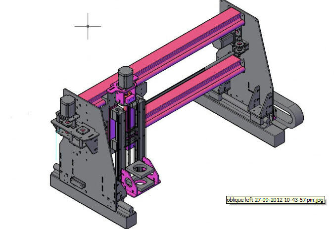

It was designed using Autocad in 3D a commercial program however there are many free CAD packages that can generate DXF files to give to a laser cutting service.
Almost No Welding? The design uses a joint design that is effectively (two) mortise and tenon pairs together with standard fasteners between the pairs, to make each connection) ; in this case M5 high tensile nuts and bolts, to join the various members together. Using this method there are zero sheer (well almost) forces on the fastenings only tension forces. I believe it could easily be scaled up to at least 12mm plate. Laser cutting has very little undercut; however there is some so plates will not ne perpendicular to each other and need to be supported in two planes to counter this. make sure the attached plates are interlocked in sets of 3 opposed at 90 degrees. Buy doing this using my best More and Wright square to test the joints I could see no light. bolt holes aligned so perfectly that there was no eye observable misalignment. There are no tapped holes in the plates. The bolts and nuts fit in slots you can see the slots in the views.

Laser cutting is now a fairly competitive area and the group was able to negotiate a reasonable cost for the work roughly steel cost plus steel cost x 2 for labour. The machin positioning accuracy was .01mm. we allowed on top of that .1mm (point one) clearance for the joints and no allowance for holes.
When the parts came back from the cutting service there were small (tiny) dags here and there. about 4 hours work total with a small file to clean all the joints and it went together like a clock. No welding distortion...... We redrilled all the round 5mm holes to clean them out as they were already laser cut it only took a few seconds per hole. the holes were positioned far better than I can do with a centre punch. Yes the machine could have been made by hand methods but have a look at the parts photo. how many hundred man hours. I have spent a fair number of hours just turning all the rotating parts .

Cad Design:
Laser file:

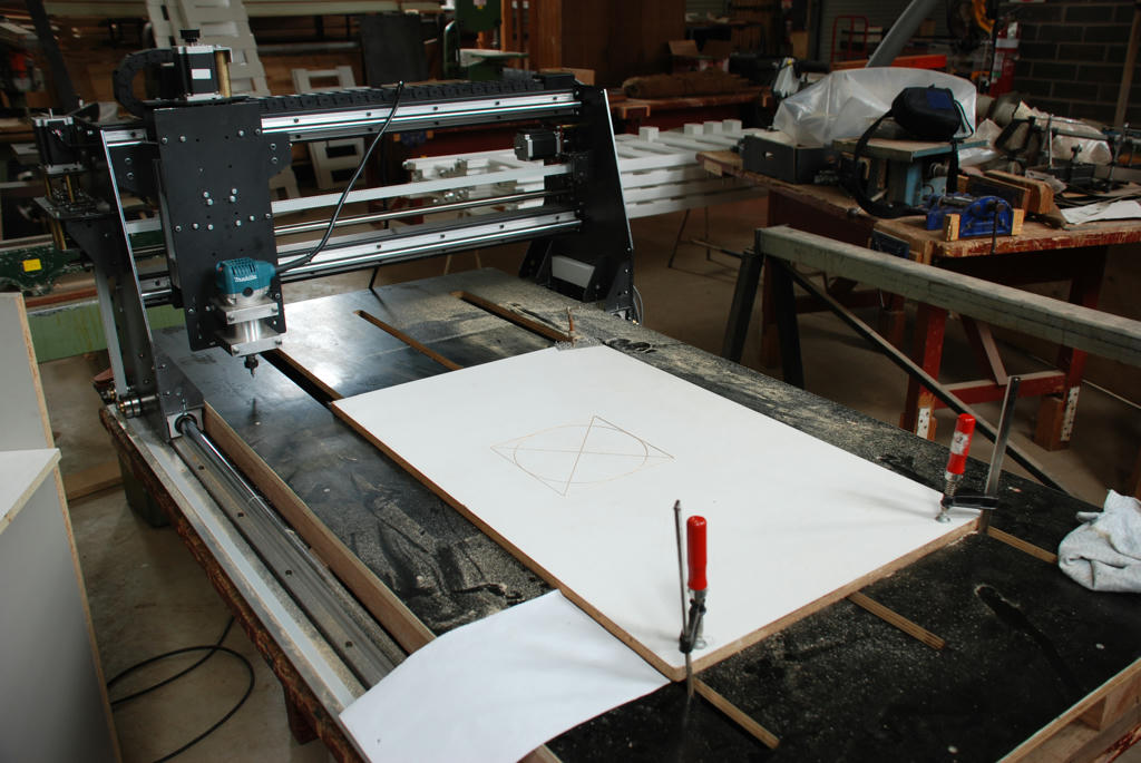

Overview (Table is temporary)

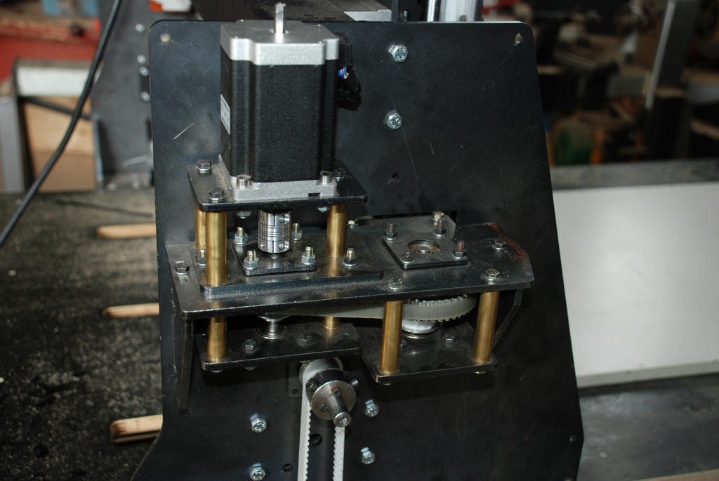

Every rotating element runs in flanged or circlip type ball bearings (clamped in laser cut holes)

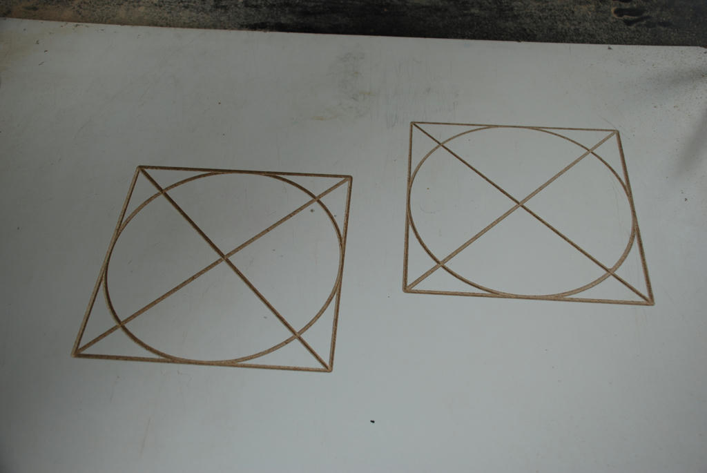

A couple of movies....
The first test 120 mb file:

Cad Design
Cut Line:

Test Pattern:

The timing belt, in this case T5, worked quite well, Care was used in setting it up to the recommended tension. Note the long axis belt sits on an aluminium support so there is no flap. the idlers are ball bearings and as stated previously all rotating elements run in ball bearings. I think this is why the results were so good. I precision bored, after clocking them in the 4 jaw, all the timing pulleys to fit their shafts so there was very little off centre run out error. By reducing the error of the various parts to a minimum the total error was greatly reduced. The synchronising shaft was also carefully turned true on each end.
Note also the way the motor is isolated and the 3:1 reduction is fully supported and tensioned (The motor assembly slides).
