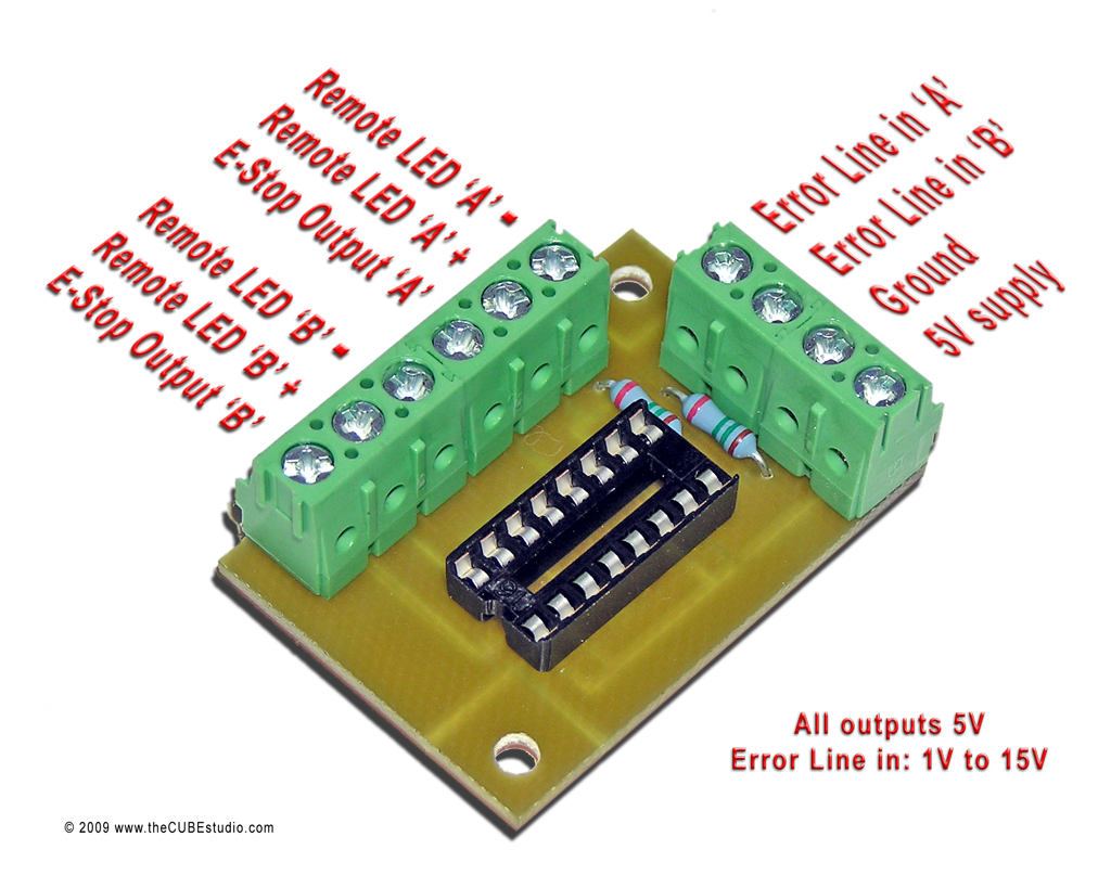

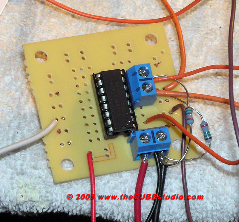

Well, wonder of wonders, here is my first circuit design and prototype electronic thingy  ;D
With guidance from tech support at CNCdrive, I was able to figure out this circuit. This was created to take care of the weak error line signal from the CDCdrives products, but it will take even a very weak signal anywhere from about 3V to 15V and put out multiple strong 5V signals to drive a remote LED and even a stubborn BOB with hungry optoisolators.
This circuit solves, for example, a specific problem discussed here not long ago. A solution to noise causing false e-stops on limit switch or other e-stop lines is to increase the voltage to 12V, however, that creates the problem of interfacing that back to the 5V BOB. This circuit solves that problem. The 12V line from the limit switch goes into the Error Line pin and the 5V out goes to the BOB.

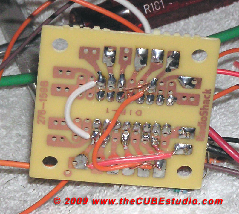

First I made a prototype with a Radio Shack proto board. Schematic has been added here - scroll down to chapter 5.5:
http://www.cncdrive.com/datasheets/Dugong_manual.pdf
This is the top and bottom of the first prototype:

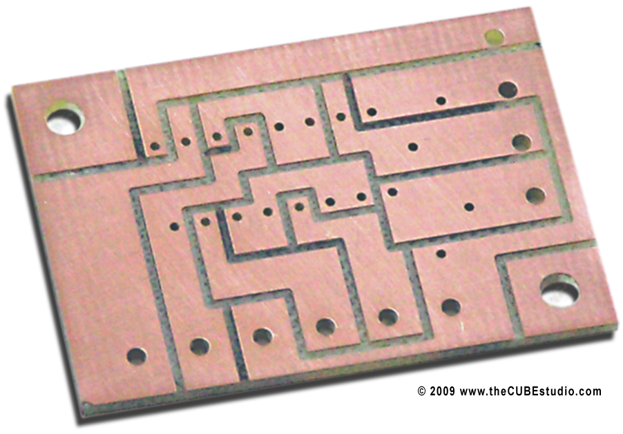

After the circuit was tested and working, I went on to design and rout a custom PC board and put it all together. I have purchased the SMD version of the chip in case a wave of motivation overtakes me (unlikely any time soon).
Here is the routed PC board:  1/32" end mill 28K rpm and 1/16" endmill at 7K RPM.
And top and bottom views of the completed part. . . less IC chip. . and prior to cleaning up the rosin:

Here is the G-code to route the board for anyone so inclined. Ignore the speed on the first two files. I used 28k RPM die grinder mounted on the mill head for the 1/32" end mill. The 1/16" end mill for the second two did run at 7K in the machine spindle (max speed), but would be better run at routing speed if you have a way to hold it.
If you want to rout and drill each size with the same endmill, you can combine the first two and the last two files.
http://thecubestudio.com/CNCdrive/ErrorLinePCBtrace.tap
http://thecubestudio.com/CNCdrive/ErrorLinePCBdrillSmall.tap
http://thecubestudio.com/CNCdrive/ErrorLinePCBdrillBig.tap
http://thecubestudio.com/CNCdrive/ErrorLinePCBCutOUT.tap
