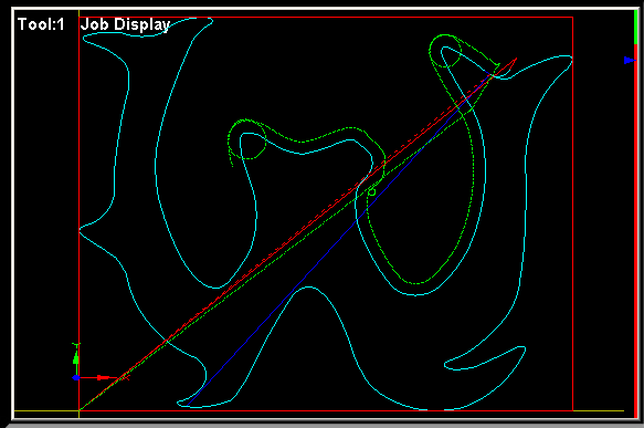

Hello,
Is this possible bug in tool compensation?
Mach3 generated full circles at some point.
Please find attached screen shot and .tap file.
Is there possibility to introduce setting when doing tool compensation to calculate best possible path for arcs, and not to stop at middle of the job saying
"tool radius not less then arc radius.."
Re: Possible Mach3 tool compensation buh
« Reply #1 on: July 19, 2006, 09:39:40 PM »
You will need to offset with Cam software :( The line secmnets are to short to use Comp on
