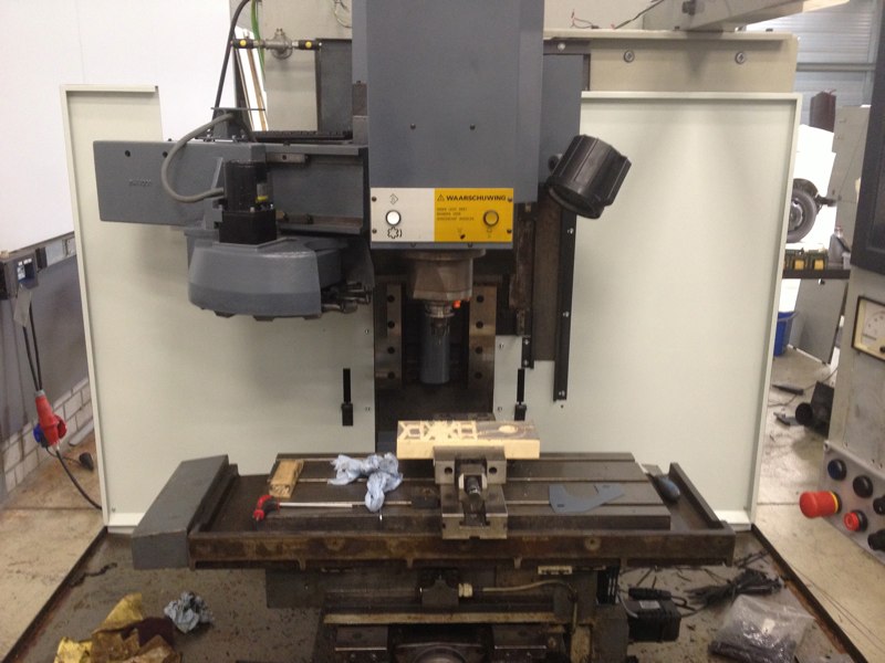

It has been a while..
Have the machine running for a couple of months now but only started to machine some more parts with it for about a month now.
Putting the machine back together took some time. Decided not to touch the outside but the inside was painted white with an industrial coating.
Here the back panel can be seen,
This is what it looks like now,
Still need to make a better arrangement for the controls and keyboard but it is functional.

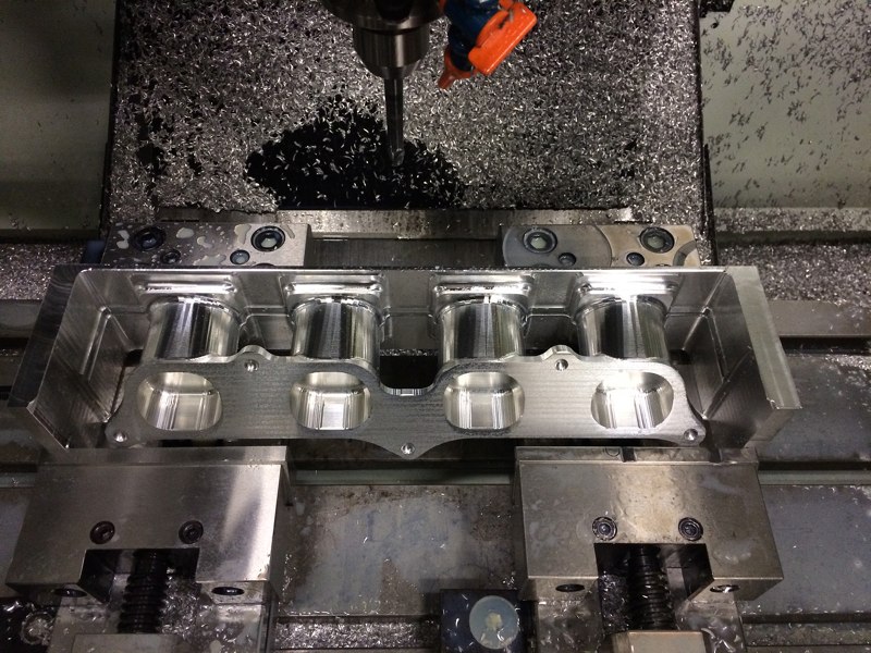

Started to make some parts,
And trying to get to know Mach3 a bit better. Making good progress IMO.
Re: 1989 Bridgeport interact 412 Mach3 conversion
« Reply #22 on: March 12, 2014, 03:11:47 AM »
Looking good and seems to be working very well, certainly a nice looking manifold you have made :)
