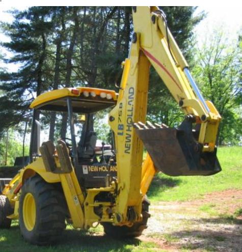

Nope, you're not going to do 213 degrees without a 4-bar linkage.  I considered that approach, but it's too difficult to design to get the desired motion.
I'm using the term 'articulated' generically. We're likely talking about the same thing; common example would be this hoe bucket. Total sweep on the swing arm is actually 250 degrees. I'm not sure if that is doable even with such a linkage. Certainly 140 degrees would be no problem. Early on I had an articulated arm design, but at that point the rotation was something like 190 degrees. Later the sweep increased to 250 degrees total, but by then I had elected to go with a motor and transmission for other reasons, so I never looked into it.

"Articulated" and "4-bar" are actually different animals.  4-bar refers to a specific type of linkage that is simple (made of, surprisingly, 4 bars each with pivots at each end, and those pivots connecting them all together.   Googling "4-bar linkage" will give you many examples.  This class of linkage, properly designed, is capable of producing nearly ANY motion profile desired.  But, as I said, the design of such a linkage for complex motion profiles can be quite difficult.  Introductory 4-bar design was the topic of an entire semester-long class when I was in college.  Obviously an articulated arm is a viable option, but an expensive one, due to the extra joints, and extra actuators/sensors required.  I ruled that approach out on mine pretty early.  I'm sure it makes good sense on yours.
