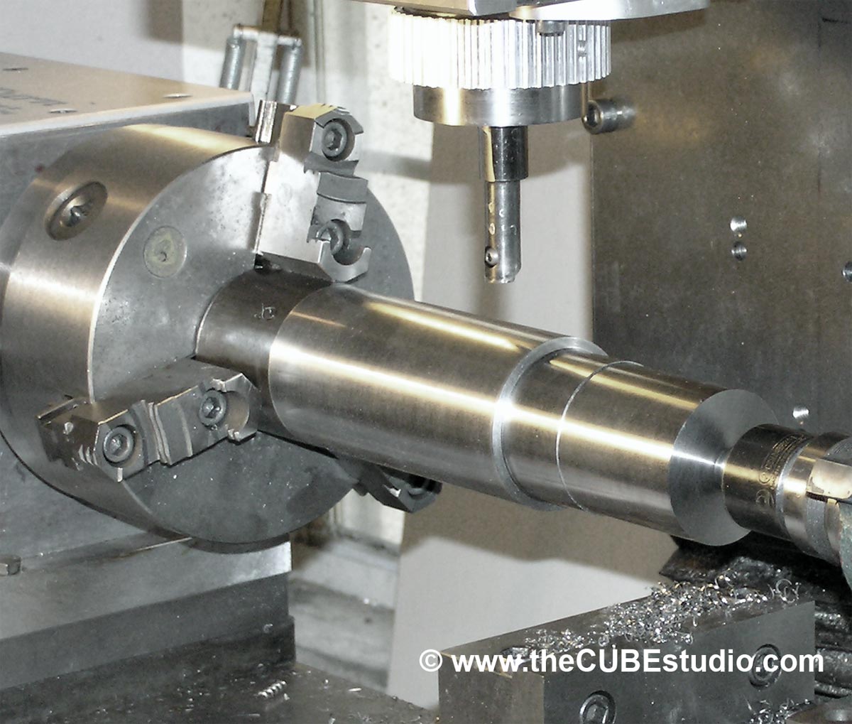

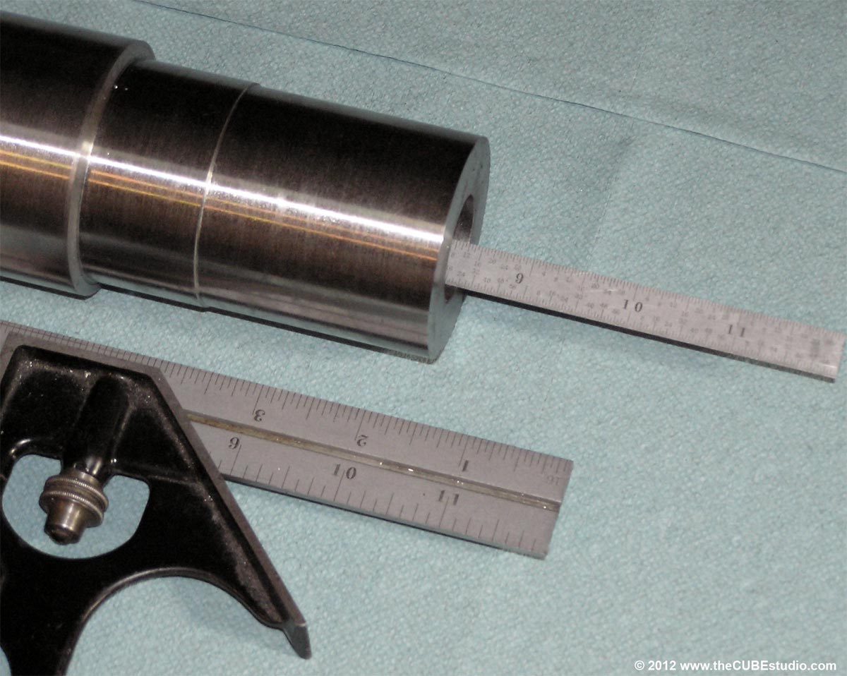

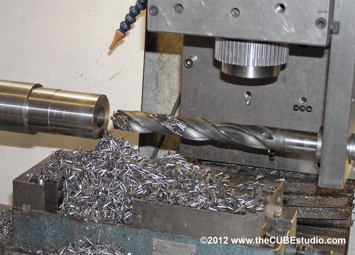

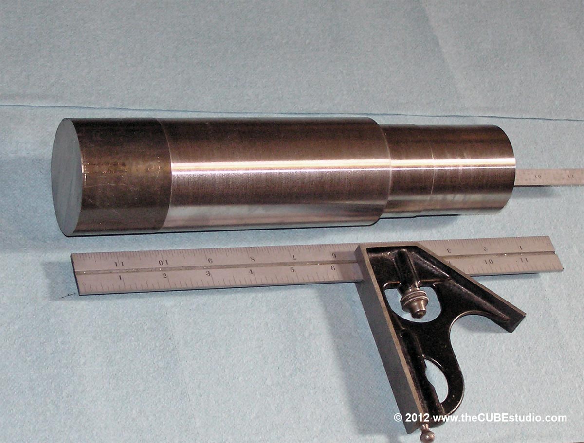

Just finished another (unrelated) project and I am back on the BT30 spindle. Carving has begun on the turkey. The part is currently flipped over and I am working on the nose, which includes the nose beargin pad, the BT30 taper and threads on the nose for a bearing retainer.  Next is another flip and a steady rest for boring the 8.5" deep hole to final size. Then grinding the bearing pads to complete. The BT30 taper will be final ground in-place on the completed spindle.
Progress photos:
Initial OD turn including body,  top bearing pad and drive end.
And now drilling hard material 1" diameter 8.5" deep. The operation stalled the previous 'Super Duty' 4th axis and it had to be done in three steps. That was one of the motivations to create the new 'Mega Duty' 4th axis. The previous 4th axis could do the job with a bigger motor, but 750watt is the largest motor Mitsu makes that runs on single phase power. The new 4th axis munched thru this operation with no problem. Coolant fed drill. No pilot hole.
