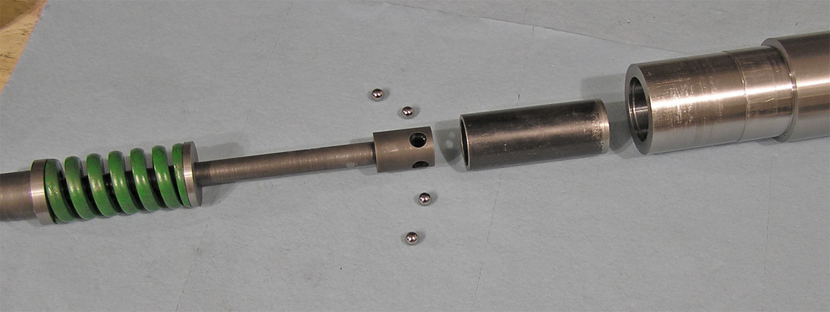

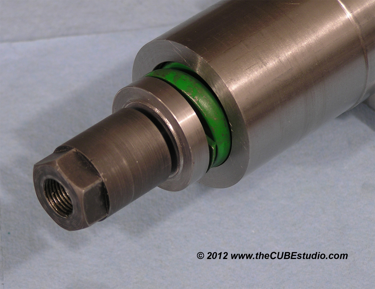

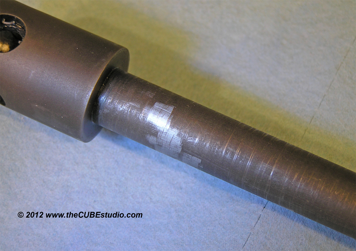

Some progress to report.
Ding, dong, the wicked Bellevilles are dead and gone. Long live the spring!
Only after scrubbing BOTH sides of each belleville by hand to create flat mating surfaces would the springs stay aligned when compressed. However, that solution created another problem by reducing the travel to barely what was needed to release the gripper. It still worked, but it would not take much variation in a stud to have a tool hang up in the spindle due to insufficient travel to fully release. Worse, even after all of that effort, the disk springs still chafed on the shaft as seen in the following photo. Using disk springs specifically made for a machine spindle or 'nesting' much thinner springs to get up to the required force might have solved these issues. Nitriding the drawbar and tube would certainly help, but my patience ran out for the whole spring stack arrangement. There may be some compelling reason to use this method in certain cases, for example, in-line nesting of coil springs increases travel, but not spring force. However, for the BT30 spec, I see no reason not to replace a troublesome $60 stack of problems with a $19 die spring and not have to deal with the the spring stack issues at all.
Jumping ahead to the completed components:
Switching over to the coil spring was relatively simple matter of cutting a pocket for the spring and making retainers and guides. The angle in the next photo is intended to show the bottom of the pocket and it makes the snap ring grove look a bit odd, but it is a simple square bottom grove. One of the unsatisfying aspects of the disc spring stack was that with no tool in place, the drawbar would extend all the way up and press against the actuator making the spindle difficult to turn (for belt changes, etc). If the spindle was started in this condition, it would damage the actuator plunger and the top of the drawbar.
In the new arrangement, a snap ring at the top of the spindle makes a positive stop for the spring when there is no tool holder in the spindle. The snap ring is on order so it is not pictured.
And here is the spring installed on the drawbar and partially inserted into the spindle. Most likely, this arrangement could be added to an existing spindle with the spring on top of the spindle. This particular spring was selected for BT30 and the rate is 2550lbs. At coil bind you have approx 2,000lbs and for a gripper with a .21" release travel, you get a max hold of about 1,450lbs. Note that this in not adequate for R8, but larger springs are available that for that application. I have the arrangement set up so that any hold tension from 600lbs to the 1,450 max is available by simply adjusting the threaded retainer cap.

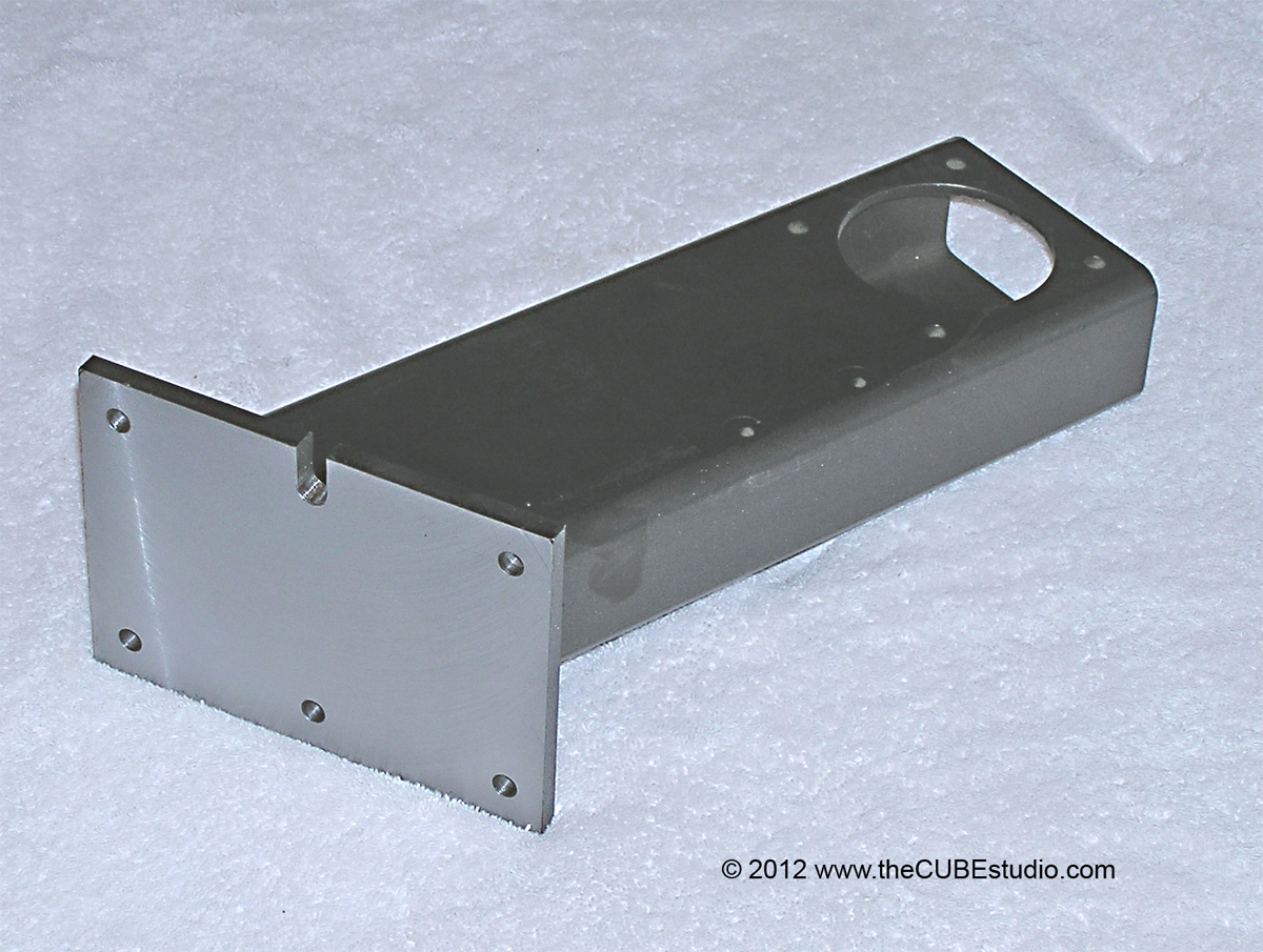

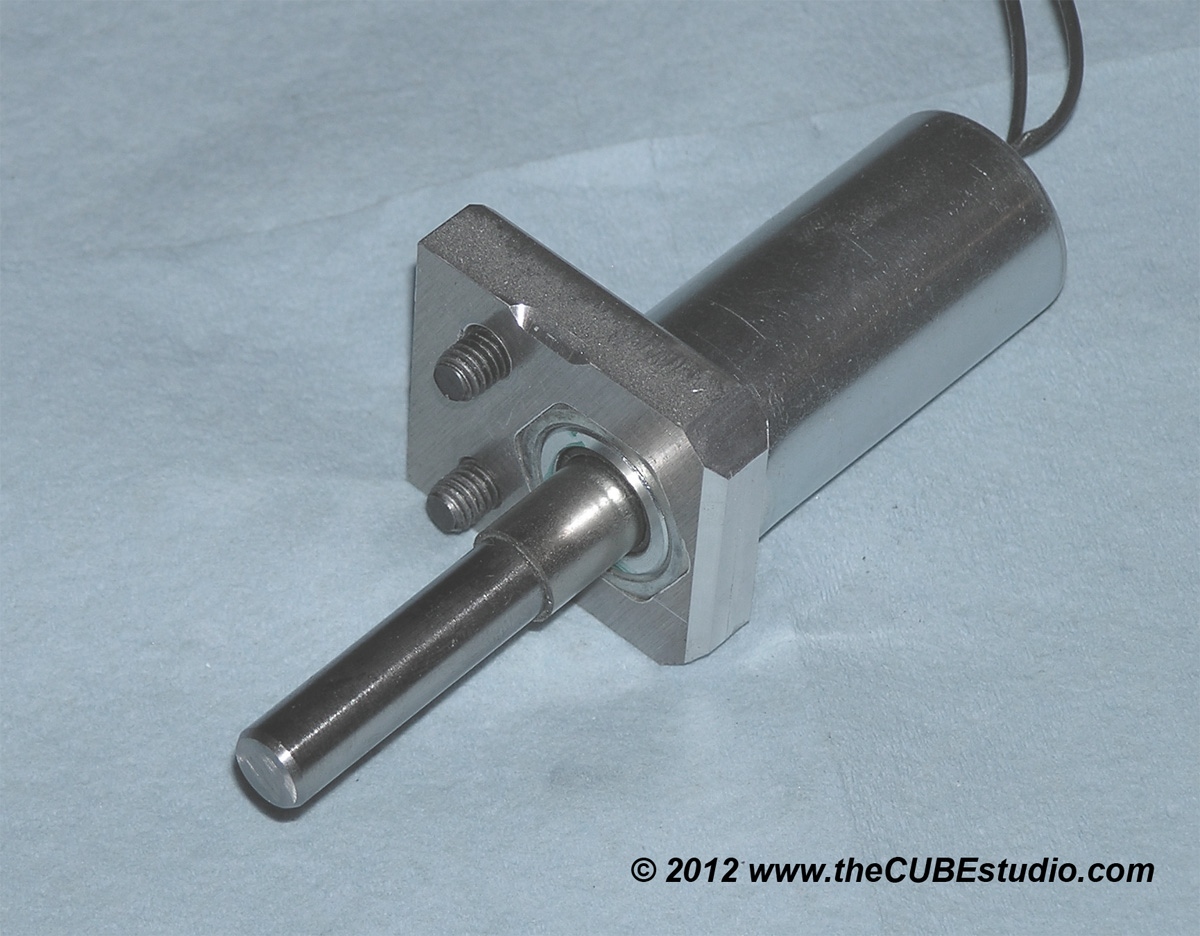

This post is just some misc stuff that has been completed for the ATC.
Following photos are of the completed carousel mounting arm. In the next few days, I hope to have this and the swing arm mounted to the side plate of the new mill head.
A previously missing detail is the safety interlock for the drawbar actuator. This little guy sports a hardened pin that runs thru a hardened die pin guide bushing and interferes with the actuator movement unless it is retracted. i.e. the drawbar actuator cannot release the tool unless this pin is first retracted. Totalling all of the special parts and the time to design and build this component adds up to a fairly expensive little gadget.  However, safety features are immune from cost cutting and/or production considerations.
