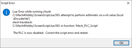

This appears to be in regards to my PLC script used to display a DRO from PMDX424 Encoder input:
Code: [Select]
local inst = mc.mcGetInstance()
local hreg = mc.mcRegGetHandle(inst, "SmartBOBUSB/EncoderDRO")
local zEncoderVal = mc.mcRegGetValueString(hreg)
local zEncoderVal = tonumber(zEncoderVal)
local zEncoderValInches = (zEncoderVal * 0.0004)
WriteRegister("Z_DRO_INCH", tostring(zEncoderValInches))

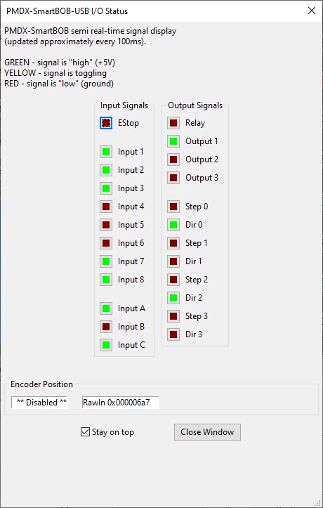

The SmartBOBUSB/EncoderDRO register value is now null.  If I look at the real time diagnostics for the PMDX424, it shows the encoder input as "Disabled":

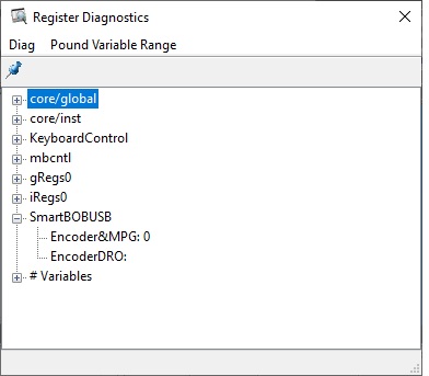

If I look at the Register diagnostics, the value for SmartBOBUSB/EncoderDRO is blank and it will not accept a manually entered value:
I can tell it's reading the encoder because the log shows signal 11 and 12 alternating to Hi/Low as it should for channel A/B of the encoder.

I am still getting the "PMDX: Encoder mode has index, cannot set Encoder Position" error whenever I move the Z axis.  I have the encoder set to just read A&B channels with no index. When I first start Mach 4, If I look at the real time IO for the PMDX424, It always says "Disabled" for the encoder position register.  If I change encoder settings, then change them back, the real time IO register view shows a count as it should.  If I exit the configuration settings and go to Mach4's Diagnostic dropdown and then select the real time IO view, it appears to count the encoder as though it's reading RPM instead of just counting?  If I go to the register diagnostics for SmartBOBUSB/EncoderDRO the value is always blank and I can never manually enter a value here.  The encoder mode error when Z is moved is persistent throughout all of this also.
Also,  I think my custom screen Lua error message is due to a null value at the SmartBOBUSB/EncoderDRO register.
