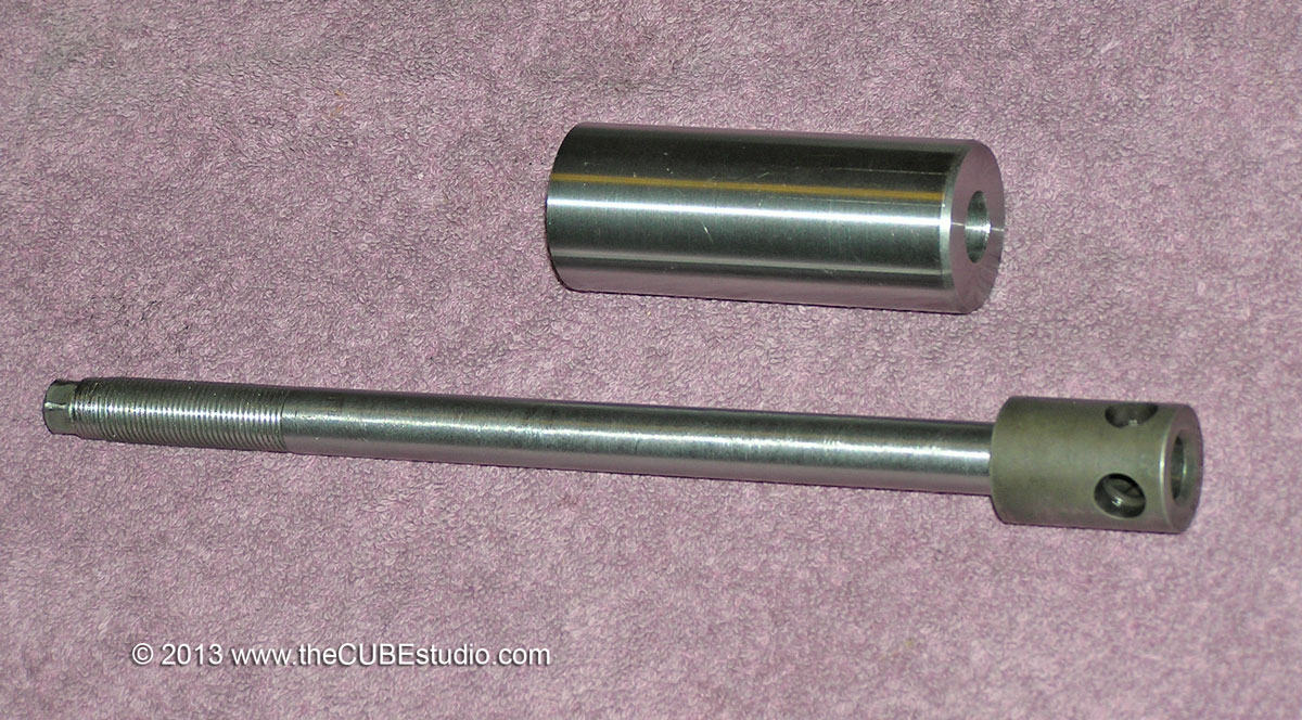

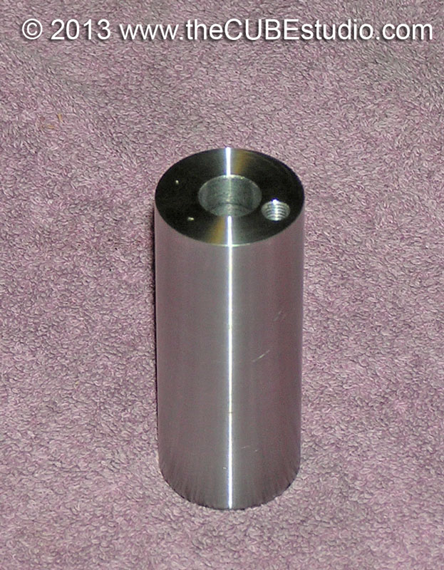

The positive upward stop on the drawbar was provided by the gripper 's ball cage contacting the bottom of the Belleville spring stack. Eliminating the bellevilles left an empty tube which allowed the ball cage to move higher in the spindle IF there was no tool holder installed (the toolholder itself is typically the drawbar's upward motion stop).
So with no toolholder in the spindle, the drawbar (which rotates with the spindle)  would be pressing against the actuator plunger (which does not rotate) with quite a lot of force. If the spindle was inadvertently started at that time . . well . . not good news.
An interlock would remove the possibility of doing damage by preventing the spindle from running with no toolholder in place . . . but there no available place to put such a sensor . . except perhaps a laser looking across the spindle nose. The solution was to take the spindle apart and replace the empty Belleville tube with a solid steel sleeve that would provide the same stop that the belleville stack was providing.
Below are shots of the sleeve and it's relationship to the drawbar. The tapped hole in the top of the sleeve is for a pull stud to get the part out of the spindle if and as needed. disassembly.
