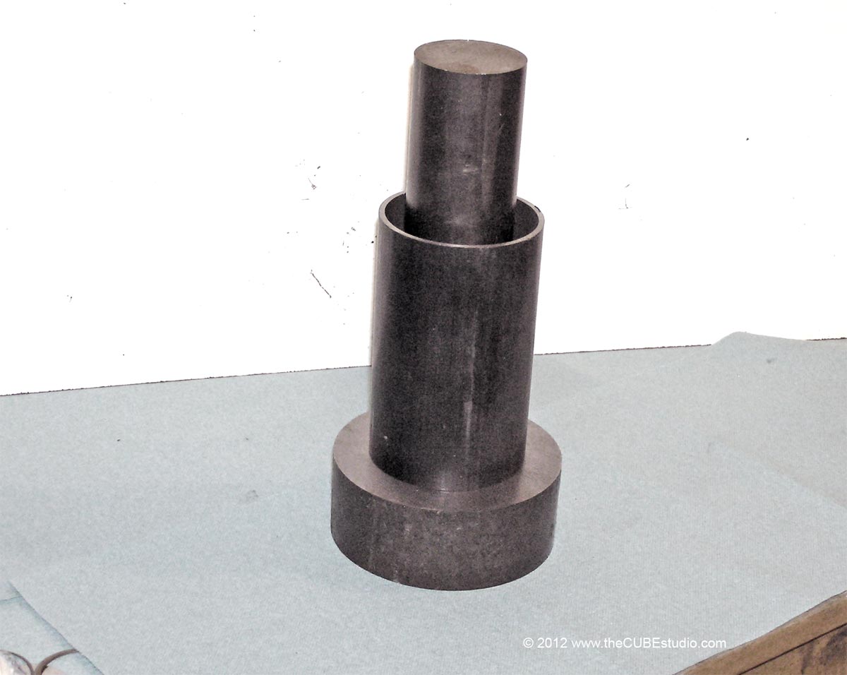

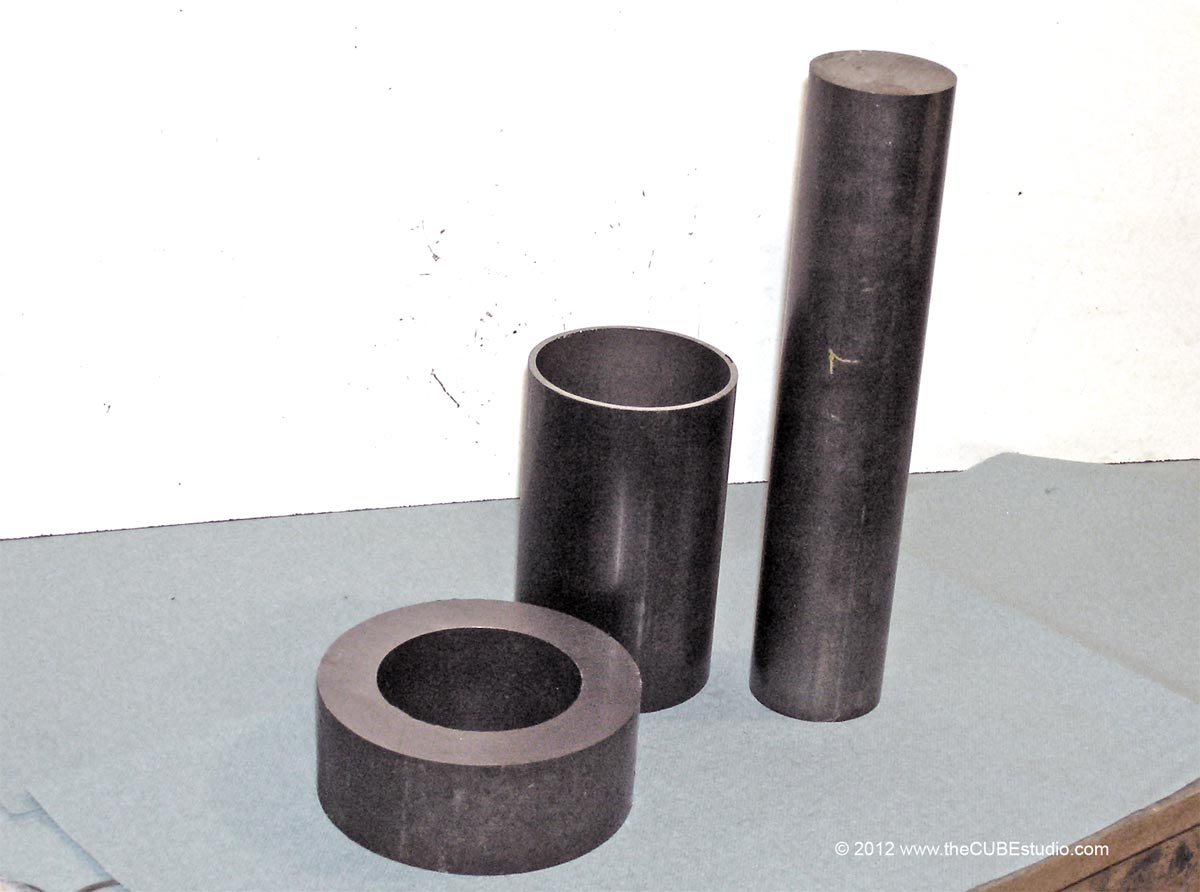

I have a tiny update and a short side trail for this thread. First the update: I have decided to go the cartridge route and make a complete housing for the spindle. This solves some problems and creates some problems. It seems DIY prefer aluminum for the housing, but I prefer steel for a number of reasons. The problem is that a chunk of steel large enough to create a flange and hold the massive lower bearing AND long enough is over US$200 and heavy as hell so shipping is also scary. IN the photo below, are the raw materials that I will be turning into a spindle. Purchasing an appropriate size piece of stock for the nose and the body of the cartridge put the cost under US$50, but it introduces the problem of attaching the two pieces together. After weighing options, I have decided to furnace braze the two pieces together. I have a furnace large enough to hold the parts and I have acquired a furnace brazing paste that contains flux and metal powder which is applied ti a specific slip fit between the parts. I am well aware of the furnace brazing process, but have never done it myself, so this will be interesting. If anyone has experience with this process, please post any tips or tricks, or specs on the slip clearance if you know what it is. I know there is a spec, but have been unable to find it so far.

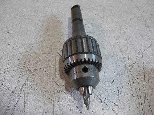

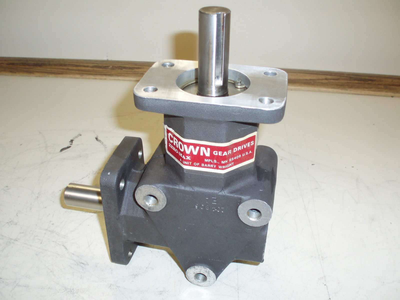

OK now for the side trail. This is related to the BT30 spindle project because the device will end up inside the head of the new mill. For now, I have built the device and it will be installed under my current mill head.
Problem: need to drill bolt patterns in parts machined on the 4th axis. Taking the parts out and drilling the bolt pattern on the mill is a PIA, especially since the 4th axis has indexing capability and can easily rotate and hold any part for drilling. The mill had revolves and can face the 4th axis, but that is more time consuming than moving the part to the mill for drilling because the head has to be re trammed each time.
Solution: horizontal drilling spindle on (for now) or in (the new mill) the mill head.
To accomplish this, you first purchase one of these  - new:

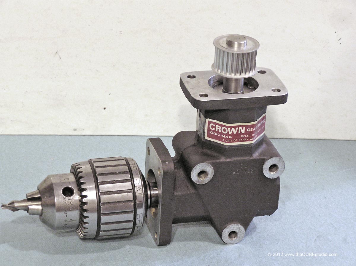

The you grab one of these off Ebay for something less than the new price of US$285 plus something like $80 for the MT adapter. The chuck is the largest Jacobs 'Super Chuck' with capacity to 3/4". The huge MT adapter was trashed and unusable, but for my purposes, it was perfect because it was big enough to cut down to 20mm.

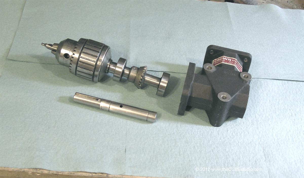

Next you reduce the diameter of the MT adapter to a 20mm press fit and duplicate the snap ring grooves and pin holes of the original shaft.
Move the bearings and gear over to the new shaft:
Rig a method to preload the bearings and reassemble. Now you have a horizontal drilling capability that can hold tools up to 3/4" and can drill and hard tap a workpiece held in the 4th axis. ONe of the first uses will be making the BT30 spindle housing.
